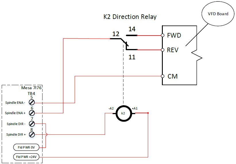

Unfortunately the 7I76 spindle interface only supports ENA/DIR type control inputs.
Many drives have this option but it appears that your drive does not.
It may be the the easiest way to control the VFD with minimum added hardware
would be to add a SPDT relay driven by the direction signal:
ENA- ---> GND
ENA+ ---> RELAY COM
RELAY NO ---> FWD
RELAY NC ---> REV
RELAY COIL+ ---> +24V
RELAY COIL- ---> DIR+
DIR- ---> GND
Do I read this as the ENA+ 24v from field power being the source that is passed to the VFD via the relay's NC and NC contacts?
I just want to be sure I have it right and don't smoke anything when it gets it's first power.
-Mike

I have a feeling that, in your scheme, ENA- should go to CM not GND.

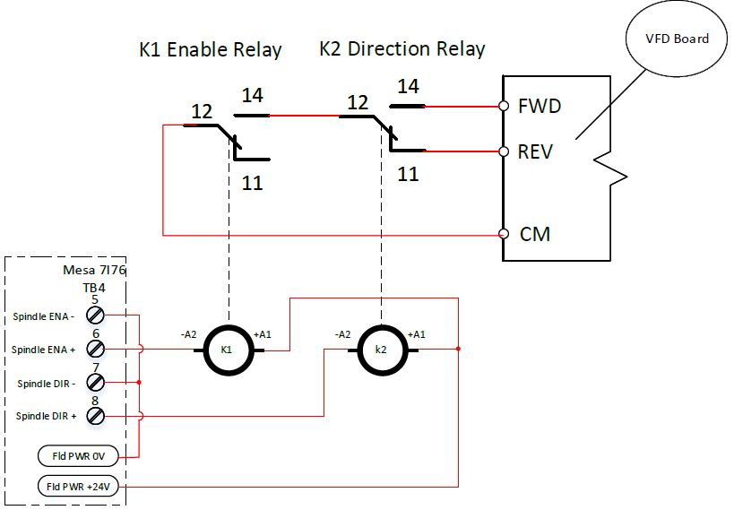

You need two relays, one relay for forward action and the second relay for reverse. one relay for 'enable' second for direction See attached revised diagram to help you wire this part of you project./

I think that his scheme with one relay will work.
His plan seems to be to use the 7i76 "enable" to turn on forward or reverse, and uses the relay to select which terminals the "enable" output is connected to.
However, it is probably worth testing to see what the drive does if both FWD and REV connections are made at the same time. If this results in reverse running, then no relay will be needed.

OK, I've made progress. All the axes move. The TB4 analog output seems to be working M3 S2000 gives me 10.13V and M3 S1000 gives me 5.04V. I still can't get the spindle to turn on.
I have it wired as mentioned above.
Here are the the voltages I'm seeing:
State
Pin Off M3 M4
+A1 28.42 28.17 28.11 Coil Pos
-A2 28.09 27.84 27.81 Coil Neg
11 0.011 0.013 27.44 Relay COM
12 0.014 0.016 27.43 Relay NC
14 0.014 0.016 27.42 Relay NO
Interestingly, the VFD responds with a frequency displayed on it's front panel only with the M4 command. Close, but no cigar.
Any ideas on where to go from here?

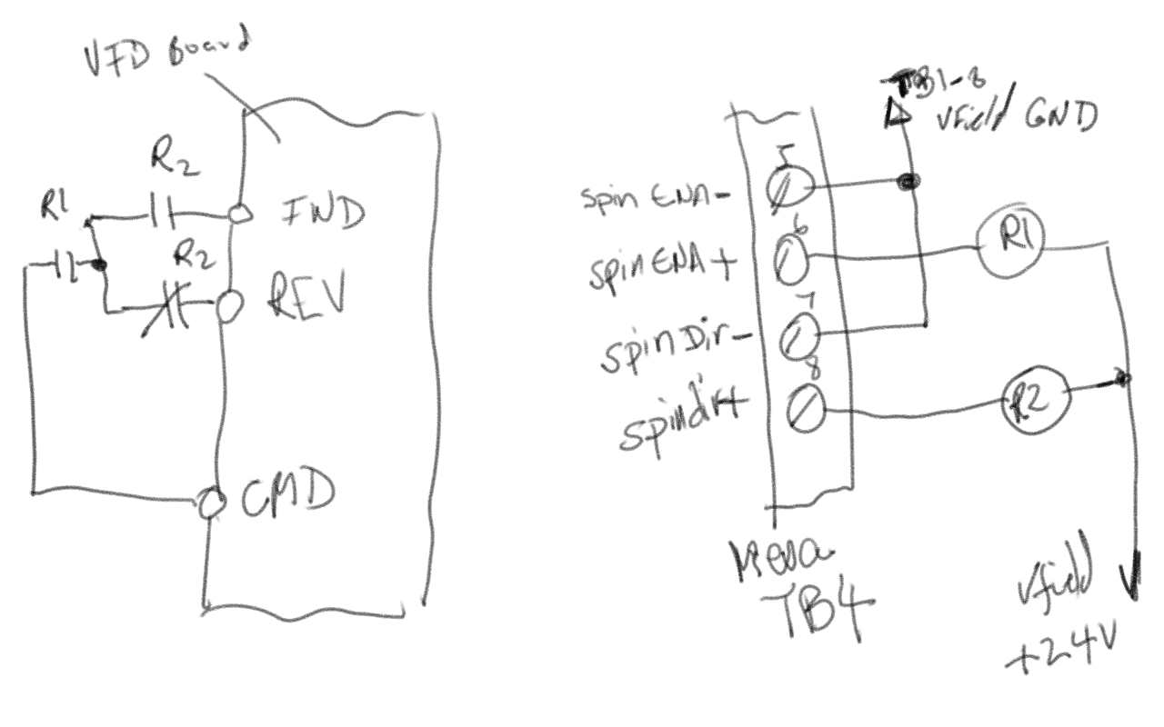

Here are two solutions in schematic format (see attached), the one relay solution is the solution that was suggested in the previous replies..
The one relay solution is simple, sweet and the list costly but if something goes wrong with the VDF you might end up damaging your mesa card. The two relays solution keeps Mesa and the VDF power supplies separated so one misshape with one card will not affect the other, the LED's in the relays will help you with troubleshooting in the future and if enable works backward you can reverse the logic.
So now you have worded solutions by previous members that replied to your inquiry and visual solution.

Many thanks to all who replied. My additional relays arrived, and I went with the two relay solution keeping the VFD and 7i76 voltages separated. I now have the rest of the machine to sort out.
