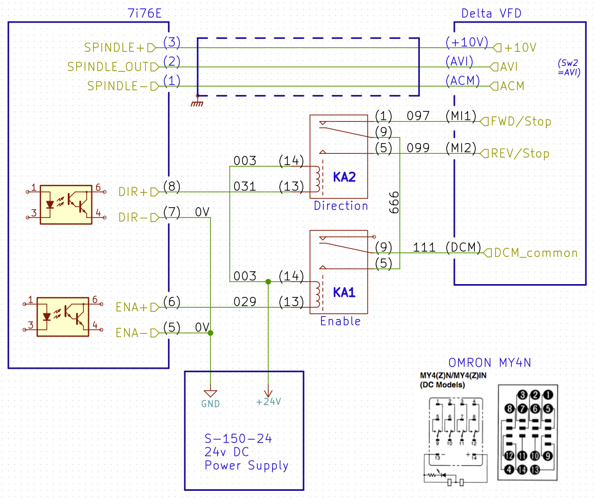

16 Mar 2017 16:46 #89753
by Lcvette
Replied by Lcvette on topic Mesa 5i25 & 7i76 to GE Af-300 VFD?
Did you ever get this figured out? I'm getting ready to write mine up and have been researching for a solution, think I found a good reference from a fellow boarder, below is the explanation in a wiring diagram. Looks as if it's creating a safety circuit using the enable and direction outputs and two relays.

16 Mar 2017 19:32 #89776
Replied by andypugh on topic Mesa 5i25 & 7i76 to GE Af-300 VFD?
It's not a safety circuit as such, that is how to control a VFD with separate FWD and REV inputs with the 7i776 (Which has ON and DIR) outputs.

16 Mar 2017 19:50 #89778
Replied by PCW on topic Mesa 5i25 & 7i76 to GE Af-300 VFD?
A couple things:
Flyback diodes are required across the relay coils (diode cathode to +24V side of coil)
Also you really don't need 2 relays since the ENA OPTO can function as KA1s contacts

16 Mar 2017 22:01 #89783
by Lcvette
A couple things:
Also you really don't need 2 relays since the ENA OPTO can function as KA1s contacts[/quot
I'm not an EE, and would have never known that, could you possibly elaborate maybe sketch on the picture to better illustrate what your stating. Curious about a single Relay as well instead of using two. Would be greatly appreciated!
And is there a matter schematic somewhere that has all of these tidbits of information so it isn't over looked? And now I'm nervous I'm missing other stuff that may b cause issues... Crums!
Thanks,
Chris
