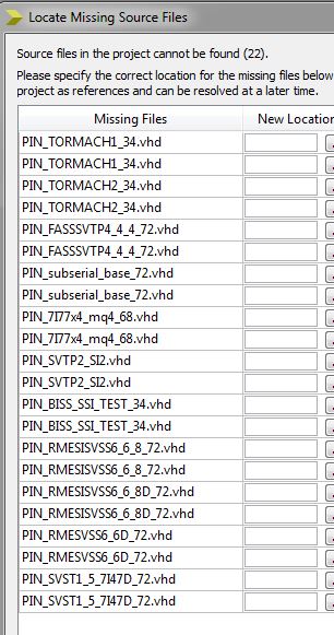

I'm trying to load the seveni80hd.xise so I can modify the card to my needs but ISE is complaining on start that bunch of files are missing
PIN_TORMACH1_34.vhd
PIN_TORMACH2_34.vhd
PIN_FASSSVTP4_4_72.vhd
PIN_subserial_base_72.vhd
Anyone have a clue where to get them?
08 May 2017 15:23 #92826 by PCW
Replied by PCW on topic 7I80HD-25 - missing files (PIN_*.vhd)
Just have the project manager delete the unused files from the project
None of those are needed
