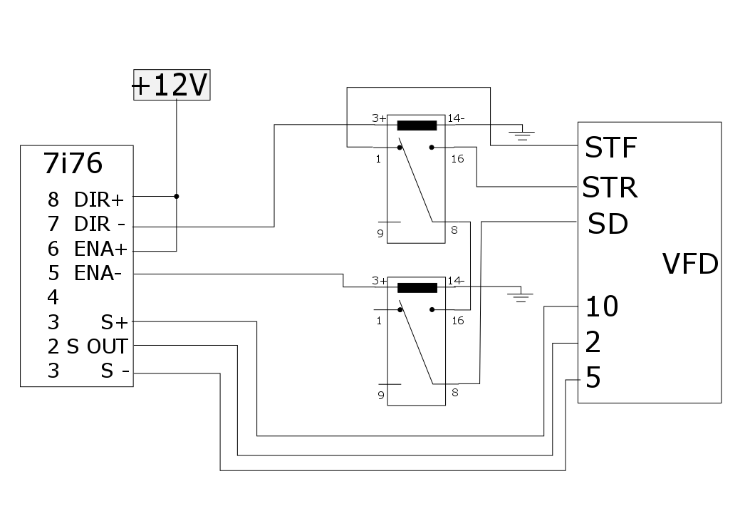

Thanks, will make a PCB layout or just make one on a lab-pcb.

23 Jun 2017 12:54 #94835
Replied by andypugh on topic 7i76E to VFD
How different in layout is the existing PCB? Perhaps you can just jumper / cut some tracks?

23 Jun 2017 12:55 #94836
by tecno
Replied by tecno on topic 7i76E to VFD
Have to get the board up and have a look, probably easy modification to do.

23 Jun 2017 14:40 #94844
by tecno
Fairly easy modification, above is how the board is now.

23 Jun 2017 15:09 #94847
I showed the relay coils high-side switched, but low-side switched like you have will work fine, so that bit can stay the same. (you need to switch polarity of the Mesa output, is all)
A bit of cutting and jumpering looks necessary on the relay contacts.

23 Jun 2017 15:14 #94848
by tecno
I was going to do like this, should be OK?
- Posts: 19902
23 Jun 2017 15:17 #94849
Should be, if the relays work reliably at 10V.

23 Jun 2017 15:20 #94850
by tecno
Will do a test again, if I recall it right they did.

23 Jun 2017 15:36 - 23 Jun 2017 16:07 #94852
by tecno
No problems at 10V so I hope 10E output is somewhat near that, but they work on the bench at about 8V.
Also well within 10E permissible load of 10mA on the VFD
