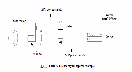

I assume to take a suitable output to control the brake and some magic in hal to to the job.
My only concern is that whenever Z axis servodrive is not enabled/powered the brake must be out of power.
Running gcode always on until end of file and put the brake on and in manual jogging on/off asneed be.
No action = brake on
No power = brake on
Have had a few runaways so I do not want to see that happend again.
Cheers
Bengt

Bengt, this is not a 7i76e problem but a Linuxcnc problem. Normally I go looking in halui, motion and iocontrol and look at signals that might do the trick. Just google "linuxcnc halui man"
Anyway, I think this thread will help
forum.linuxcnc.org/38-general-linuxcnc-questions/30295-brakes
If your brake can be controlled by your servo drive then this might be useful
forum.linuxcnc.org/24-hal-components/316...achine-on-off-button

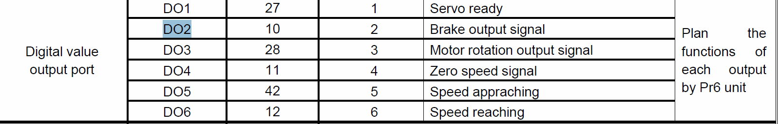

Hi Rod,
Yes there is a brake out on driver BUT the behaviour is not OK as it is like playing FLIPPER with brake going on/off all the time.
This is what I want to avoid.
Cheers
