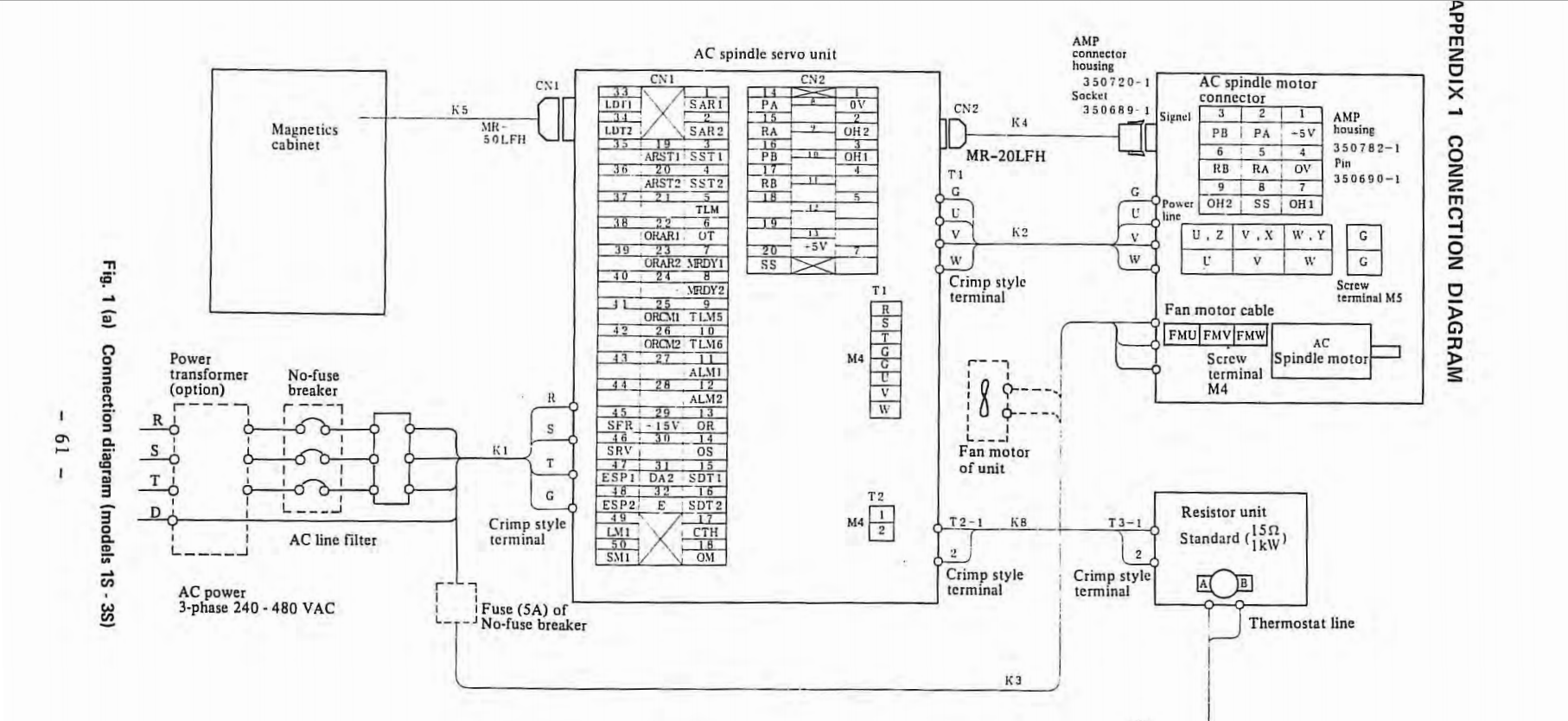

19 Aug 2017 19:40 #97752
by ligthmare
Replied by ligthmare on topic Fanuc and 5i25/7i77 couple
Thanks you it's works!! the probleme was from 2 wire in a cable for the X axis.
My motor move!!
But...during testing , one moto arrived on the end of the way and I have broken some transistor on the PCB I must to replace there . I have not 16000000 puls/rev but 2500 I was wrong . Its very complicated to mesure how many pulse I need to put in the case in the PNCconf for finaly have a correct scale. (I can't see inside the machine to see the leadsrew and pulley)
So, waiting the new transistor , I'm cheking about the spindle, and for taht I'm totaly lost.. On the 7i77 I have only 4 wire to drive the spindle ? the same as the axis?
Because on the cable ( CN1) between the 7i77 and the PCB its seems have a lot of information , and I do not understand the documetation.
What is the magnetic cabinet?
the documention , my unit is : a06b-6059-h002 cncmanual.com/fanuc-ac-spindle-servo-uni...nce-manual-65015e-2/
My motor move!!
