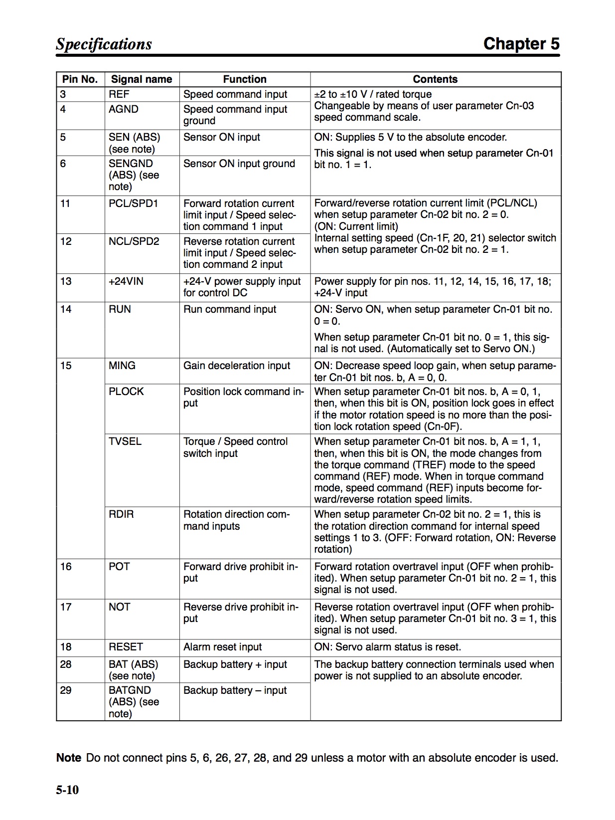

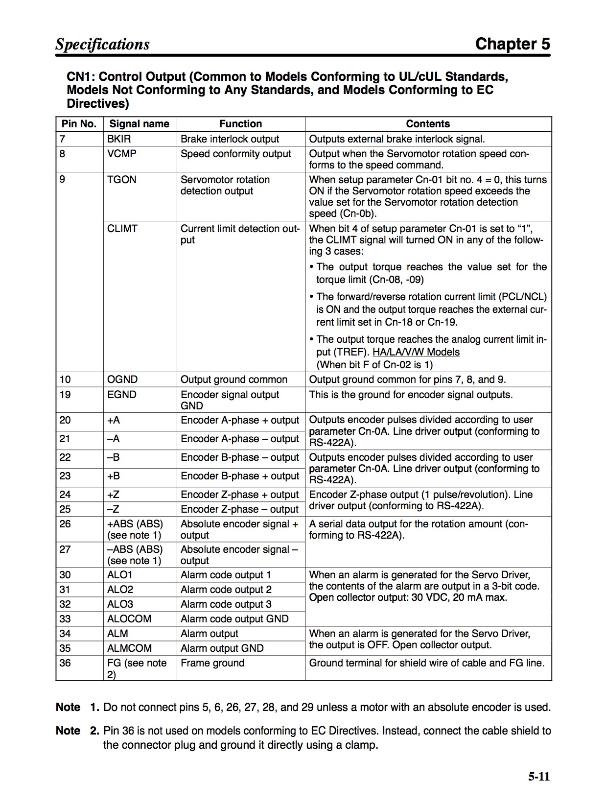

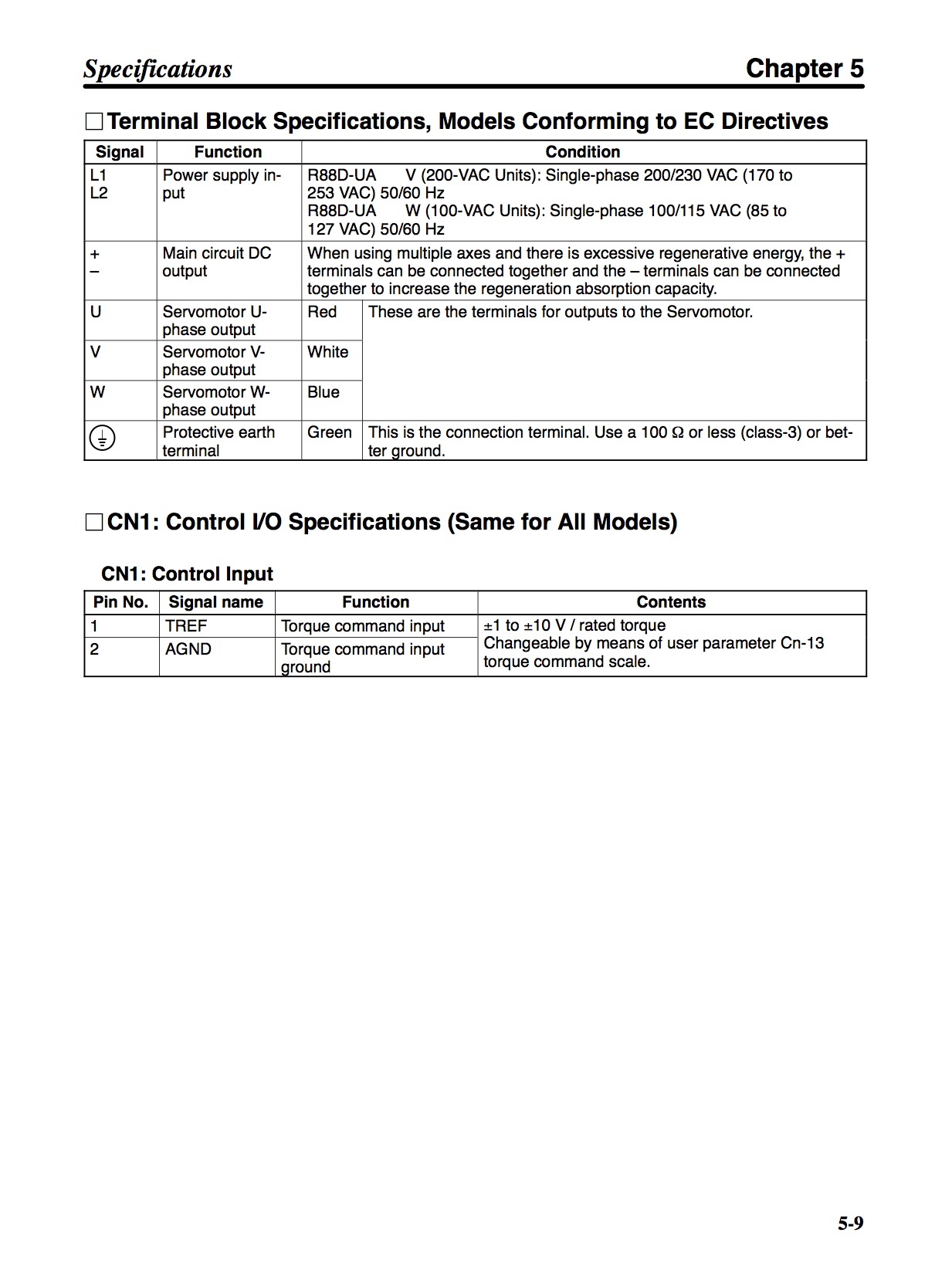

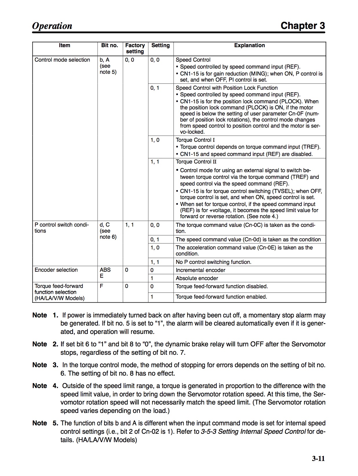

- Agathon
- Posts: 18
10 Aug 2017 17:42 #97308
by Agathon
Replied by Agathon on topic Driving analogue servos
Many thanks Jon for your succinct explanation. My drives do indeed take the encoder signals in and then provide outputs to a controller. So would I need anything else to go with the PPMC board or does it act like a BOB and connect directly to the PC?
Attached are a few pages from the manual which I thought might be illuminating. I have uploaded the whole thing here - Omron R88D-UA manual
Many thanks David
Many thanks David

- jmelson
- Posts: 520
- Thank you received: 126
10 Aug 2017 17:47 #97310
by jmelson
Replied by jmelson on topic Driving analogue servos
Well, possibly a few solid state relays and cable might be all you'd need to add. Speed command input in on CN1-3 and 4. CN1 pin 14 may get 24 V DC to enable the drive (RUN mode). This can be set up with a solid state relay in the DIO board. Check additional info for the correct voltages here. CN1 34 and 35 are the alarm outputs, there should be more info on how this is set up. If a floating optocoupler output, it can just be tied in series with the E-stop chain.
Jon
