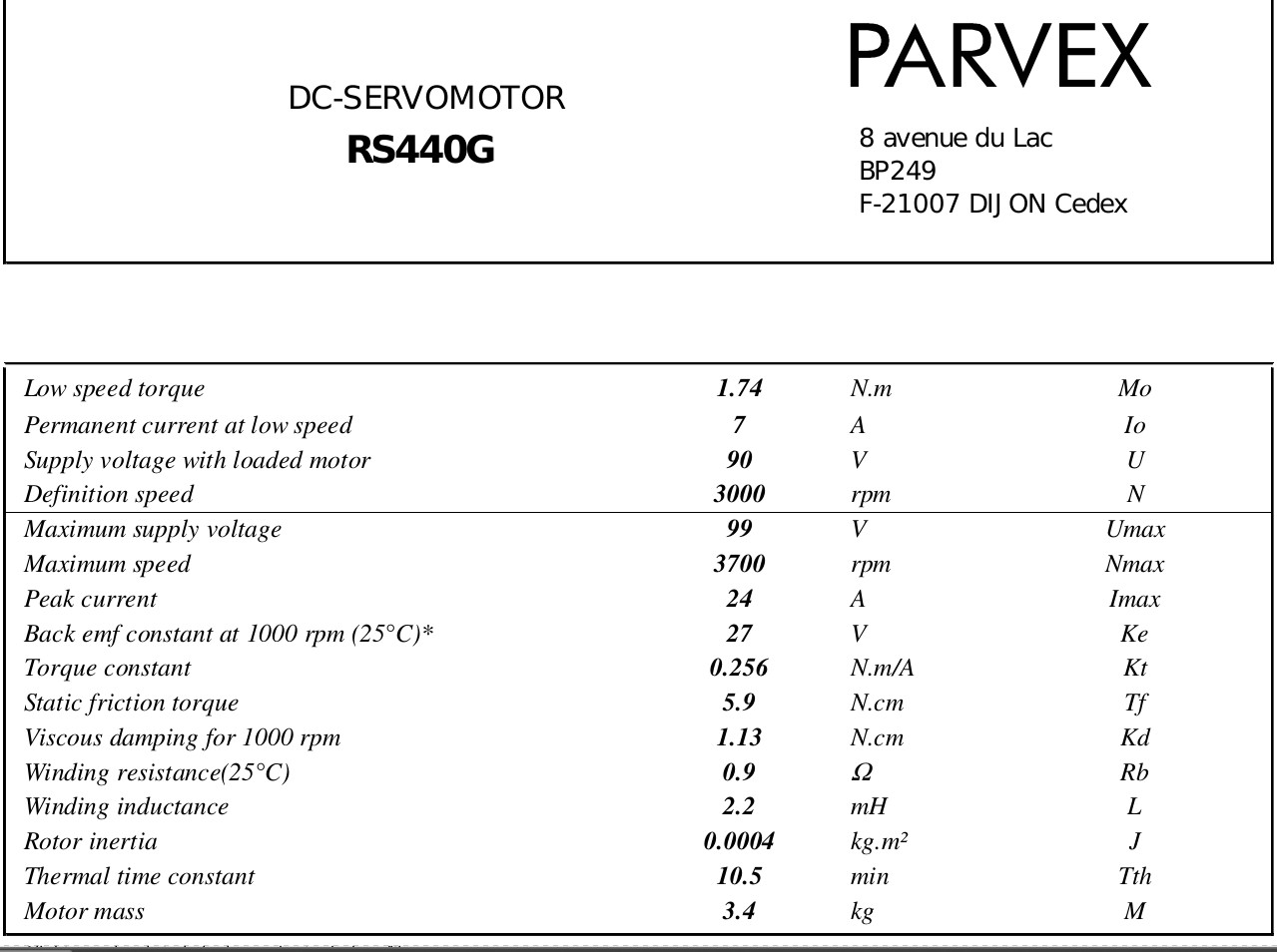

i have already tried two 200 w motors and they go very well for y and z axis, now i have a doubt about the x motor ... i'm afraid it's too big 90 volt 7 amps.
however it is going with the servodrive I have now, 75 volt power supply
if I leave current limitation 5 amps I can use it?
it does not need much power, I used that because I had it and it has a 14 mm shaft
I attach the motor data
