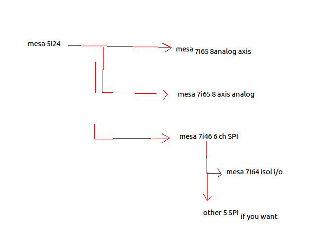

I plan to use more than 8 axis so I suppose these config:
mesa 5i24 connected to: 2 mesa 7I65 + 1 mesa 7i46 .... to mesa 7i46 connect 1 or 6 mesa 7i64 (isol i/o). (see attach schemas).
All these board (exept 5i24) uses 5V power input ... I connect these to an external power unit ...
question 1) how many watt can absorbe these config?
question 2) is right these config or there are something of wrong?.
Regards
giorgio

I don't think so, for connecting Mesa smart serial cards like a 7i64 you want one of the rs422 cards like a
7i44

How many axis?
A FPGA card --> 2 or 3 7I52 > 2 or 3 7I83s is probably cheaper and easier to setup (18 axis max)
for example:
5I24 (or 7I80HD for Ethernet) + 2x 7I52 + 2x 7I83 gives you:
12 encoder inputs, 12 analog outputs, 12 analog output drive enables, 10 free serial ports for I/O expansion
5I24 (or 7I80) + 3x 7i52 +3x 7I83 gives you
18 encoder inputs, 18 analog outputs, 18 analog output drive enables, 15 free serial ports for I/O expansion
5I24 (or 7I80) + 2x 7i53 + 1x 7I52 + 5x 7I83 gives you
30 encoder inputs, 30 analog outputs, 30 analog output drive enables, 5 free serial ports for I/O expansion

the targhet is 16 axis analog drive servo AC (enable i/o + analog + encoder) + some i/o digital and after these 1th machine test i plan to add other 16 encoder input as redundancy encoder feedback. But more probabily i stop the work at 1th step so only 16 axis + digital i/o (i think at 16+16 io).
I think is nice have the enable signal in the same board of analogue and encoder signal ... for these reason i see 7i65 ... but i control it price only after read PCW reply.
using 3 x 7i77 is too expensive and I get too many digital i/o I do not need ... I think it's a waste
So the best config for these pourpose (performances/prices) that you can suggest is?
regards
Giorgio

I think the cheapest is
7I80HD FPGA card --> 7I53 + 7I52 --> 3x 7I83 (plus 7I84 for I/O)
= 18 analog channels, 18 enables, 18 encoder inputs, 16 digital outputs, 32 digital inputs
(4 free sserial channels available for I/O expansion)
You might be able to use a 7I93 instead of a 7I80HD but I'm not sure all those encoder would fit
in the 7I93s smaller FPGA
