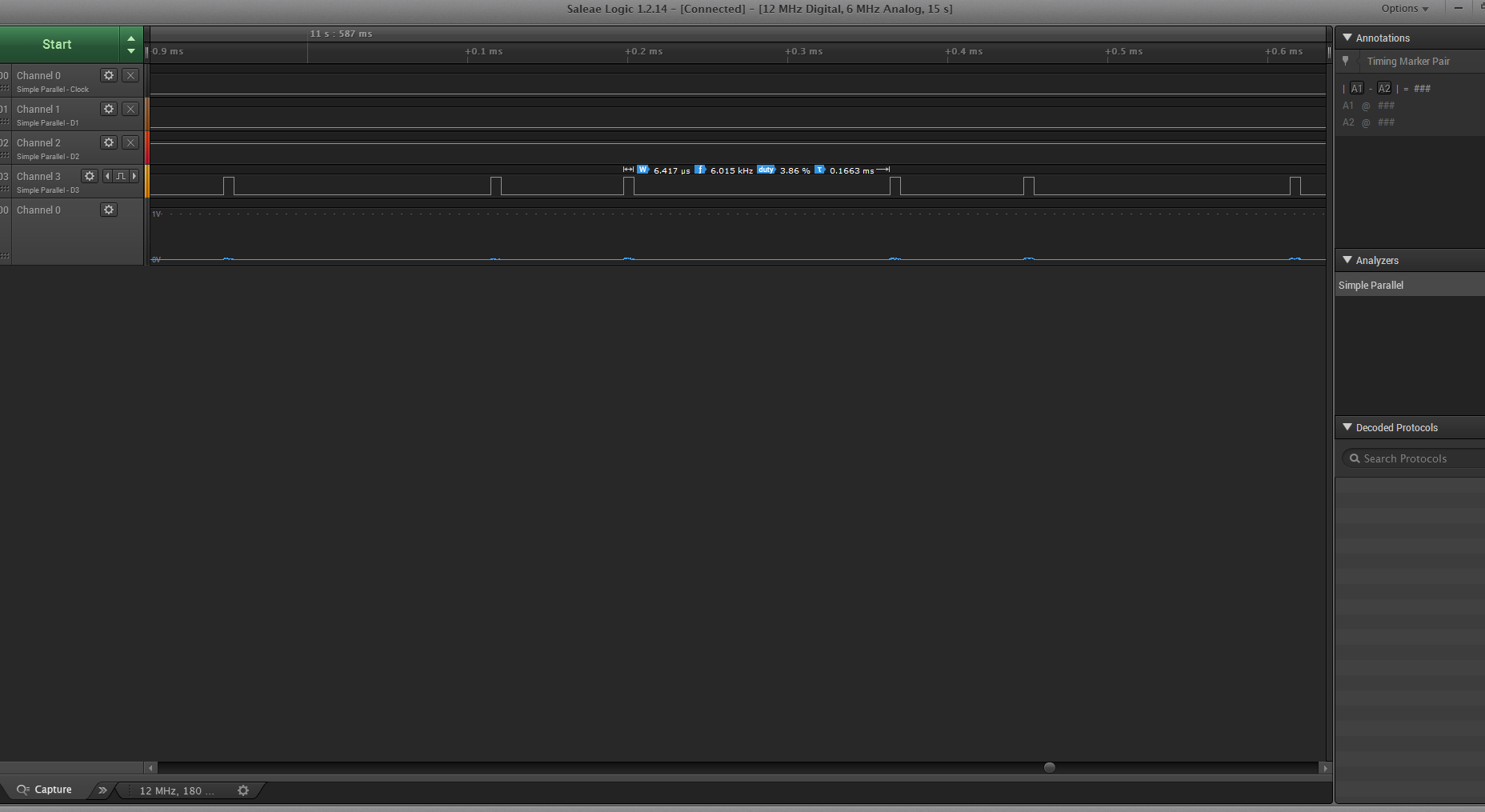

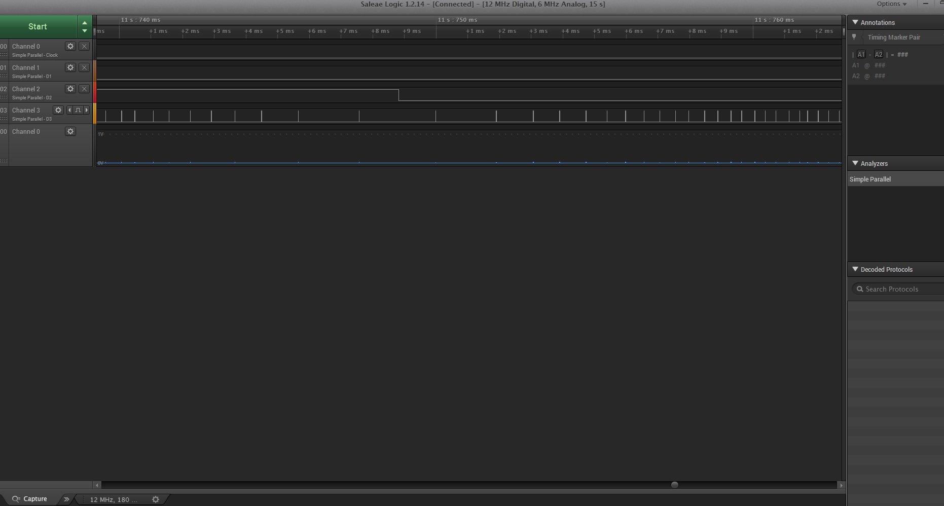

hi,
I took the same measurements with Saleae logic analyzer.
So when i make a run in the test box. I get following results. Channel 2 is my step dir. On one pictures you see there the drop in voltage.
I am just wondering if the voltage pulses are strong enough to be measured by the drivers.
Please any advice if this is sufficient would be helpful. Can i use direct parallel port or do i need a breakout board to enhance the pulses?

A buffered breakout board has been previously mentioned as well as configuring the parallel port for single direction rather than bi direction. A breakout board purchased from a specialist supplier will provide information on connecting their boards up. Usually drawing drawing more than 2.5ma from a PP pin will cause issues.
Pictures are not as useful as a schematic.
It gets frustrating to repeat advice that has already been given.

The pictures I showed are the results from a logic analyzer on my own PP.
I have a breakout board coming in tomorrow, aswell as tb6600 drivers I will connect to that and see what happens.

05 Oct 2017 23:14 #99974
Replied by andypugh on topic Easydriver how to get it to work?
Many p-ports are 3.3V but 5V safe. The way to use them is in current-sinking mode. (also most can sing 15mA but might only source 3mA per pin).
The inputs to most stepper drivers are now opto-isolators, so you wire the +ve of the input opto to +5V (often from the PC USB socket) and then wire the -ve side of the opto to the parport.
You then need to inver the sense of the p-port pin in HAL so that 0V ( = current flow from 5V through opto to parport to gnd) is Step and 3,3V (= high impedance, no current flow) = space.
