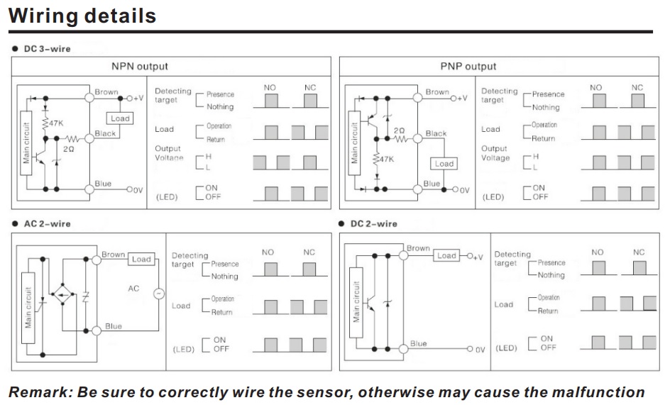

Hello all I am in the final wiring phases of my VMC Retrofit and have a quick question regarding home and limit switches.
I have on hand a set to install which are:
Proximity type sensors, model SN04-N2: DC 10-30V, NPN NC, Three wire
but there are other type to use if the wiring setup is incorrect. I do know I want to use a normally closed switch based on searches and safety in the event a line breaks etc.. but I am a bit unsure on the type for correctly wiring to the 7i77 .. this has always been confusing to me and any assistance is greatly appreciated!.
Below are some attachment images with the types and their schematics. any help appreciated!
Chris

Replied by PCW on topic limit and home switche question for Mesa 7i77
The 7I77 has active high inputs so works directly with PNP type sensors
Ideally PNP NC sensors should be used for limit switches since a broken
power or signal wire will cause a fault.
NPN sensors can be used but require a 1-2 k pullup resistor to +24V

Thank you PCW!! I was thinking the same thing, I appreciate the confirmation!! time to order some new switches!! :/ lol
