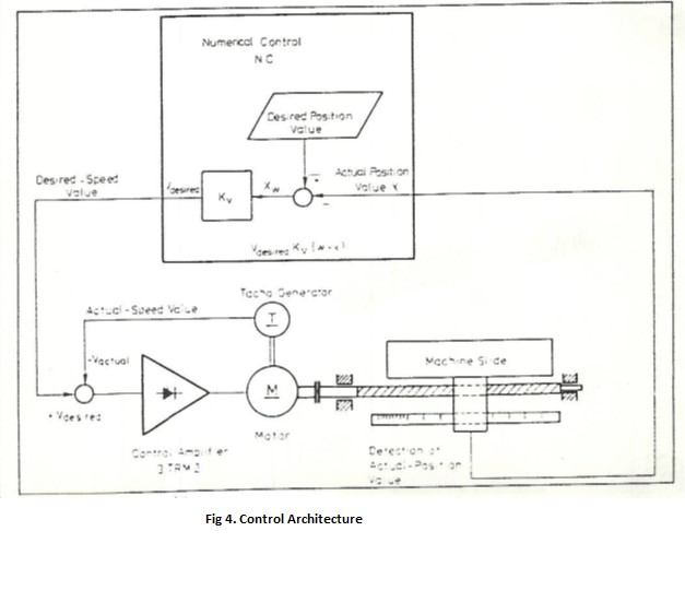

Hi, I am just wondering if a MESA board with LinuxCNC can effectively do what the Galil boards do which feature - "Dual-loop
The dual-loop (DV) feature enables the controller to compensate for mechanical backlash. Typically, dual-loop systems use a rotary encoder on the motor and a linear encoder on the load (Galil controllers accept inputs from two encoders per axis as a standard feature). Dual-loop control changes the standard PID control and closes the position loop with the load encoder (“PI”) and derives the damping terms (“D”) from the motor encoder. This method provides smooth and accurate control along the motion path regardless of backlash.". This is commonly referred to as something else? My searches didn't yield a lot.
I am considering CNC'ing my bench top mill (RF-45 clone) and I am just trying to price options before I dive into purchasing and much more research / reading. Ideally I would like to CNC it in this manner with hybrid steppers (good price point). Is this possible?
The backlash compensation seems like a smart move compared to very expensive ball screws.
If anybody could also point me in the direction of a suitable board or setup that would be much appreciated.

I don't actually know how its done, but if you've added a DRO to your mill, you can interface their glass scales into LinuxCNC and the are unaffected by backlash. I've wondered about CNCing my mill or lathe this way.

It's been done:
wiki.linuxcnc.org/cgi-bin/wiki.pl?Combin..._Devices_On_One_Axis
This was done on a very large mill. (I didn't do it though)
Incidentally this is done regardless of what cards are used.

LinuxCNC can do this, with Mesa cards or with any other cards. In theory you could even do it with the parallel port.

When using glass scales on the mill as another form of feedback, I have read that the servos should be in velocity set mode rather than step dir mode for this process. Can all the MESA boards do this, or do I want those that can only do analog? Bit confused as to analog vs digital.
Also, can anyone recommend a motion control basics document/book/web page series to learn about it? I don't even really know what step direction is, let alone the myriad of terms used when trying to work out which motion controller to buy from the linuxcnc site. Like, this description - store.mesanet.com/index.php?route=produc...oduct&product_id=290
Do I want an ethernet interface board? I read parallel was dinosaur technology but it seems a lot of mesa board setups in the plug and play sets use parallel.

All of the Mesa fpga cards can do what ever form of command that you need. But the form of command signal you choose to use will determine the daughter card that you need to use, because most of them are specific to what ever command interface you need to use.
Step/dir, is one form of position command interface. It is a digital step signal and a direction signal that tells the drive to move the motor one "step" in either direction. It is commonly used with step-motors. There are also other forms of position commands such as CW/CCW, quadrature, and serial command options.
It is also possible to treat a step/dir interface more like a velocity command by sending velocity commands to the step generator instead of position commands, and it doesn't make much difference to Linuxcnc which way it is done. In fact with Mesa hardware that is normally how it is done.

Todd hit the nail on the head there. But you can be forgiven or thinking that left you more confused than before.
LinuxCNC outputs a position that the axes should be in 1000 times per second. That position is available on a HAL "pin" in the shared memory area of the HAL interact.
Any bit of code at all can read that number. Optionally at some point something else in HAL compares that number to where the axis is. Optionally something does something i the numbers don't match.
Somewhere down the line those numbers move a physical actuator.
In the middle, almost anything can be made to work as long as the input and output date are a coherent function of the inputs.
Closing s a step/dir loop to scale position is very much do-able. But the neatest way is typically to run a position PID loop where the output is step rate. (PID works best when the output is one "differentiation" below the desired result)
its probably worth reading the Wikipedia page on PID (but skip the maths, you don't need to use that, its built-in)
