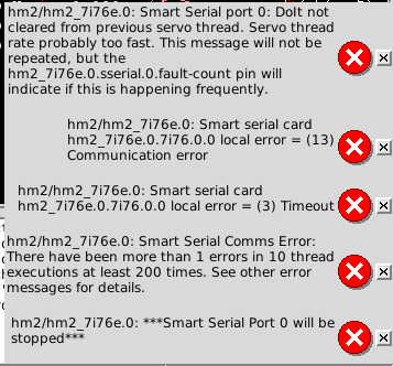

Hi
I am setting up a mesa 7i76e card and on two cards I get these errors. They have me stumped.

The first error (which is really the only important one) indicates problems with latency
What kernel and PC hardware (including Ethernet chip) are you using?
You can get the kernel info with:
uname -a
uname -a

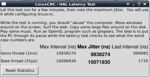

Replied by PCW on topic Strange error with mesa 7i76
OK, a couple of things...
1. You need Preempt-RT kernel to run Mesa Ethernet cards (you are running RTAI)
2. Dont know if you are running the uspace version of LInuxCNC or not but this is also required
3. You CPU looks like a Atom N270, even with the correct kernel this may not have enough
horsepower to run a Preempt-RT kernel and get decent latency YMMV
4. The easiest current way to get the proper kernel and uspace version of LinuxCNC
is to install the LinuxCNC/Debian Stretch test ISO:
www.linuxcnc.org/testing-stretch-rtpreem...-uspace-amd64-r9.iso

24 Nov 2017 12:49 #102285
I think that the apposite phrase is "absolutely terrible". The jitter should be a small fraction of the period. Any more than 5% is too much.
Your jitter is 98% of the thread period.
Replied by andypugh on topic Strange error with mesa 7i76
And the latency test. I never know how to interpret this
