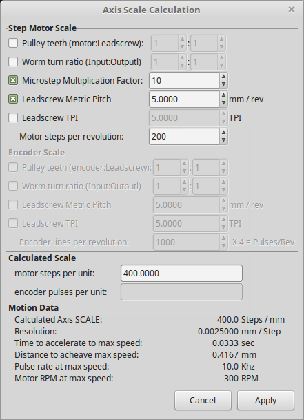

I connected my stepper to an arduino and wrote a small program which gives one pulse every 50µs:this runs perfectly fine with my stepper and driver (10 microsteps)
this should be a frequency of 20khz
and roughly10 revs/s or 600 revolutions per minute. (assuming the pulse width is 0)
this would give me (5mm/U leadscrew 3000mm/min)
this is way more than I need but I am happy having the speed.
So why can't I get this to work in PNCconf. it took me 5 minutes to code this for arduino but this stepper tuning timing is driving me insane.
I calculated the stepper scale with the wizard. 10 microsteps 5mm leadscrew 200 full steps
min dist is 0.0025mm
steps per mm is 400
but I suspect the stepperscale calculated by the wizard is wrong: 4 000 000
could that be the case?

- Todd Zuercher
- Posts: 4794
- Thank you received: 1482
19 Jan 2018 17:16 #104722
Replied by Todd Zuercher on topic First steps linuxcnc 7i76E
That is usually determined by the requirements of your step drives. Set them to something more than their minimum required step spacings. Or you could calculate your maximum step rate and set it to about half the smallest step interval time.
The following user(s) said Thank You: kor
- Posts: 18118
- Thank you received: 5335
19 Jan 2018 17:37 #104723
Replied by PCW on topic First steps linuxcnc 7i76E
If you have 400 steps per mm ( and a mm machine ) , the Stepper scale should be 400, Its as simple as that
( the stepper scale is steps per machine unit )
As Todd says the step timing should be set at something greater than the drives minimum settings.
If you don't know your drives specifications, as a starting point,
5000 steplength
5000 stepspace
20000 dirsetup
20000 dirhold
Works with almost all drives and gets you to 100 KHz = 15000 mm/m with your present scaling
( you motors/drives will limit you to much lower )

Oh the simple joy of seeing tha motor turning like it is supposed to.
I can't express in words how happy I am.
The stupid wizard just set the stepper scale wrong. no wonder that it could not work if linuxcnc thinks it needs to make 4 million steps instead of 400.
I think I am going to do the rest of the config manual. after that bad experience with pncconf.

- kor
- Posts: 71
19 Jan 2018 22:39 #104732
by kor
Replied by kor on topic First steps linuxcnc 7i76E
exactly the same. but when I clicked apply it changed the stepscale to 4 million.
My first idea is it has something todo with localization. If i remember correctly that number had a comma.
