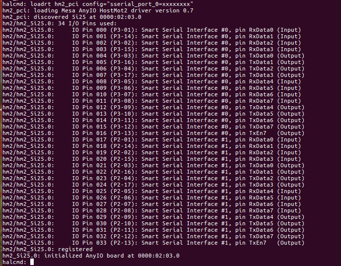

02 Mar 2018 03:56 - 02 Mar 2018 03:57 #106837
by thang
Replied by thang on topic how to setup mesa 7i83
i got 7i74, after connecting 5i25 --> 7i74 ( powered 5V via TB1 not cable) --> 7i83 ( with 24V supply), i installed firmware 5i25_7i74x2, now what i need to do next? i just want to send a simple analog signal to 7i83 output.
I dont need to install firmware for 7i83, right?
I want to use Port 3 of 5i25 channel 3 of 7i74 so what config string should i use? Does it like:
loadrt hostmot2
loadrt pci_hm2 config = "sserial_port_2=000xxx"
loadrt hostmot2

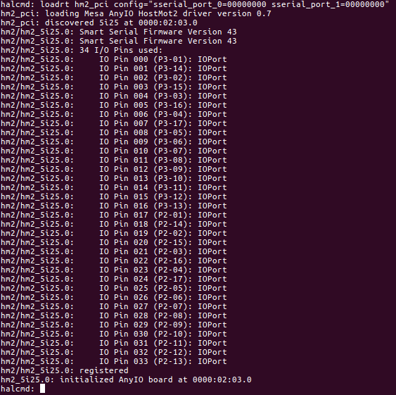

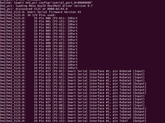

- Posts: 18118
- Thank you received: 5336
02 Mar 2018 08:20 #106849
Replied by PCW on topic how to setup mesa 7i83
"sserial_port_0=00000000"
would make sense for a 7I74X2 config with only the first port (on P3) used
(and all 8 channels of port 0 set to mode 0)
If you use all 16 channels (a 7I74 on P3 and P2) you could use
"sserial_port_0=00000000 sserial_port_1=00000000"

02 Mar 2018 11:35 #106857
by thang
Thank you very much for help,
so in "sserial_port_0 = 00000000" the serial_port_0 is controlled by P3, 8 number zeros are 8 channels, but:
What do you mean about "mode 0", are there some other modes or it just means enable and disable? Where can i find these config strings ? I read document of 7i74 but didnt find it out
I also wanna know what are hal_pins name to control, is that like " hm2_5i25.0.7i74.0.1.analogout1" i found this type name from gnipsel.com/linuxcnc/configs/7i77.html . But i dont understand what do numbers mean?
I think a simple way to send an analog signal to 7i83 is:
Use M66-67 command, connect pin "motion.analog-out-NN" to "7i74 hal pin"

02 Mar 2018 23:42 #106869
by thang
i'm using 7i74x2 firmware.
the "sserial_port_0=00000000" will set P2 to mode 0
the "sserial_port_0=00000000 sserial_port_1=00000000" wont set P2 and P3 to mode 0
the "sserial_port_0=xxxxxxxx" will set P2 and P3 to mode 0
below is my config file:
it shows bug :
./5i25.hal:61: Pin 'hm2_5i25.0.7i83.0.1.analogout0' does not exist
it shows bug :
