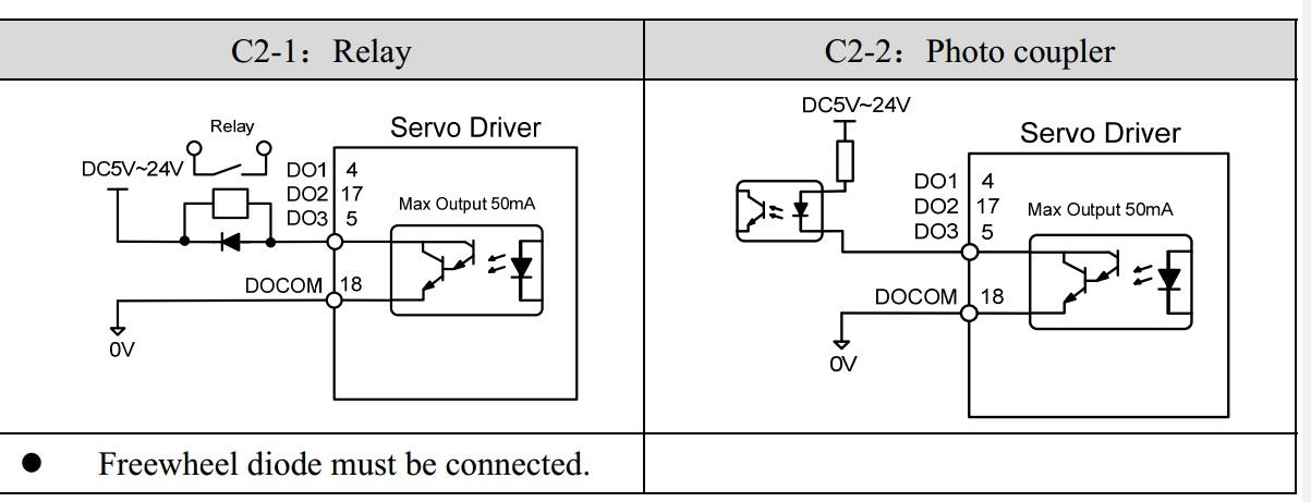

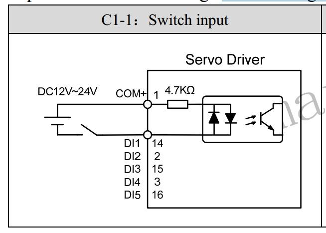

Dear all forumers,
I have Maxine EP1C driver and there are inputs and outputs are controls with "gnd" voltage. I add pictures from manual.
I have MESA 7i76 card and there to input should come 24V but in manual of the drive to output connects 24V but it not generates them. Should I connect to DO1 of drive DI of messa and to DOCOM - GND? IT will be inverse signal then.
And outputs of MESA should send 24 V but to input of the drive comes gnd. Can I connect to input of the drive - output of mesa 7i76 card? Will it work?

Thats bit awkward since the both the drives inputs and outputs work the opposite way as the 7I76s I/O
For 7I76 inputs you can add a stiff (say 2K) pullup resistor
Ror 7I76 outputs you would need to add a relay or OPTO
(or use a 7I76D which has sinking outputs)

05 Mar 2018 15:52 #106959
by aleksamc
Replied by aleksamc on topic How to connect input and output to MESA 7i76
Thank you Peter. I used Relay as you advised.
