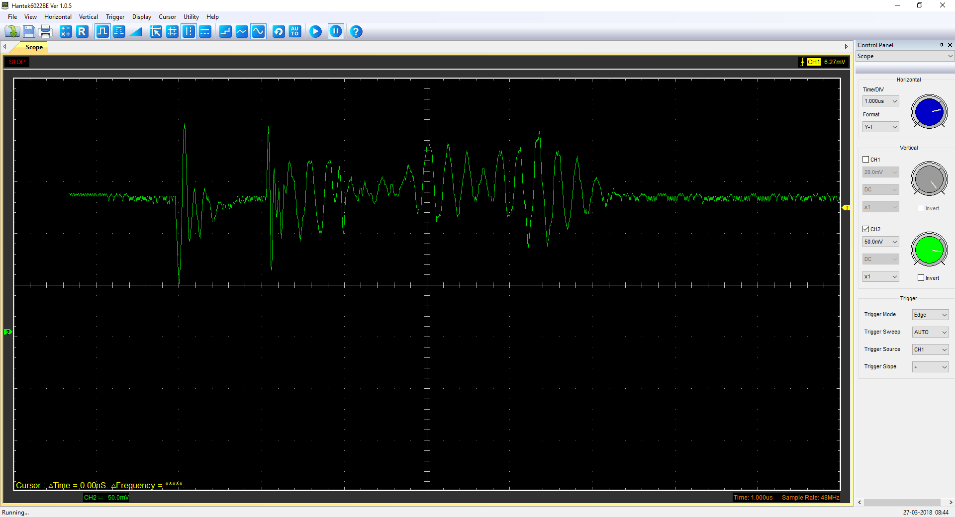

Help me out here. Should I connect the Oscilloscope ground to the F- or -5V pin on the THCAD?
This does not look right.
This is with the probe attached to F+ and F- which I disconnected at the 7i76e end so I could hook a probe on easily.
I also tried F+ and -5V but it made no difference. The reading was still random as shown.
I'm assuming I should be seeing a sine or square wave.
I've still to test the 7i76e encoder.

You should connect your scope ground to the THCAD GND pin (P1 pin 6)
You should expect a ~ 3V square wave from the F+ and F- pins (in the DIV/32 mode)

Thanks Peter. Thats what I thought after I did these screen dumps. I tried it that way and did not go outside the 50 mV range. The board must be cactus. I'll go and grab another screen dump to be sure. Still need to test the encoder but I understand your instructions for that one.
Replied by rodw on topic Fried my THCAD-10
