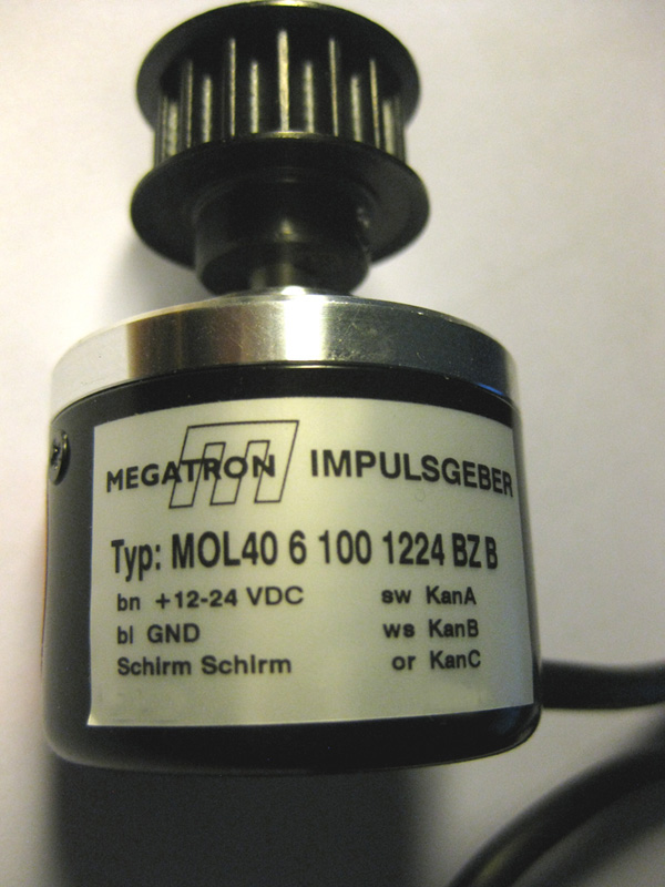

Encoder MOL40 12-24V

05 Apr 2018 14:06 #108450
Replied by Todd Zuercher on topic Encoder MOL40 12-24V

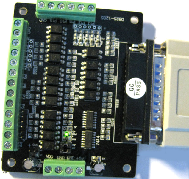

Yes, if your breakout board is 12v or 24v tolerant.
Such as this one.
cnc4pc.com/c31-optoisolated-24v-breakout-board.html

14 Apr 2018 22:38 #109016
Replied by tommylight on topic Encoder MOL40 12-24V
That BOB is extremely slow so the count rate is going to be miserable.
Much better to use the parallel port with the addition of voltage dividers. Search goolge for it, easy to do with some resistors.
Wire resistors to parallel port inputs first, 100 Ohm will do fine, then wire voltage divider output to those resistors, otherwise any miss wire will kill the port.
