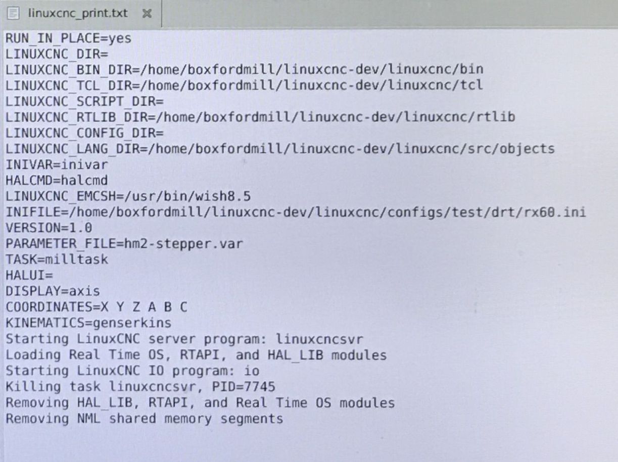

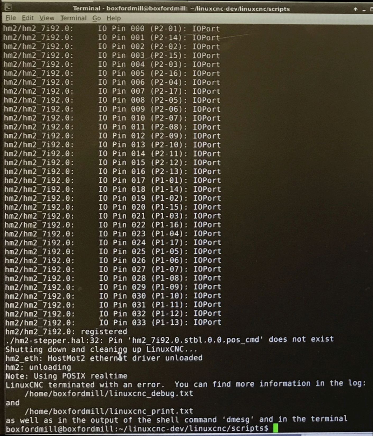

We have a linuxcnc build driving a Staubli arm it has been moved but no system changes as far as we know when we fired it up we had some challenges, we could not get Linuxcnc to start up it was failing after appearing to load the mesa pins, The sequence of flashing lights indicates that the Mesa card has successfully been read by the software and the configuration loaded it gives the error message
./hm2-stepper.hal:32: Pin 'hm2_7i92.stl.0.0.pos_cmd' does not exist

Looks like it did not find a STBL motor drive? that could be a lot of things:
Wiring, power (interface and drives) etc etc

Yes, the 7i92 is OK but the STMBL drives are not being found.
If the drives are powered then that might mean that they have "forgotten" that their config includes smart-serial.
Or the problem could lie in the 7i74/7i44 interface. 5V power good there?

Thanks @PCW and @andypugh .. I had it in my head that the issue was with the software side of it when I was looking at it and was chasing a (probably) non existent problem with privileges, dial out group, udev etc as I thought the software could not access the mesa card to actually run anything - when I got home I read up and saw the lights on 7i92 meant that it was working, I will investigate further down stream with the STMBL's I did a quick check the mesa card was getting 5VDC and checked the polarity but did not really look further down stream Ross and I will now be back to have another look on Friday - Thank for the help
