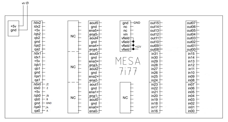

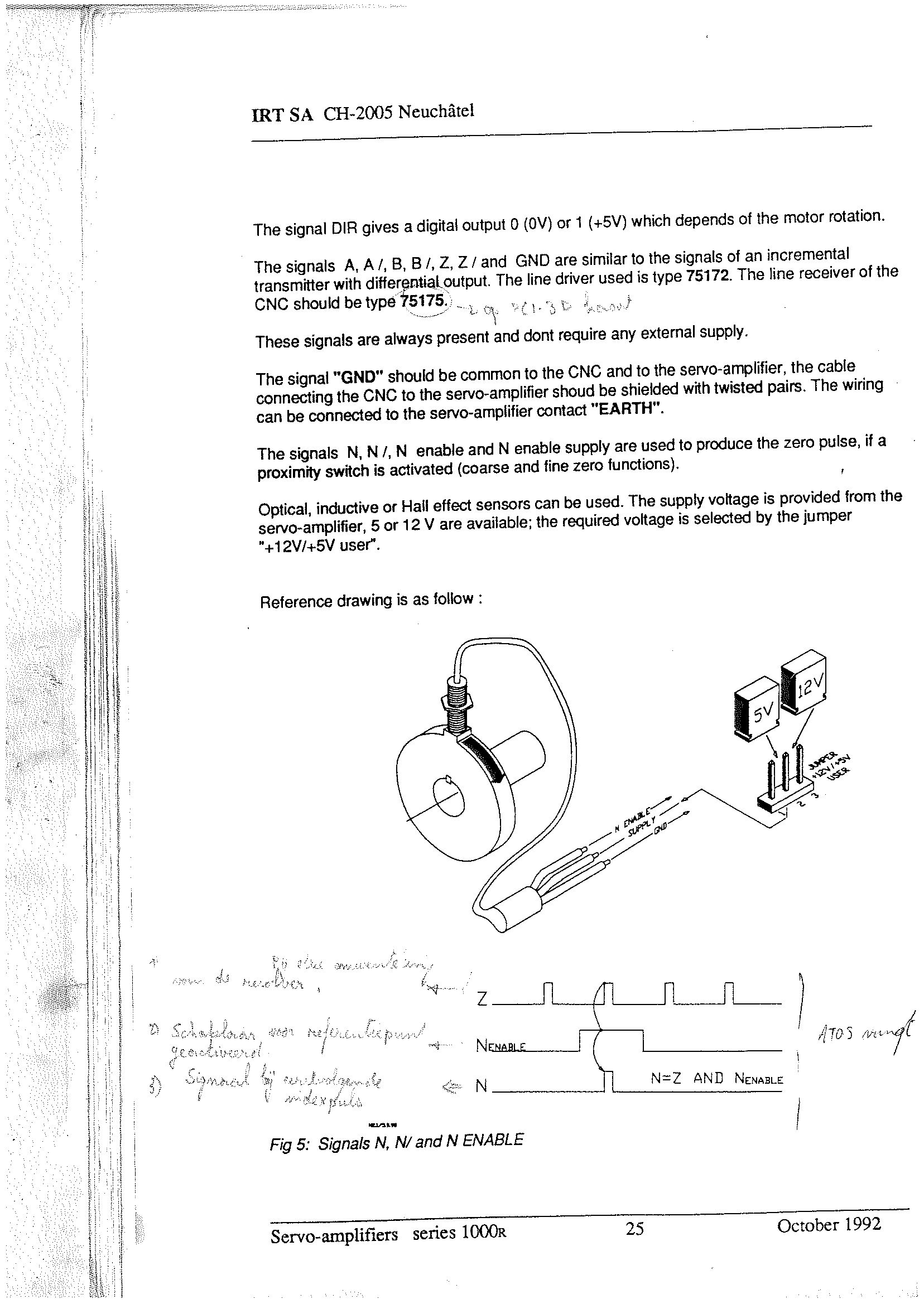

Hello everyone,
I am new on this forum so if this is posted in the wrong section, I'm sorry.
I have a little bit of trouble connecting the 5i25 & 7i77 with my encoder (servo amplifier with simulated encoder output).
My servo amplifier is an IRT SA series 1000r. I have a bunch of cables I need to connect to the 7i77 that comes from this amplifier. There are two connectors that go out of the amplifier: I/O connector and the simulated encoder output.
The servo motor is already connected to the amplifier. The only thing I need to do now is to connect the amplifier with the 7i77 mesa board but I am not sure how to do it: the pin out for the I/O connector and the pin out for the simulated encoder are listed in the images below (see attachments). I have connected most of the encoder wires (see data sheet) but I don't know how to connect the I/O wires from the amplifier. Can you guys help me connecting this so I can try to turn my servo motor ? (I want to test the setup with one servo motor)
Thanks for this and sorry for my English. If this is a little bit unclear, please tell.

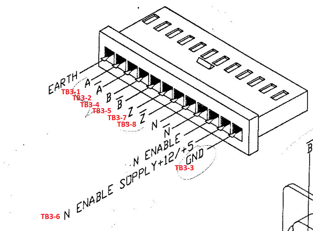

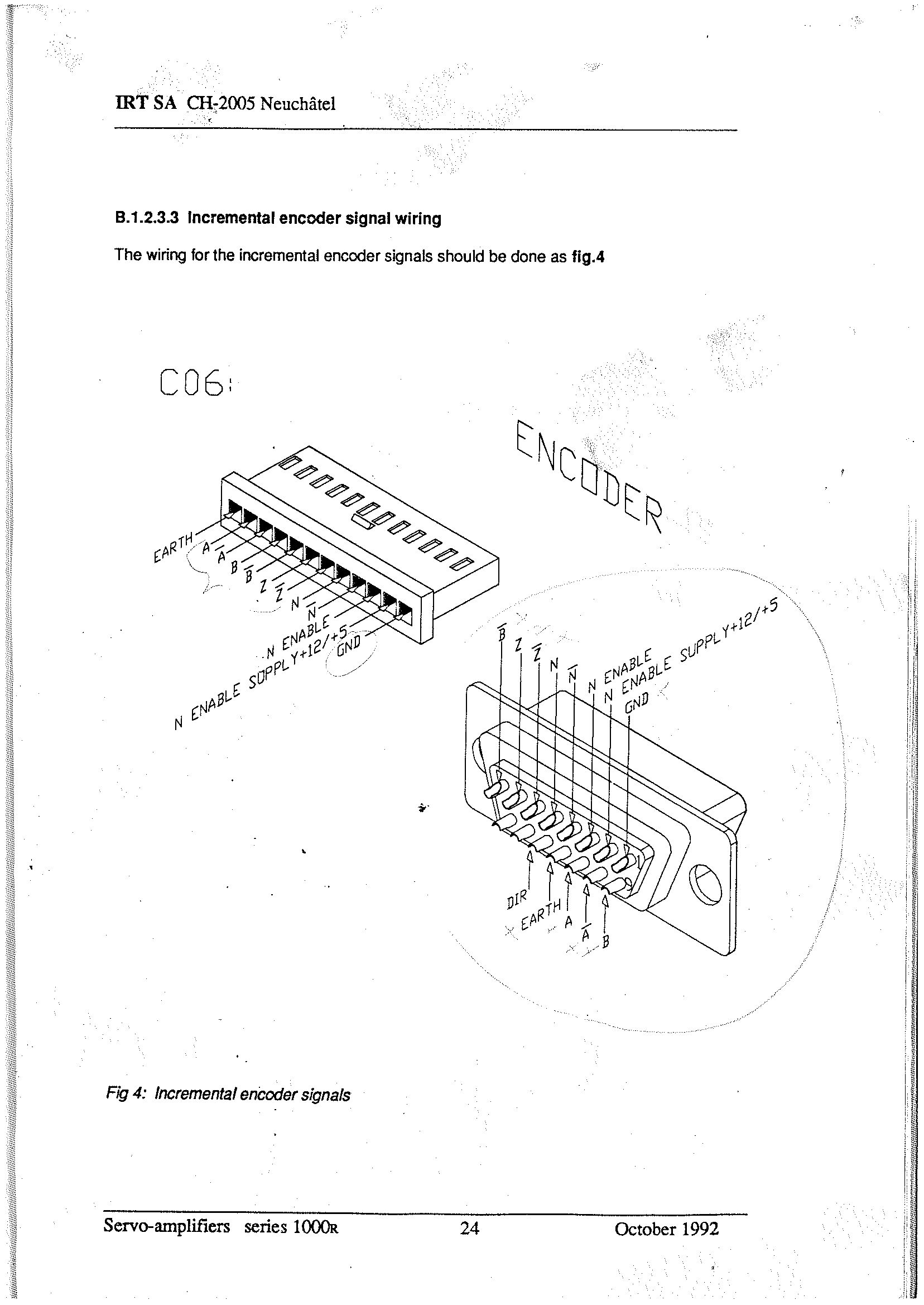

Hello Konikoko,
Here is my take on it...
Encoder:
You have a differential encoder, so the the three jumpers for that axis need to be in the default right hand position.
The 7i77 powers encoders with 5VDC. This is one of the options for powering your encoders - you will need to ensure your encoder is jumpered for 5V per your third attachment. The 7i77 can not provide enough current through through the cable from the 5i25 for multiple encoders. You need to provide sufficient 5V power on the 7i77 TB1 connector, and change the jumper W5 to the right hand postion, while ensuring the 5i25 jumper W1 and W2 are both in the down position (refer to the MESA manuals for which way is up and right)
The first axis encoder connects to TB3 as follows:
Motor:

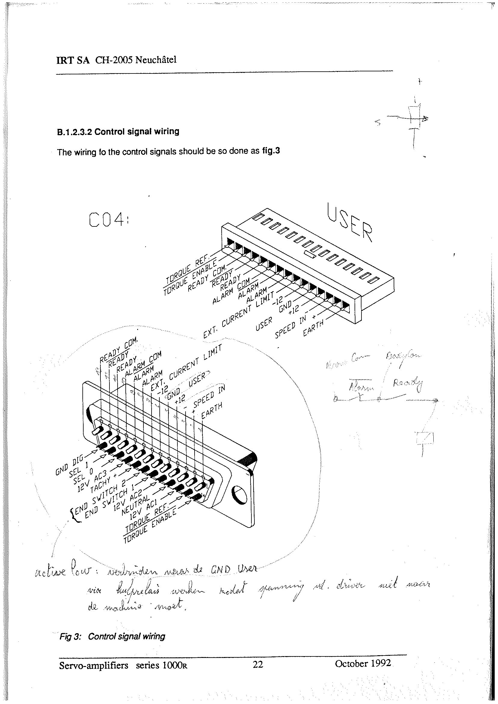

I also found MESA's description of the motor terminal assignment confusing. The paired pins for the +/-10V analog drive signals are on TB5 and called GND and AOUT10. So for the same axis as the encoder above...
Other pins such as the "Alarm", "Ready" are outputs from the driver module, which you should connect into LinuxCNC through general input pins such as TB7-1 through TB7-10, and then set up your INI and Config files to trigger E Stop on "Alarm" for example.
Mark

Hello everyone,
I figured everything out. I will list all the connections I made in this topic so that others can benefit from this.
The setup is for an IRT SA CH-2005 Neuchatel servo amplifier with the 5i25/7i77, one servo motor and one mpg.
TB3 ENC 0
QA0 ---> A (from servo amplifier)
/QA0 ---> /A
GND ---> GND
QB0 ---> B
/QB0 ---> /B
+5v ---> nothing (has its own power)
IDX0 ---> Z
/IDX0 ---> /Z
TB2 Field:
1,2,3,4 ---> 12v power supply (W1 in default left hand position).
GROUND ---> GND and END SWITCH 1 & 2 (from servo amplifier), MPG 0V (from MPG)
TB5 DRIVE 0:
ENA0- ---> Torque Ref
ENA0+ ---> Torque Enable
GND ---> +Speed
AOUT0 ---> -Speed
I/O TB7
16 ---> MPG A
17 ---> MPG B
The mpg was installed by enabling mode 3 in PNCconf.
