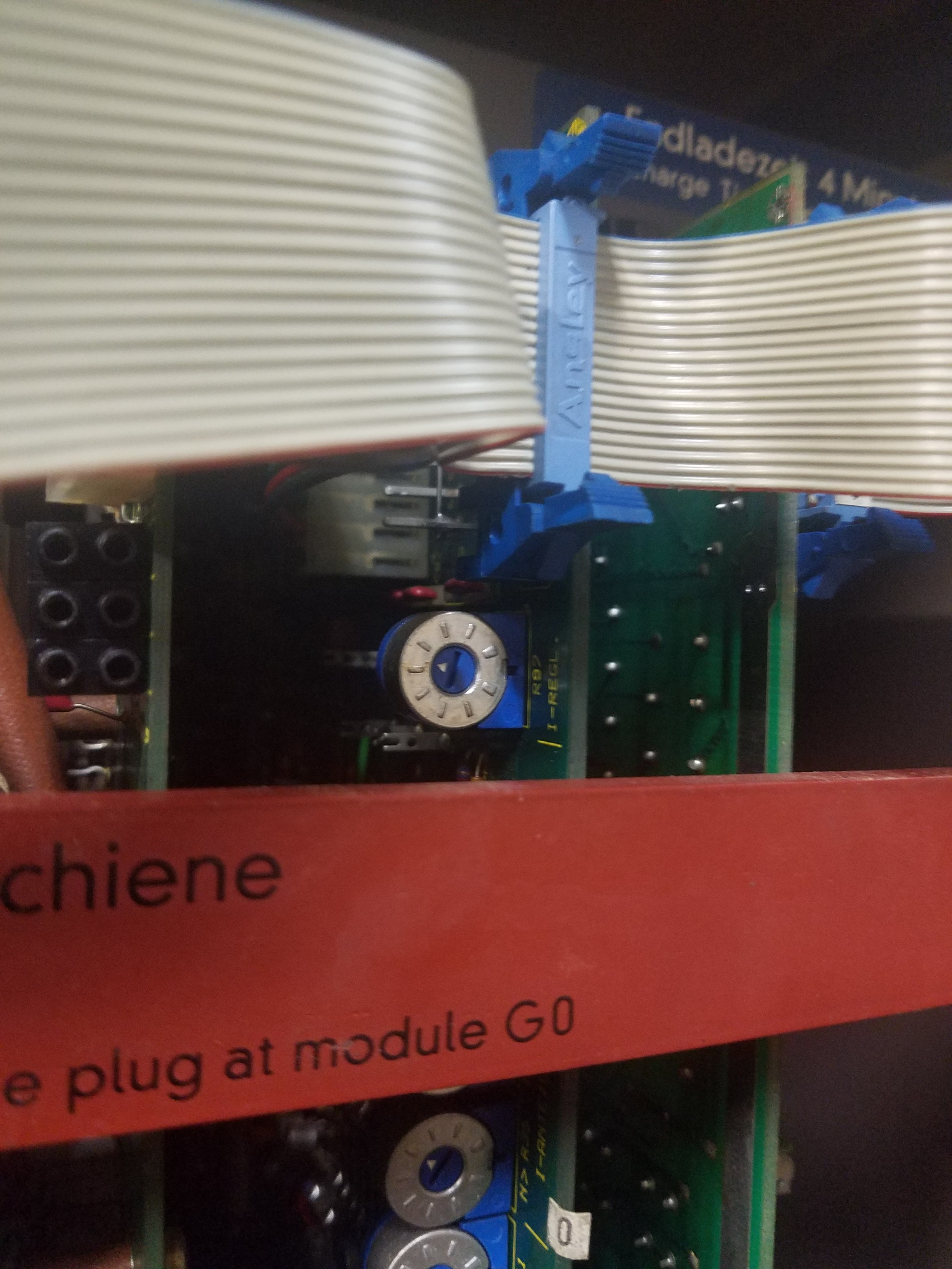

Replied by Deckerjwd on topic Hardinge super slant w/ siemens 6RB
it moved! jerky and lots of servo tuning to do. going to research now on how to tune the siemens 6rb. there are a bunch of cryptic potentiometers i got r11 tacho, r20 drift, N>r25 N<r25 p-verst, N>r35 N<r35 i-anteil, and r97 i-regl. think they maybe in german also. some like tacho, drift and i-reg make sense to me but the middle four are beyond me. the last owner told me i had to tune them andd he didnt know how to do it
Last edit: 26 Sep 2018 21:44 by Deckerjwd.
- Posts: 19908
- Thank you received: 4656
27 Sep 2018 11:28 #118062
Replied by andypugh on topic Hardinge super slant w/ siemens 6RB
If the machine was working before then I would start by assuming that the drive tuning is close, and try tuning the LinuxCNC PID first.
- Deckerjwd
- Posts: 95
- Thank you received: 3
28 Sep 2018 10:28 #118120
by Deckerjwd
it did not work when we got it. but i did drive it around with a variable power supply so think there close. the Z seems to have a problem in the negative directions, it jerks.
