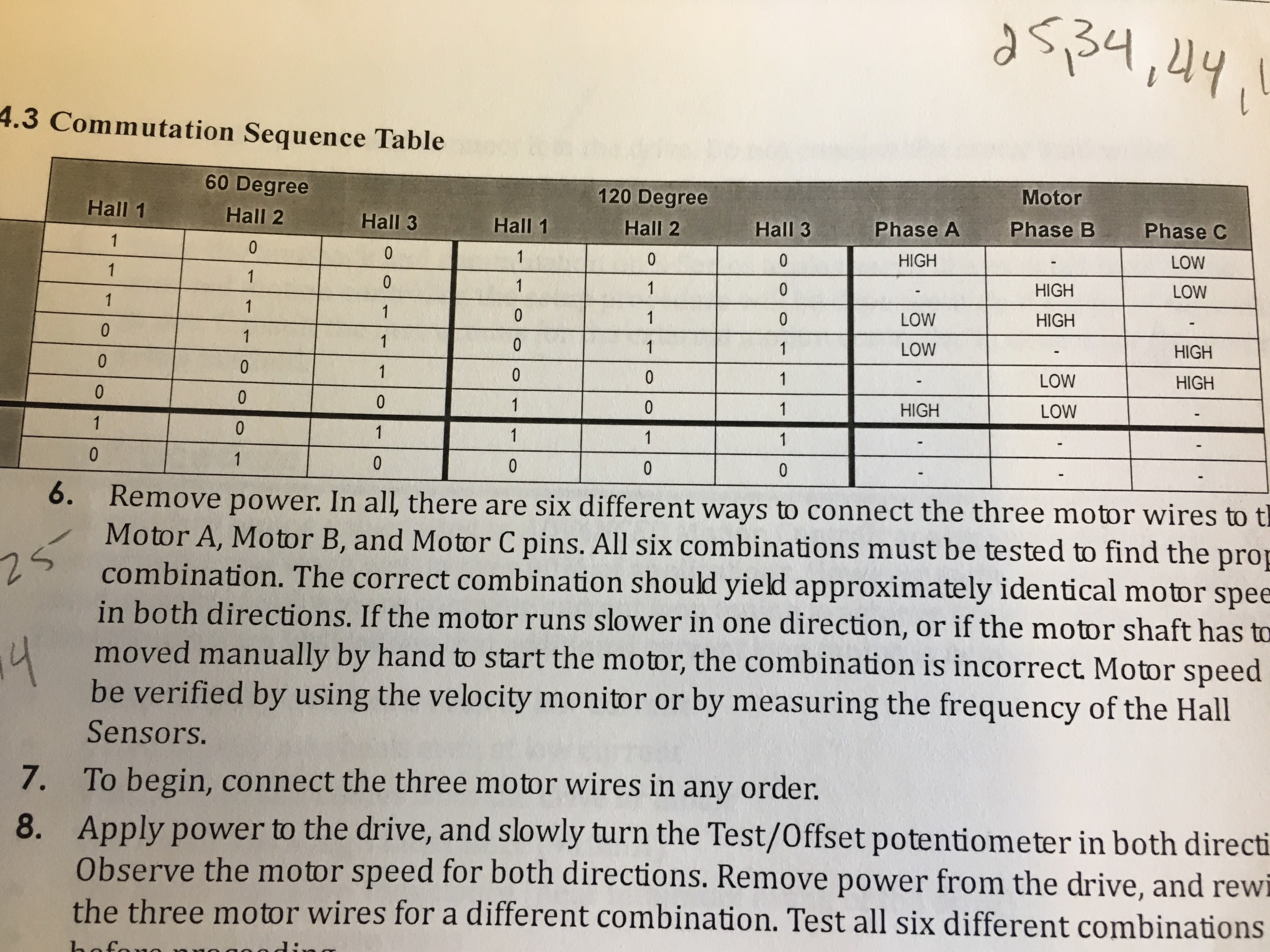

This is the chart from the Amc hardware manual for the drives. I have found that pattern 17 and 34 work, although the motor runs smoother in one direction then the other. Yaskawa considers standard motor direction to be ccw while facing the driving end of the motor. It has also occurred to me that I'm asking to much from a rspi.
