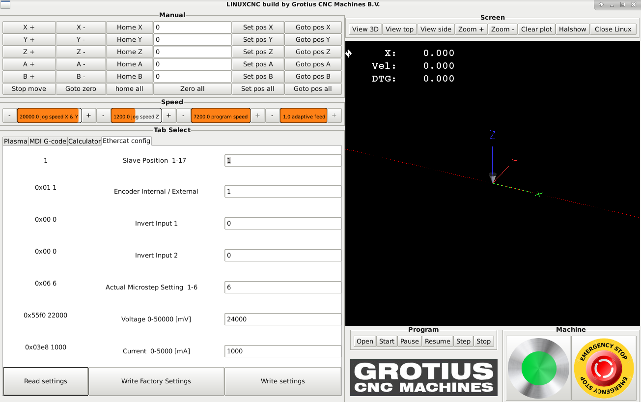

23 Dec 2018 19:36 - 23 Dec 2018 19:43 #122791
by Grotius
Replied by Grotius on topic Ethercat 64 bit stepper drive basic example EL7041
Next level is to integrate the parameter settings into the linuxcnc gui.
If you have a multi axis configuration, typing command line entry's for 3 or 4 axis can take a while.
In fact you have to set driver voltage, motor current, etc for all axis separate.
To make a quick configuration possible without terminal usage, i made a gui integration example.
The main function is :
1. Load all important stepper drive settings from stepper drive 1 to stepper drive 17
2. Customize and set all important stepper drive settings from drive 1 to 17
User has to make a glade screen, just like the picture above with button's, label's and text entry's.
The attached code uses subprocess. This are terminal command's like os.system command's.
The subprocess write command's to terminal, also read value's back from terminal output.
The terminal command's are expanded with .format strings to make a kind of variable terminal command's possible.
Because Ehercat is working outside of Linuxcnc, stepper and servo driver settings can be set in a running program.
This is a big advantage ! You don't have to restart Linuxcnc.

Could be outdated now. This for your info.
updating the linuxcnc-ethercat is good idea.
codeberg.org/skynet/linuxcnc/src/branch/...er/cmake/libethercat
you know how cmake install works?
There is also a build script in the repositoy.
Otherwise you can use the linuxcnc install method.
Last edit: 19 Jan 2025 01:21 by Grotius.
- EmcRules
- Posts: 9
19 Jan 2025 01:12 #319333
by EmcRules
Replied by EmcRules on topic Ethercat 64 bit stepper drive basic example EL7041
yes i have it matching the output of "ethercat slaves"
0 = coupler
1 7041
2 7041
3 7041
0 = coupler
1 7041
2 7041
3 7041
