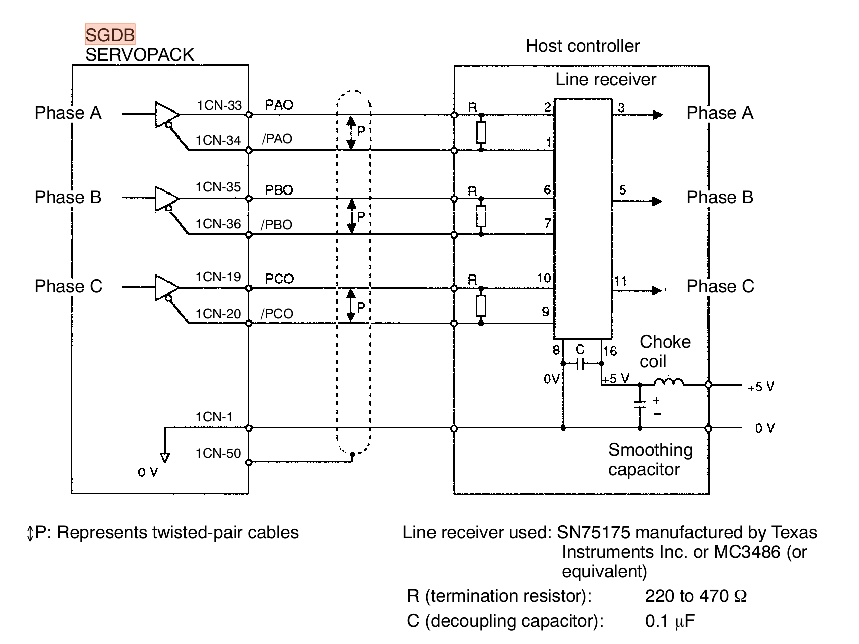

Question 2.) I have Yaskawa Sigma 1 servo drives (SGDB) I want to operate them in speed/velocity mode with LinuxCNC.
Sigma 1 Yaskawa SGDB drives in velocity/speed mode produce Quadruple Differential (RS-422) encoder output.
The Mesa 7i65 supports RS-422 differential encoders so I believe it should work with my Servo Drives.
Does that sound correct?

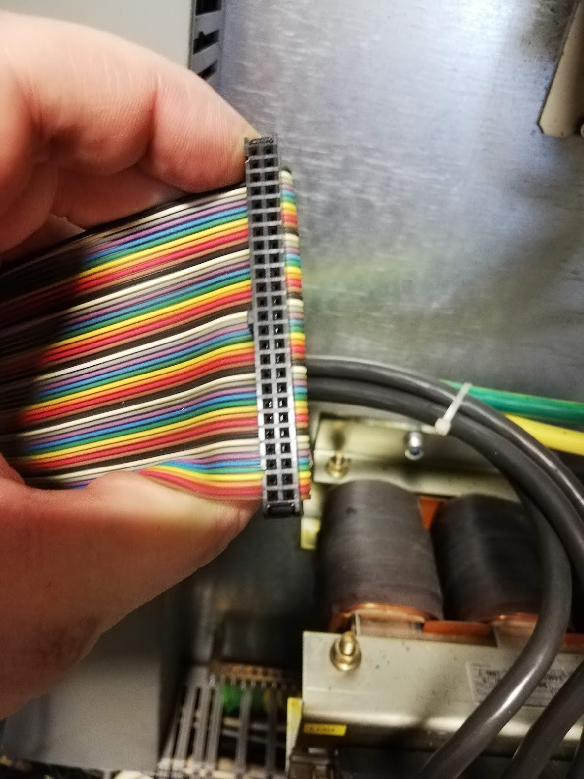

Question 3.) I have 50 pin IDC Ribbons where the old controllers 24v I/O connected. I'm hoping I can directly connect those 50 IDC ribbons into the 50 pin IDC connectors on the Mesa 6i24. Is that going to work?

1. Yes, a 6i24 and 7I76 can work together
2. Both the 7I65 and the 7I77 have differential encoder inputs so should work fine
with your drives
3. This depends on the pinout of the 50 pin connectors, all of our 50 pin I/O FPGA cards
have a pinout the matches OPTO22-Gordos etc 24 channel I/O module racks
A 6I25/5I25/7I92 + 7I77 would be a more common card set for this type of application
(perhaps with a 7I90HD added for 50 PIN I/O if your pinout matches)

The 6i25 has a second header that can be connected to another DB25 card. As has been mentioned, one possible DB25 card is the 7i84 which can connect 8 more smart-serial cards.
Replied by andypugh on topic LinuxCNC with Mesa 7i65 and 6i24 FPGA
The headers on the 6i24 are for logic-level inputs. You would use daughter cards to choose the required voltage and current levels to be driven, and in which direction. For example the 7i37TAI realized the 6i24 wouldn't work because it's not made for 24v I/O inputs (from what I could tell)
Don't forget that there is some IO on the 7i77, so together with the 7i84 you have a fair bit of IO already.I may need more I/O - not exactly sure. Can you daisy chain 7i84's together?
