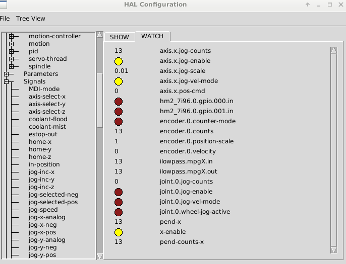

10 Jan 2019 12:56 #123897
by Clive S
Replied by Clive S on topic Mill conversion with Mesa 7i96
I can't see the wood for the trees. I can't seem to see the reason for the mpg not moving the axis.
axis.x.pos-cmd only changes with keyboard jog and not with the mpg.

- Posts: 18117
- Thank you received: 5335
10 Jan 2019 14:12 #123900
Replied by PCW on topic Mill conversion with Mesa 7i96
Is the system homed? if not you would have to jog individual joints, not axis.

10 Jan 2019 14:37 #123901
by Clive S
Yes I forgot about that the above now works when homed.
This is on a small mill so can I change it to jog joints instead of axis
