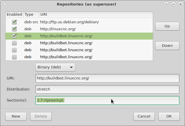

One of the simplest ways to upgrade to Master (2.8) is with Synaptic. Open Synaptic, then under the menu Settings choose Repositories. That will open a window like this one.
Scroll down and select the Linuxcnc Buildbot repo (or add it if it isn't there already).
Then change the Section from 2.7-rtpreempt (as in the above image) to master-rtpreempt and click ok.
Now click the Reload button, then Mark All Upgrades, then Apply.
That should get you the latest version of Master.
