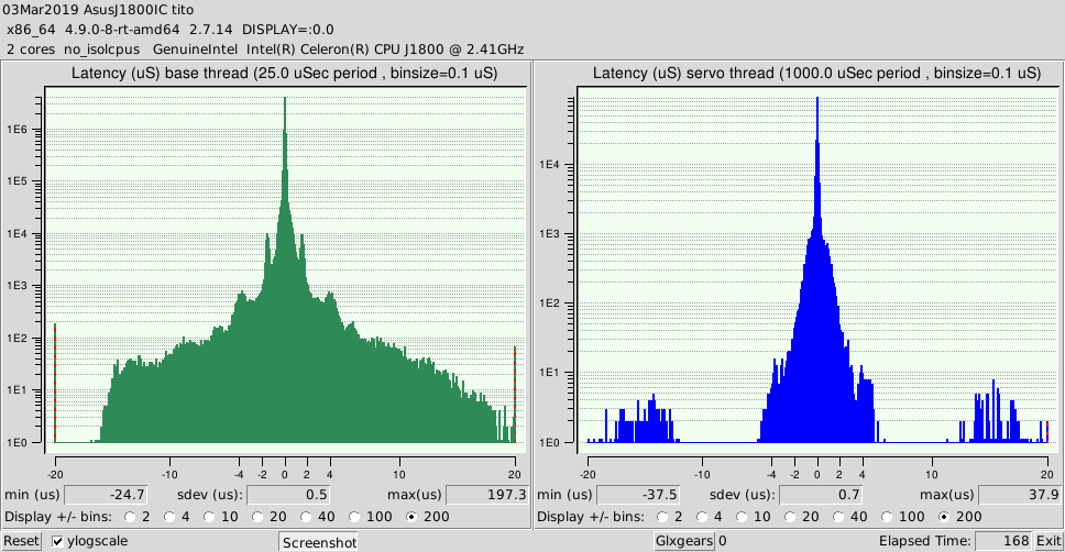

However the RTT latency remains high even on my new Asus J1800I-C:
$ping 10.10.10.10
PING 10.10.10.10 (10.10.10.10): 56 data bytes
64 bytes from 10.10.10.10: icmp_seq=0 ttl=64 time=0,265 ms
64 bytes from 10.10.10.10: icmp_seq=1 ttl=64 time=0,344 ms
64 bytes from 10.10.10.10: icmp_seq=2 ttl=64 time=0,257 ms
--- 10.10.10.10 ping statistics ---
3 packets transmitted, 3 packets received, 0% packet loss
round-trip min/avg/max/stddev = 0,257/0,289/0,344/0,039 msi
I've been trying plugging a pci-E gigabit ethernet card (TP-LINK TG-3468)
but nothing changed.
Obviously, i'm using a direct link by an ethernet cross-cable.

In attachment can you see the latency histogram of my system.
