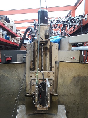

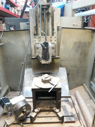

hello , i 'have a same machine but fanuc , 10 years ago , i change motor pap for the axis ,and the machine turn whit kress perfectly , now i ' want put mesa 5i25 and 7i76 and change for original spindle motor (fanuc 3s), it' s no easy .
if you want we can exchange experience.
regards

the work in progress

the vmashine looks very stable and ypou will make good parts
did you already buy some cards
the 7i76e gives you the most advantige
