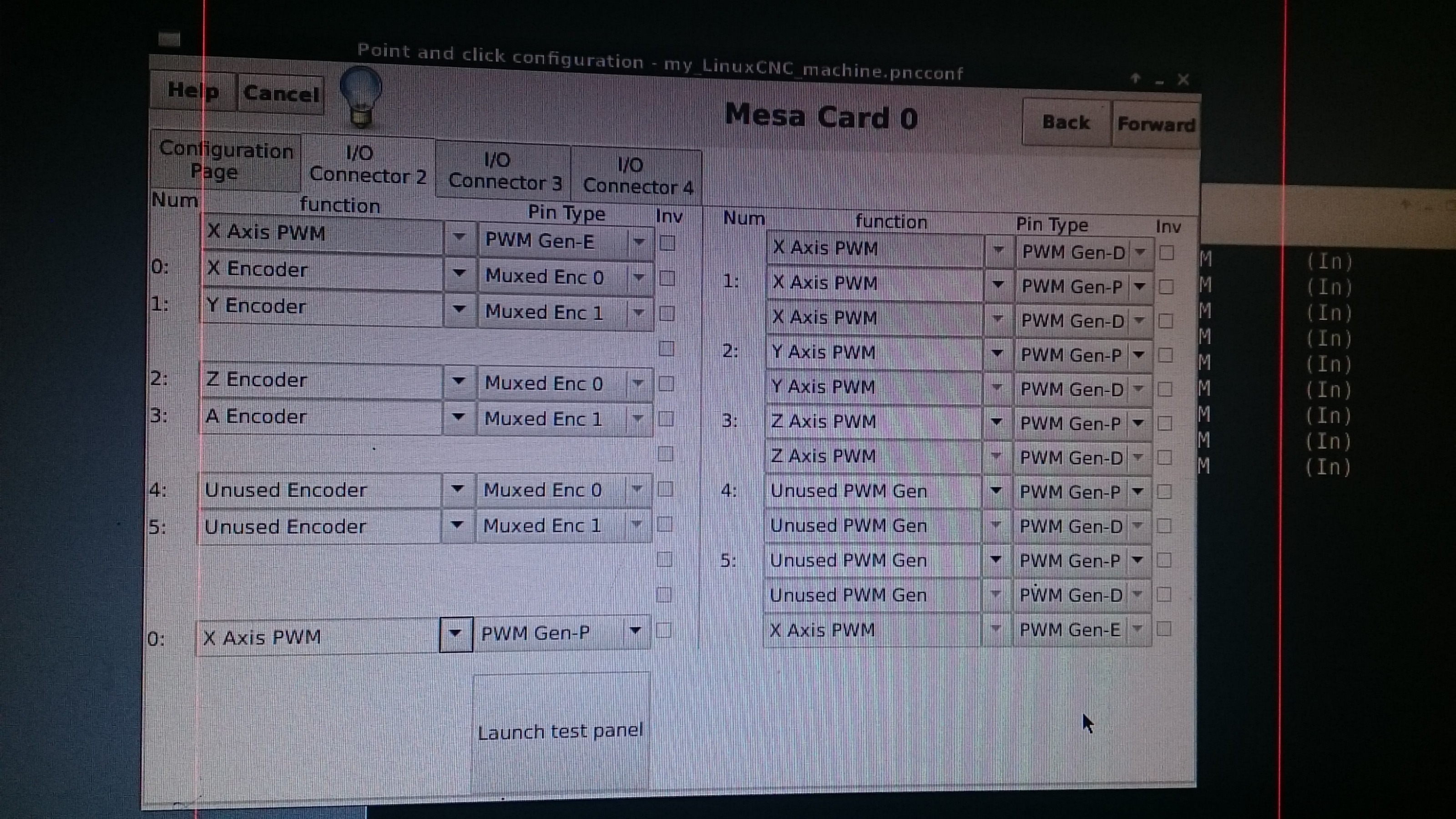

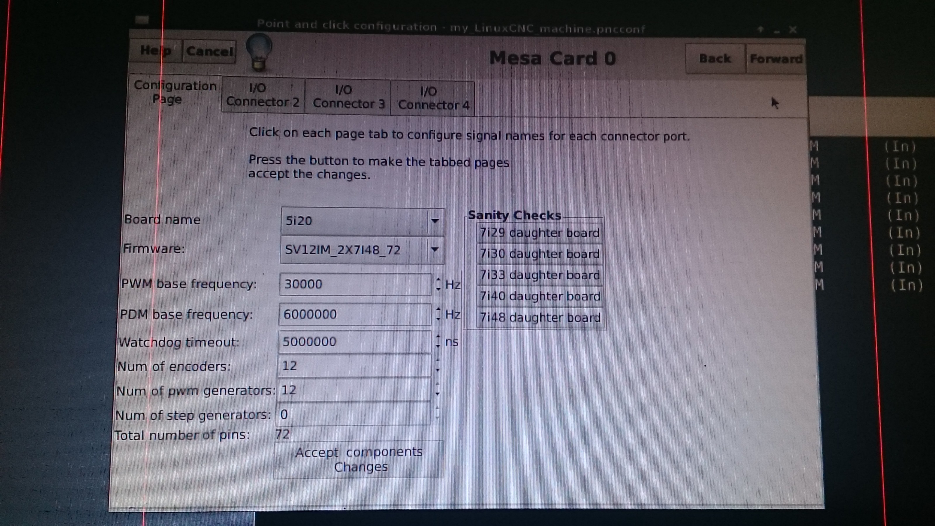

03 May 2019 01:33 #132605
by Chathuranga555
Replied by Chathuranga555 on topic 5I24-25-ROHs board firmware flash

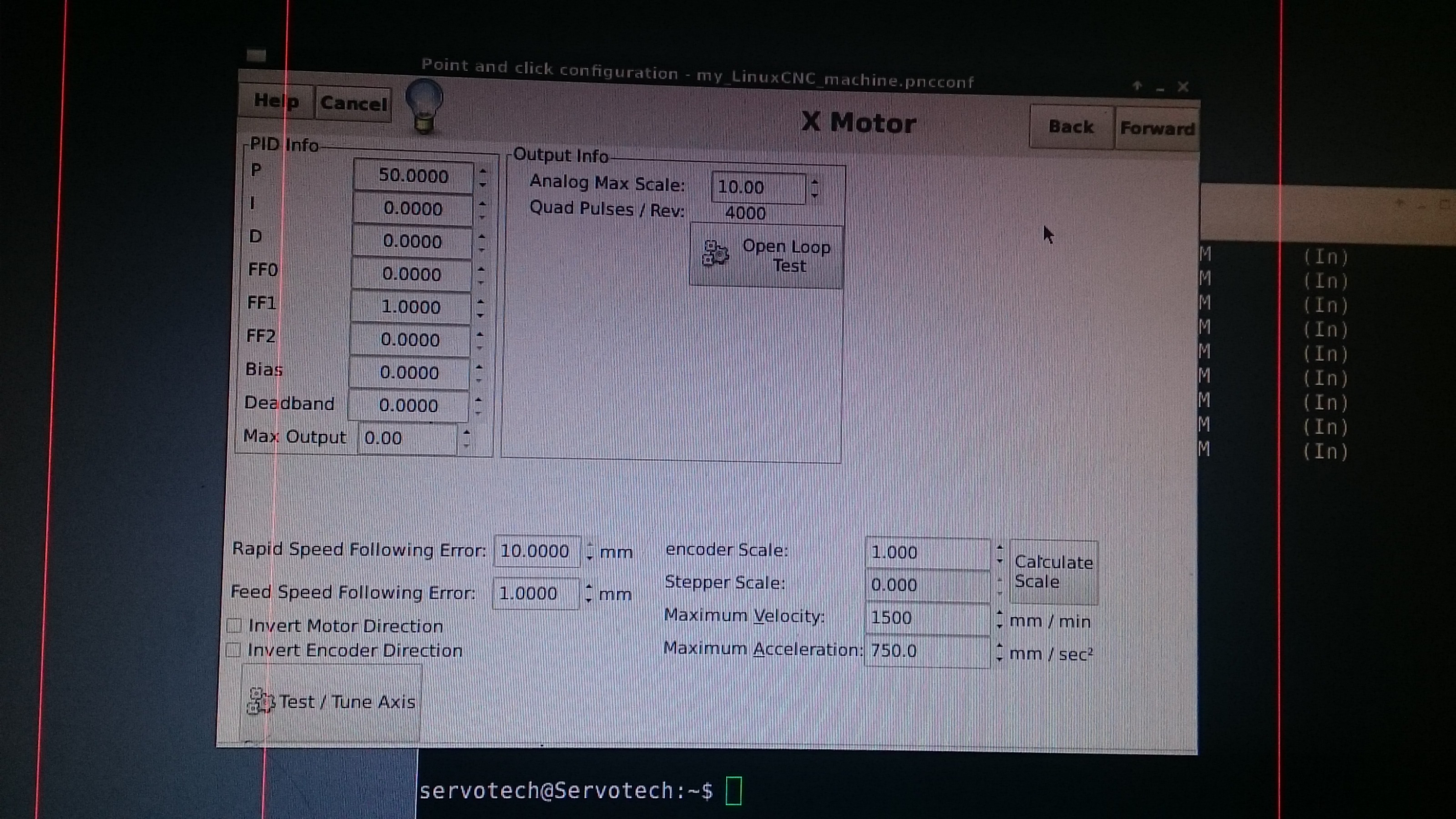

With a new 5i24 card, flashed 5i24_25_sv12im_2x7i48.bit file. In linuxcnc pncconf wizard i configured as attached images. But then when launch cnc file it says pwmgen. Pwm frequency not fount. Is there anything wrong i have done?
- Posts: 18118
- Thank you received: 5336
03 May 2019 08:33 #132631
Replied by PCW on topic 5I24-25-ROHs board firmware flash
If pncconf does not support the 5I24 (looks like you have a 5I20 configuration selected)
you would need to edit the hal file and replace all instances of "5i20" with "5i24"

03 May 2019 09:07 #132633
by Chathuranga555
Now its working properly

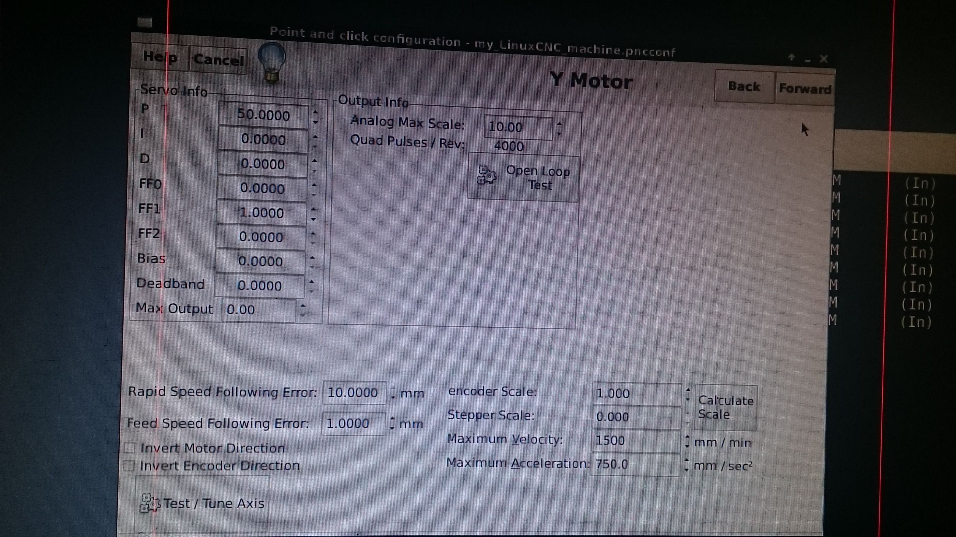

08 May 2019 10:55 #133161
by Chathuranga555
With my mesa 5i24 and 7i48 i tried to control servo motor with an analog driver. But after i connect the encoder to 7i48 and driver when turning on the machine in linux cnc, motor continueslu rotates cw and encoder value also increasing but when it reaches soft limits it wont stop. After change some settings in calibration window, able to stop after reaching soft limits but totally stop after severel seconds when driver lost enable signal. What should i do to properly tune the servo? Please help.
P= 0.0001
I=0
D= 10
Ff0 = 0
Ff1 = 0.01
Ff2=0
Dedband= 0
Output scale =10
Encoder scale =4000
P= 0.0001
I=0
D= 10
Ff0 = 0
Ff1 = 0.01
Ff2=0
Dedband= 0
Output scale =10
Encoder scale =4000

08 May 2019 11:43 #133168
For starters, you have a 50% chance of the wrong feedback direction ( guaranteeing runaway ) when you intially set things up
I would look at this general guide to tuning velocity mode servos here:
gnipsel.com/linuxcnc/tuning/servo.html
