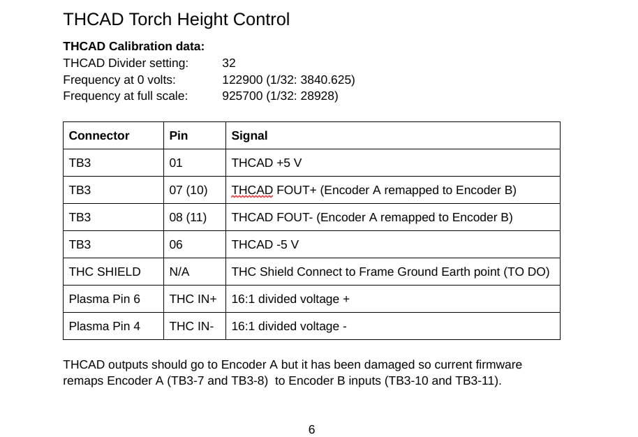

Houston, we have a problem.
I have the THCAD10 wired into the 7i96 but I don't seem to be able to get a frequency reading.
FO+ to ENA+
FO- to ENA-
5v and gnd
Divider is set to F/32, and W1 is in the UP position for unipolar.
*Note #1: the silkscreen for the W1 jumper is quite confusing compared to the manual.
* #2: the silkscreen on the P1 connector shows from top down: +5v FO- FO+ BUT the manual shows +5v FO+ FO- !!
The thcad LED slowly blinks, and when I apply voltage to the IN pins it blinks faster.
Looking at the Hal Config watch window, hm2_7i96.0.encoder.00.velocity is always zero.
.count and .position alternate from 0 to -1
.input-a blinks
.rawcounts alternates from 0 to 1
.sample-frequency is constant at 25000000
My first attempt I wired FO and ENA +- per the silkscreen, which I believe was backwards. After finding the discrepancies in the manual I switched the +- around. Could this possibly had fried something? I've tried bipolar and unipoler, F/1 and F/32.

You should be able to ee the encoder counts flickering around the 0 volt frequency

30 May 2019 14:25 #135391 by PCW
Replied by PCW on topic Wiring 7i96 and THCAD
setp hm2_7i96.0.encoder.00.counter-mode 1

30 May 2019 15:38 - 30 May 2019 15:59 #135397 by AgentWD40
Replied by AgentWD40 on topic Wiring 7i96 and THCAD
the encoder B input is the UP/DOWN signal when in UP/DOWN mode
Well I'm confused again. Am I supposed to be using B instead of A?
If not here is the plan sticking with ENA:
7i96 jumpers W2 to the right for differential, W3, and W4 to the LEFT for TTL mode. THCAD10 jumper for F/32 and unipolar input with the jumper over the TOP two pins.
setp hm2_7i96.0.encoder.00.filter 1
setp hm2_7i96.0.encoder.00.scale -1
net plasmac:arc-voltage-in hm2_7i96.0.encoder.00.velocity => plasmac.arc-voltage-in
The way I'm reading it the THCAD silkscreen and W1 jumper and the THCAD manual are conflicting. Can you clarify?
Also, the FOUT+- pins are swapped around between the manual and silkscreen. Could reversing these pins do any damage to the 7i96 or thcad?
Last edit: 30 May 2019 15:59 by AgentWD40. Reason: Changed jumper plan per Peter's reply
30 May 2019 15:48 - 30 May 2019 16:01 #135398 by PCW
No, when the encoder is in UP/DOWN mode A is the clock and B is the direction
So B can never be used as a clock signal but it _does_ determine the count direction
This is why I suggested setting the B encoder input to TTL mode (so it has a defined state when left unconnected)
but using differential mode on the A encoder input (since this mode has the best noise immunity)
FOUT+ and FOUT- can be swapped, it makes no difference which way they are connected as long as
they go to the A and /A encoder pins
I'll take a look at the manual
