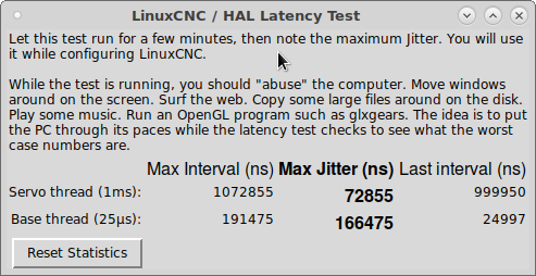

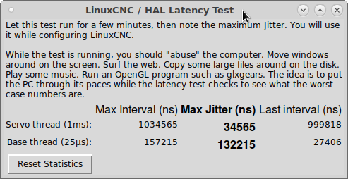

05 Jun 2019 06:21 - 05 Jun 2019 06:23 #135929
by Robert
Replied by Robert on topic 7i76e with ASRock Q1900DC-ITX
Hello,
I now have the Mainboard running and installed Debian 9 as shown by BigJohn. Big thanks to him.
Unfortunately the Jitter is pretty high. I could improve it a little bit by turning the CPU power savings, Audio, PCI etc. off.
Hopefully it will be sufficient as I will use the Mesa ethernet card and no software stepping...
PS: The values were measured with 3 windows of glxgears running for a couple of minutes, shifting them around rapidly, extending fullscreen

05 Jun 2019 06:35 #135930
Replied by rodw on topic 7i76e with ASRock Q1900DC-ITX
That jItter is fine for a Mesa card as you can ignore the base thread as it not used. Better than mine actually!

06 Jun 2019 00:33 #136009
by Hakan
Replied by Hakan on topic 7i76e with ASRock Q1900DC-ITX
Yes that will be fine, Do switch of the power saving stuff, but you don't need to disable anything else. A good combo.
