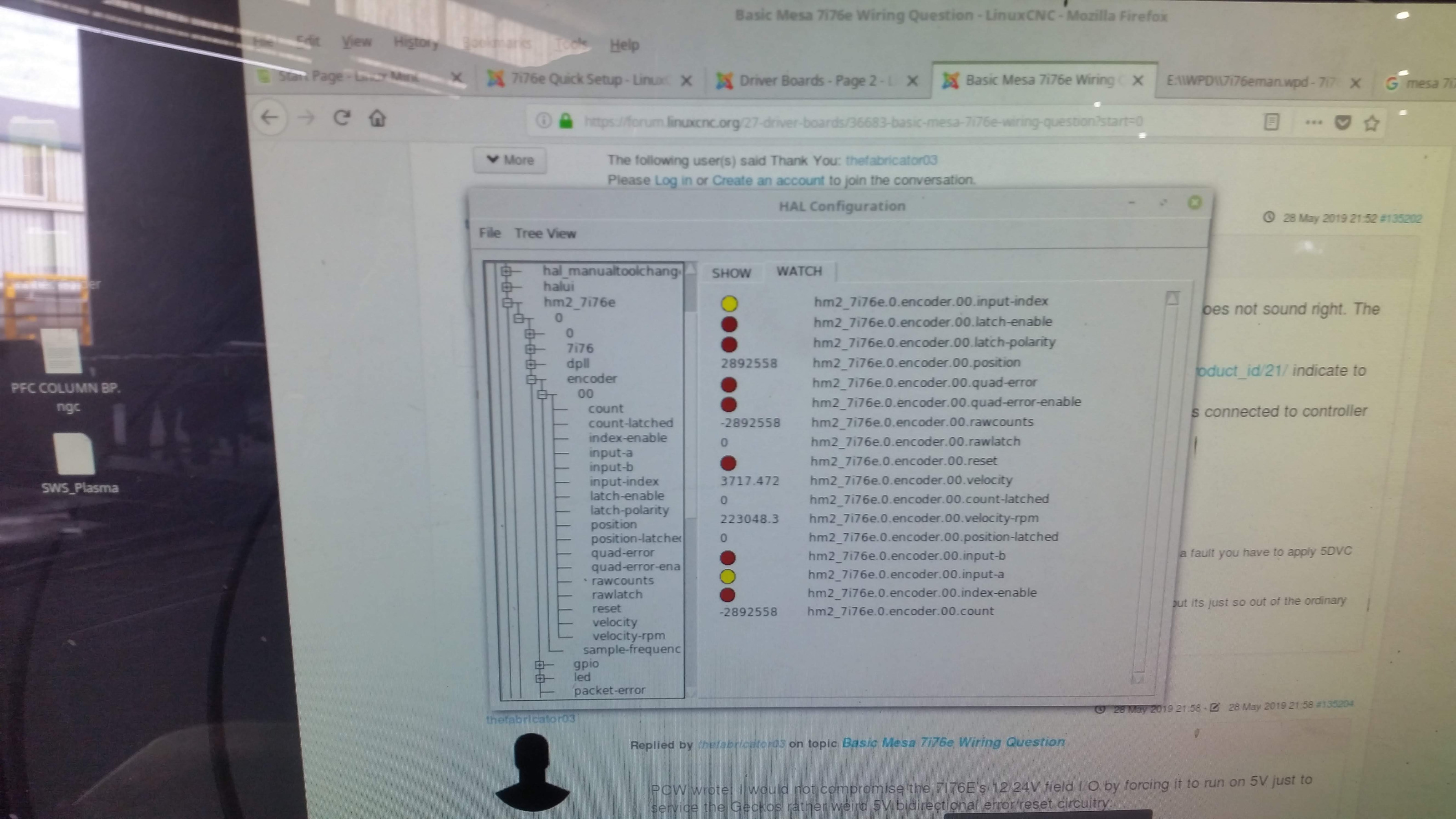

06 Jul 2019 23:27 - 06 Jul 2019 23:28 #138767
by thefabricator03
PCW,
I am trying to set up my drive fault detection from my Gecko 320X drives using the 7i76e encoder index pin to read the error/reset circuit as you suggested earlier in this thread,
I have wired TB3 pin 13 to link into the error/reset circuit and I have set W13 to TTL.
I cannot get the encoder input to change state in HAL Show when I apply power to the drives and when I fault them. Nothing under encoder changes in Hal show when I turn the drives off and on.

07 Jul 2019 10:32 #138803
Replied by PCW on topic Basic Mesa 7i76e Wiring Question
I think the 7I76E manual is wrong here. W10 sets the input mode for Index

07 Jul 2019 19:53 #138829
by thefabricator03
Replied by thefabricator03 on topic Basic Mesa 7i76e Wiring Question
I have changed the jumper settings and still cannot get anything to change state in the hal show,
What is I were to wire up the negative lead from the circuit to IDX- pin 14 on TB3 and set it to differential?
Will that work?
Will that work?

07 Jul 2019 21:25 #138833
No, because its unlikely that the Gecko can drive the termination resistor
I would first check that you can change the state of the index pin in hal by grounding pin 13 (it should be pulled-up to 5V with a 2K resistor on the 7I76E so should idle high)

08 Jul 2019 02:12 - 08 Jul 2019 02:13 #138841
by thefabricator03
Ok I checked Pin 13 by grounding it and it can be seen changing state in the Hal show.
Where do I look now? I really should of looked into the Gecko 320x more before I brought them, Its becoming a real pain in the ass to get these things to work properly.
Or maybe I am facing problems because the power supply for the reset/error circuit is coming from the drives themselves, would I be better off by wiring the circuit from the spare step and direction pins on the Mesa 7i76e?

- Posts: 18122
- Thank you received: 5337
08 Jul 2019 08:16 #138859
Do you have a common ground between the Gecko and the 7I76E?
You should be able to just check the Gecko output voltage relative to 7I76E ground
with a DVM
with a DVM

08 Jul 2019 16:11 #138894
by thefabricator03
I have checked and No I do not have a common ground, Is that all that my problem is? So wiring the circuit so that is has a common ground should solve the issue?
