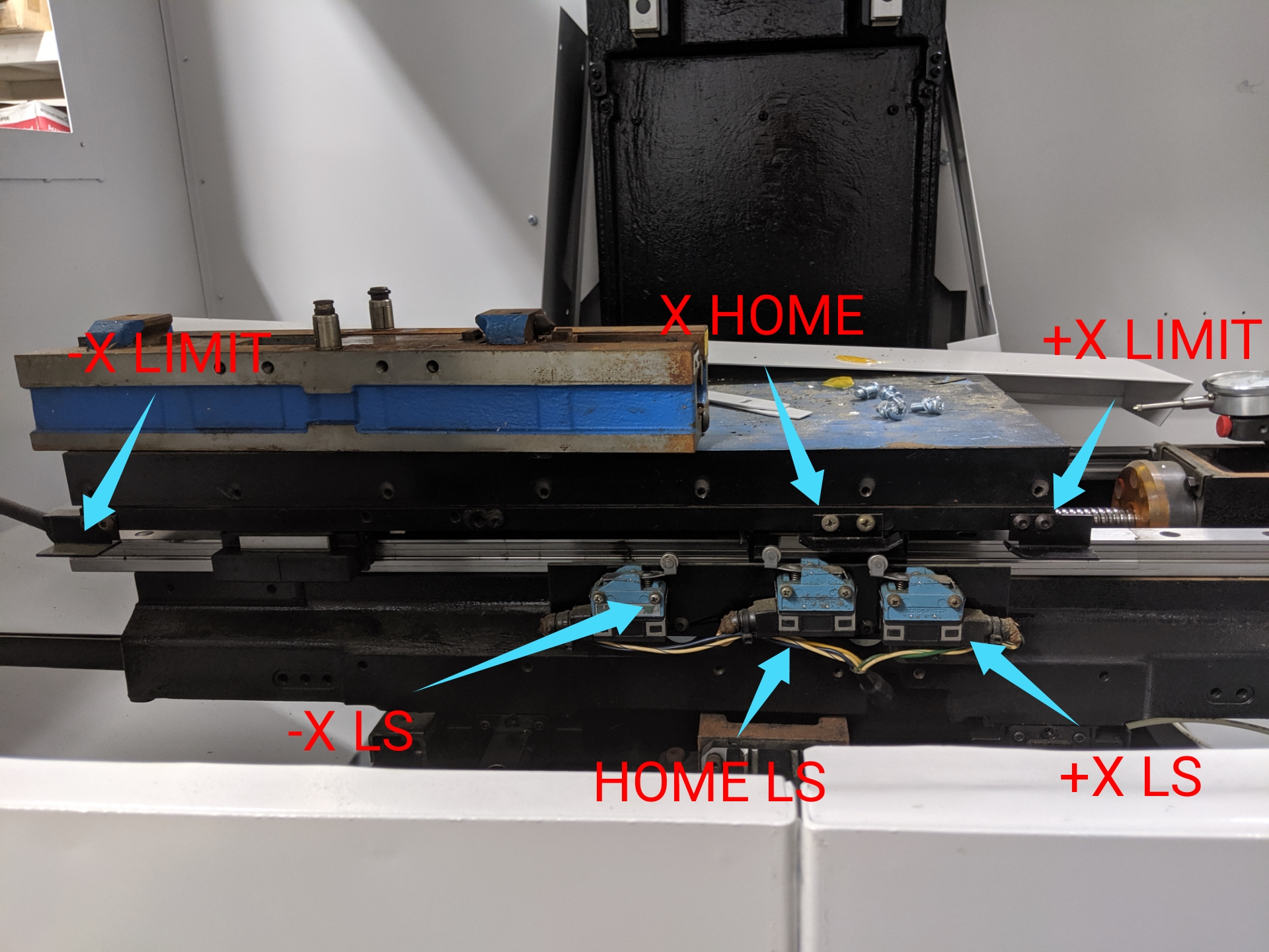

25 Jun 2019 23:33 #137861
by Type_Zero_Design
Replied by Type_Zero_Design on topic 7i76e limit switches
So I'm having a bit of trouble understanding the thought process of setting up the homing.
I guess it's a two part question one best practice two how to make it work.
I have attached a photo of my xaxis setup. So I'm wondering in this scenario should I leave my origin at the home switch or shift it to the end of my travel. I know in most cases I come accross when home on a mill the table is parked X+ Y+ end of travels. So I'm wondering do I shift my origin there and call that machine zero?
Second in the scenario I have in the photo what would be the recommended setup for my homing with origin offset, pos and neg travel, final home ect.? The total x travel is 15in. And the distance between the X HOME being triggered and X+ LS being triggered is 2.2in.

26 Jun 2019 12:55 #137918
Replied by Todd Zuercher on topic 7i76e limit switches
I don't think it matters, unless you design your g-code files in such a way that it does. Otherwise it is just personal preference. Homing for the Z axis and it's origin is another story.

27 Jun 2019 18:01 #138043
Replied by andypugh on topic 7i76e limit switches
As I see it your non-endpoint home-switch has the problem that the controller has no way to know which direction to move in to find the switch.
LinuxCNC can be set up to rapid to mid-travel once it has found the home switch at the end of travel. (My mill does this)
You current setup with a very long target for the home switch would work for linuxCNC, but as things are it looks like there are two zones on opposite sides of the switch where home-switch-state is false.

27 Jun 2019 18:19 #138048
Replied by rodw on topic 7i76e limit switches
So what Andy means is remake or reposition your home switch striker plate so the home switch stays triggered all the way until you hit the limits. Then LinuxCNC will then know which way to go to find the triggering edge. Currently if you home with the home switch on the right of the striker plate, it will crash into the limits..

28 Jun 2019 23:37 #138152
by Type_Zero_Design
That was what I was thinking. Unfortunately that is how the setup is from the factory on this machine and it's like this on all three axis.
Im not sure how this worked on the original setup as it never ran when I got it. I've been trying to think of some way I can work around this but I haven't come up with anything yet.

29 Jun 2019 02:30 #138163
From the photo, it looks like it would be real easy to remake or modify the home switch striker plate and use the existing mounting points.
