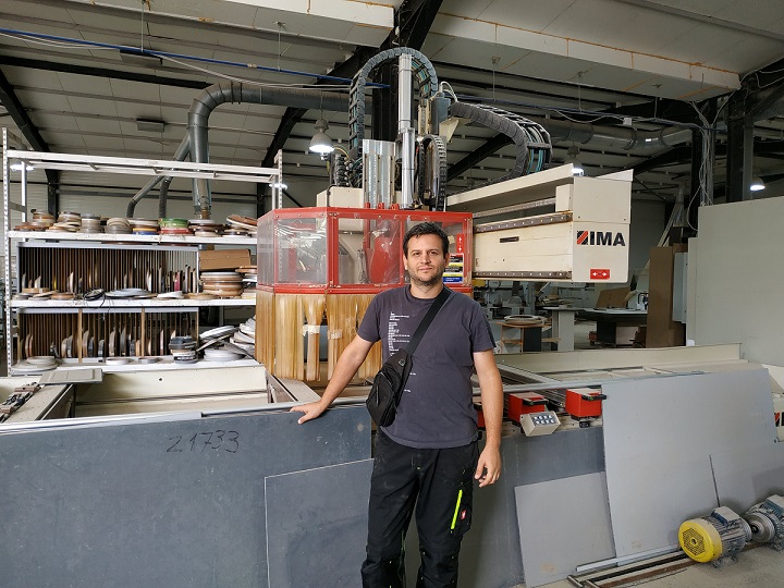

06 Sep 2019 08:19 #144378
by danilom
Replied by danilom on topic Recommendation for 7 axis and lots of IO
- Posts: 22030
- Thank you received: 7504
06 Sep 2019 10:43 #144392
Replied by tommylight on topic Recommendation for 7 axis and lots of IO
Yeah that needs a lot of IO's.
How many drives and how many VFD does it have ?
Most probably that does not need 7 axis control, it should be 3 or 4 if it has a circular saw that changes angles or a 90 degree drill/mill for side channels.
Usually they have a single VFD for 2 or 3 spindles, some have one for each spindle.
Does it have a tool changer ?
How many drills ?
Jesi to ti pored masine ?
Translation:
Is that you beside the machine ?
How many drills ?
Translation:

06 Sep 2019 14:02 - 06 Sep 2019 14:03 #144409
by bevins
Replied by bevins on topic Recommendation for 7 axis and lots of IO
Those machines always amazes me that an open ended gantry works....lol
I am just looking at the pic and its bending.
