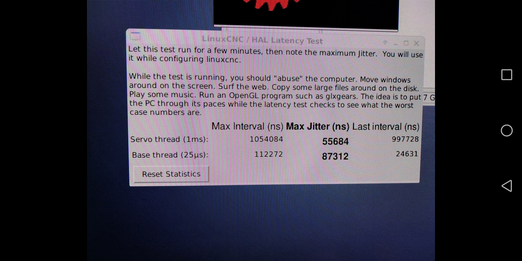

Hi guys
I'm starting Linuxcnc and of course, I'm assaulted by a lot of doubts. After a lot of reading and reading I am writing to you with the intention of confirming if my conclusions are true and with the hope that someone can guide me if I do not. I expose my situation: I have an old Intel Core 2.6 duo 2.6 GHz with 3Gb of RAM in which I have performed the live CD latency test (it throws me the values that I attach in the file) and I have performed satisfactory motion tests with the machine despite the results through parallel port and a BOB China.
So you comment here with a Mesa board the obtained numbers would not be any problem for an optimal and reliable operation but I would like a confirmation before acquiring them. The machine is composed of three Nema23 motors with their respective Tb6600 drivers. my intention is to work at the moment with 3 axes and their respective I / O and in the future to extend it to 5 axes and maybe a few Nema34.
I'm right? in the affirmative case I would appreciate guidance as to which license plate would be a good option to purchase and easier configuration.
Thank you very much in advance for the hassle and time of reading these lines.

Replied by PCW on topic Mesa card confirmation pls
Those numbers should be fine for any interface with hardware step generators
Mesa or otherwise.

good morning PCW.
I've been reading more in the forum and I think that as you mentioned in some thread the best thing as a novice is going to start with parallel port so I think a plugNgo kit of 5I25 + 7I76 / 7I76D of Mesa will be great for me given that allow up to 5 axes as I intend in the future and I see that there is enough documenting about them, especially the 5I25, how do you see the idea? the only doubt I would have is the difference between 7I76 and 7I76D I do not know what exactly you mean by sourcing and sinking, can you tell me about it?
