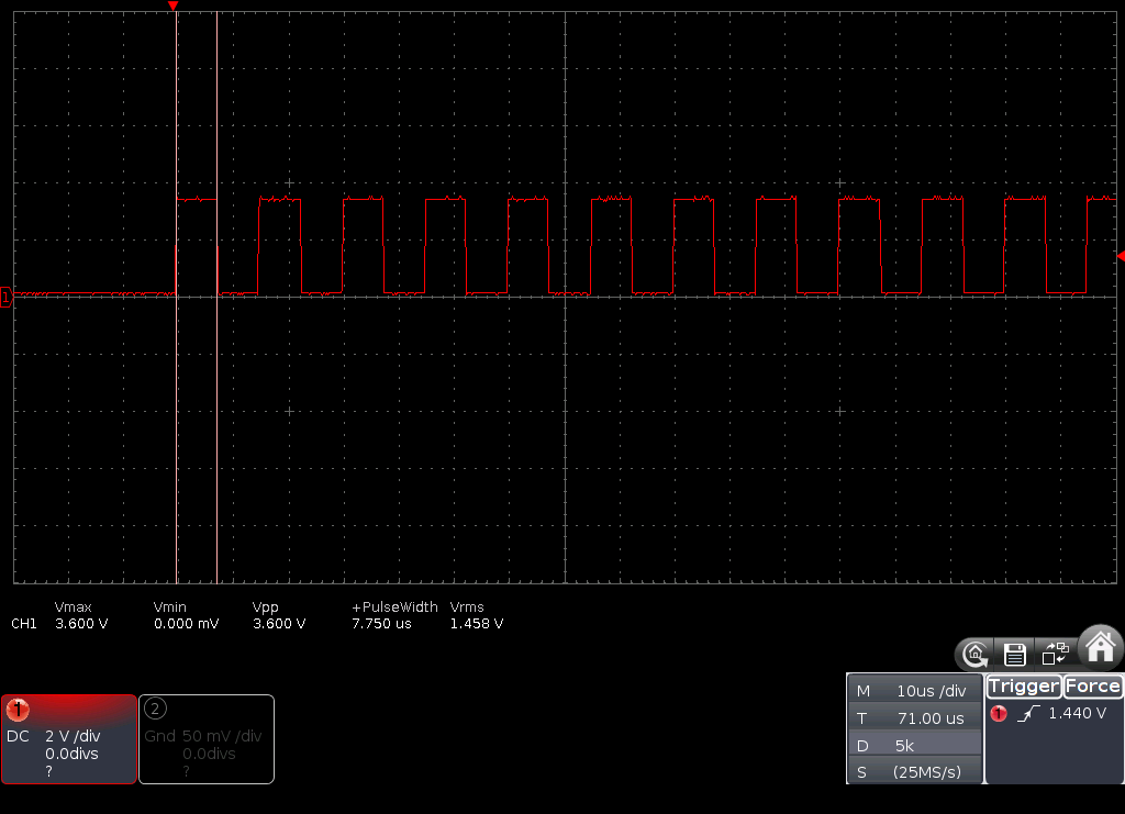

So it appears that SS does do some sort of initiation on startup. I can get it to dump the startup to /var/linuxcnc.log and verify it prints "sserial version 0". I was wondering if sserial being from too old a version or missing sserialremote.vhd's could be the problem as these versions are older and those .vhd's are missing.
I have scoped and serial probed the transmit line on startup and can verify the Tx pin is sending some message. It's probably about 16 or so 7.75us pulses which I suppose suggests it's at a baud rate of 115200 but I get more substantial (i guess) serial messages at 230400.
Also I was wondering what "MuxedQCount" is used for, looks like it's used for an encoder like Qcount. Is that where the FPGA would accept differential signals directly rather than using an external differential receiver?

The fact that it reads 0 as a version number means there is likely something wrong with the firmware source.
That is, the driver cannot communicate with the embedded CPU that manages he communications.
There never was a released version 0. I would expect version 43 if the source is less than 5
or so years old.
The initial baud rate should be 2.5 MBaud (400 ns per bit) I suspect something wrong with the clock
generation (the actual hardware clock does not match the CLKMED constant)

Just so it's clear to me, the pinfile specifying "version 0" and "ClockTagLow" has nothing to do with the actual printed version and the CLKMED constant you mentioned right? This is pretty much how all pinfile examples I've come across are setup.
Probably silly questions but programming is not my thing. Just wanna make sure I didn't set it up wrong before I write it off as something that's out of my control.

The version numbers in the pinout file are hardware versions of the individual modules.
The sserial version that the driver reads out is the software version (of the code that runs on the sserial interface CPU) This should be 43 decimal, reading 0 probably means that the CPU is not responding or some other bitfile /firmware issue
