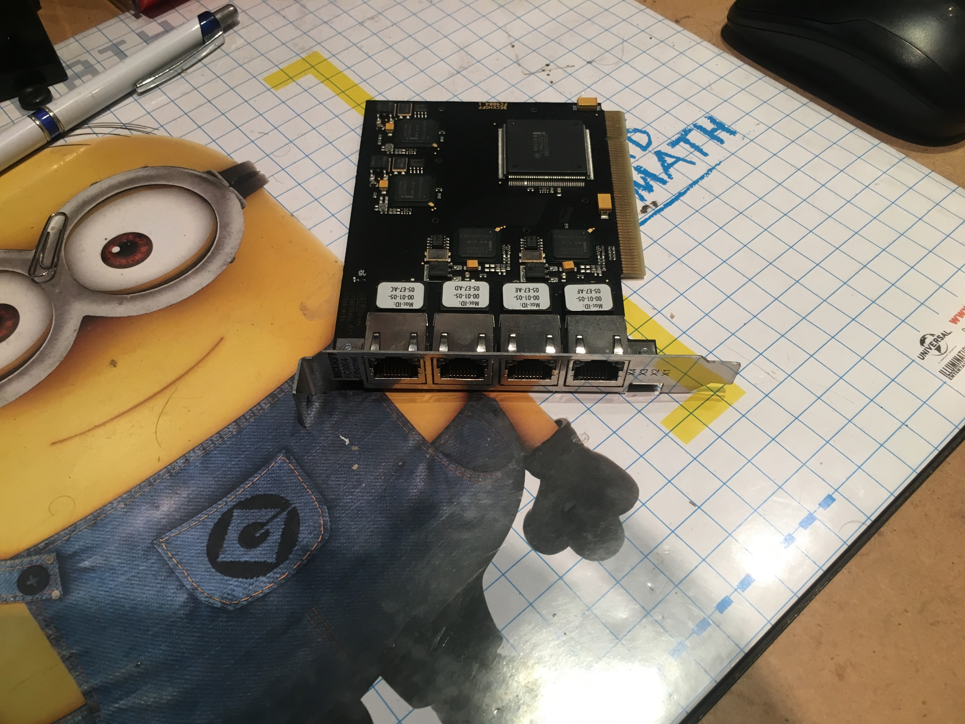

Missing a little information for those who do not know, the network "MASTER1" must be specified in the file "/ etc / default / ethercat" then apply the changes "update-ethercat-config", the network card will find it together with the number "serial" using the command "lshw -c Network.
the tests were with the BECKHOFF FC9004 network card
regards
Chimeno
