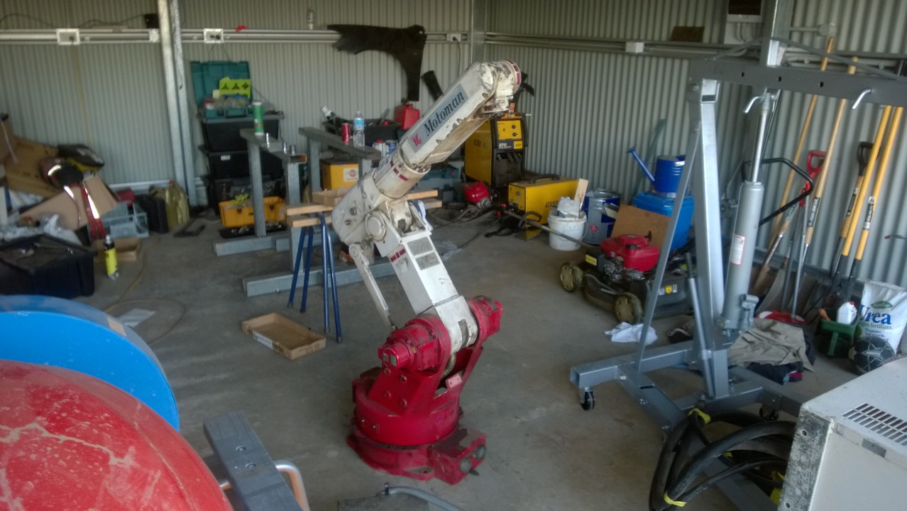

Hi Guys,
I am about start to finish the retrofit of one of my old welding robots,
The motors on the robot are Yaskawa AC servos from the early 90's. Interfacing them to Linuxcnc would be a major job because of the proprietary encoders on these drives.
Ideally I would like to replace the whole motor with ethercat AC servos but six motors and drives add up to the tune of $4000 USD.
So my next solution is to replace the encoders and use new drives to control them.
My question is about control signals, Is there any performance difference between the different control methods. The DMM drives I am using, www.dmm-tech.com/Dyn4_main.html, support many different control types, Step/Direction, Analog command and CW/CCW.
Is there a reason I should chose one method over the other?

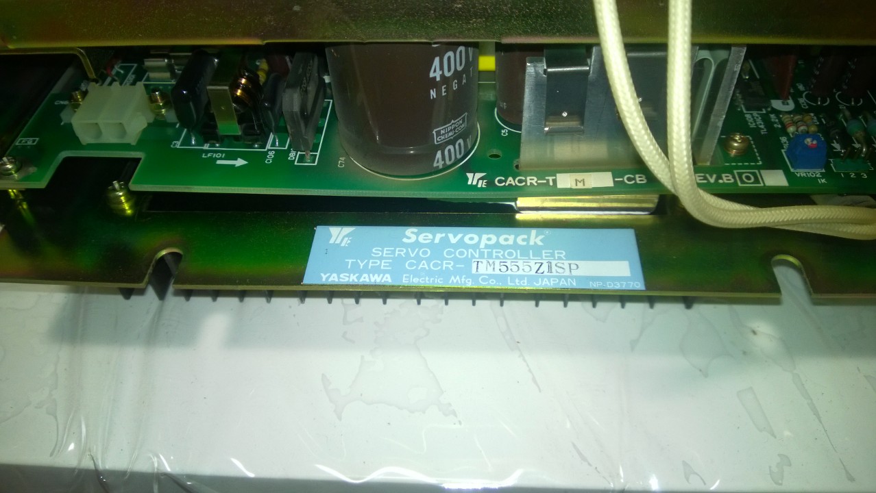

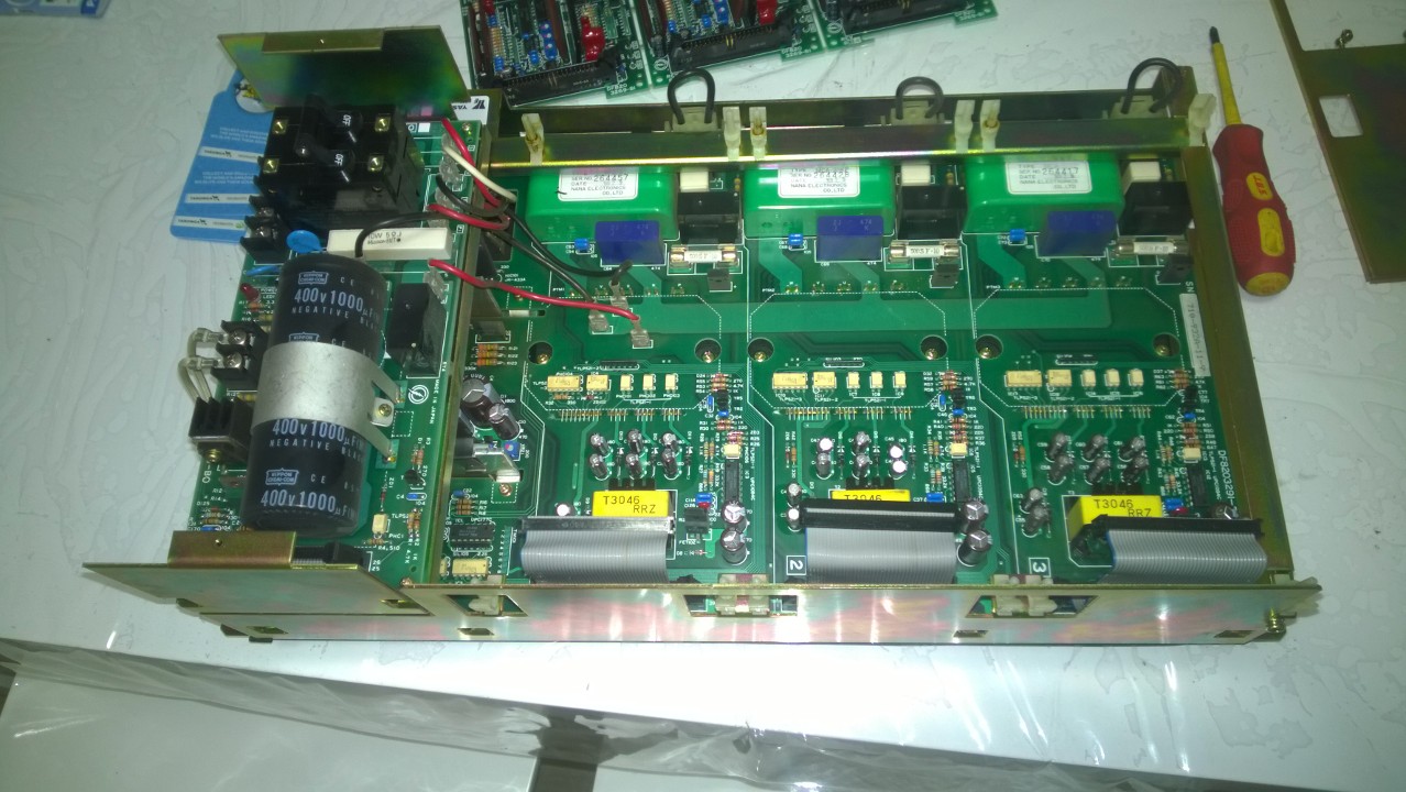

This is one of two servo control boards,
As I said early 90's vintage, I dont want to be dealing with electrical gremlins from electronics that are as old as I am.
Mounting new encoders and using the existing motors is surprisingly easy, The new drives have software that I can set the parameters of the motor.
From my research the absolute encoders on these motors output a very specific pulse that only the Yaskawa drives can decode.

07 Sep 2019 04:49 #144449
by bevins
Replied by bevins on topic Step-Direction vs Analog Command vs CW/CCW Signals
I have been using CACR yaskawa drives in two of my machines and they have never failed once. Just saying, they are built pretty robust. Every CACR drive I have seen has quad encoder output. doesnt hurt to try.
