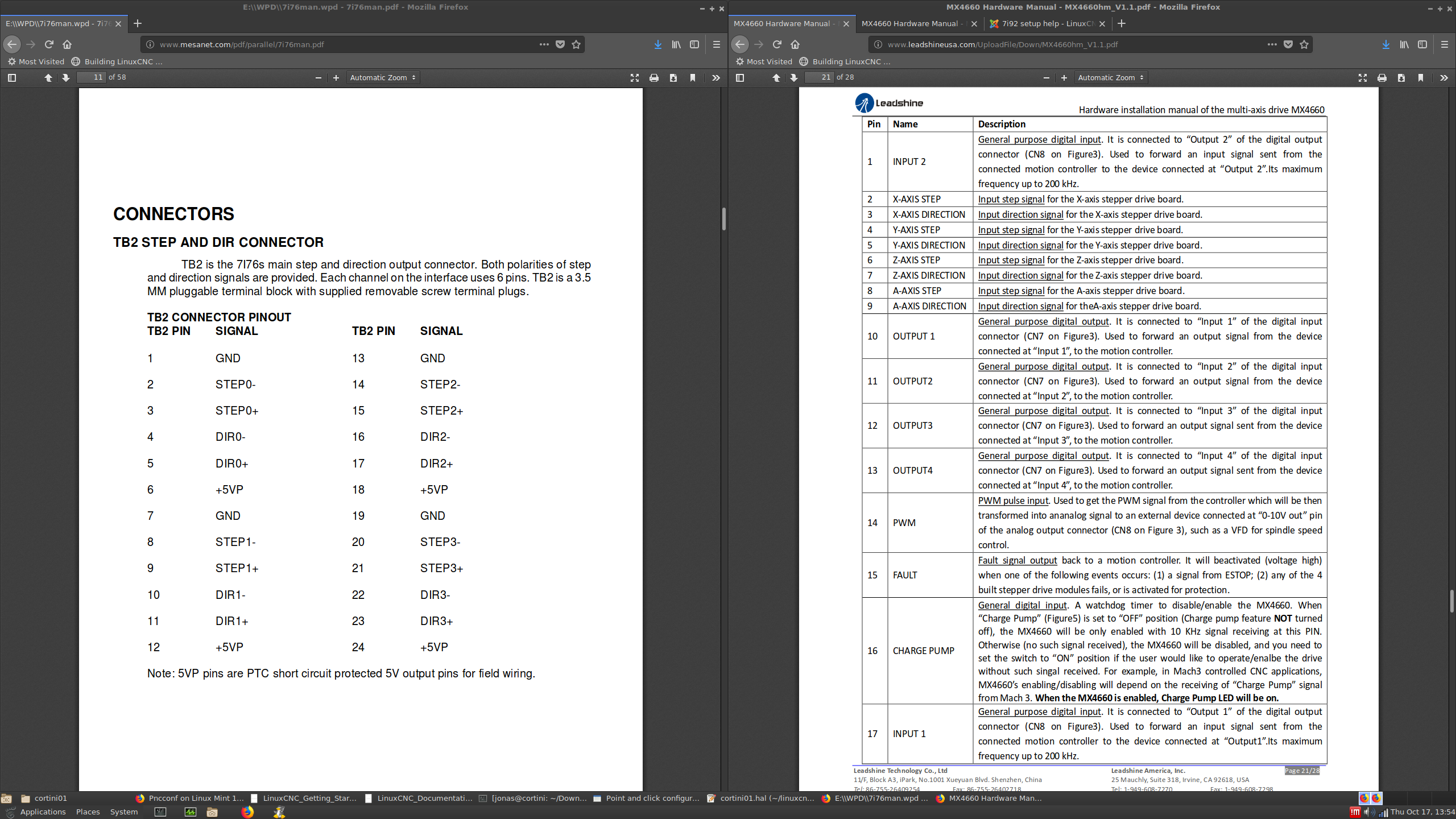

Just to throw an alternative in to the pot... You could cut one end off of a parallel port cable and individually wire the MX4660 inputs to a 7i76 step/dir and IO pins.
I have now exchanged the 7i74 & 7i84 for a 7i76.
It's not clear to me on how to connect the step and direction pins. If you see on the screenshot below from both manuals, the 7i76 has got for output step+, step-, dir+, dir-; but the MX4660 only have one step and dir input per axis.
How do I connect the wires? Right now I've connected step to step+ and dir to dir+, and nothing to step- and dir-.
Latency issues are solved btw.
EDIT: Went through the manual again and found this section. Must have missed it first time...
STEP/DIR INTERFACE
The 7I76 provides five channels of step/dir interfa
ce with buffered 5V differential
signal pairs. Each differential pair consists of tw
o complementary 5V outputs. The
differential signals allows reliable signal transmi
ssion in noisy environments and can
directly interface with RS-422 line receivers. Step
motor drives with single ended inputs
connect to just one of the STEP and DIR signal outp
uts, that is either the STEP+/DIR+ or
STEP-/DIR- signals, with the unused signals left un
connected at the 7I76. The input
common signal on drives with single ended inputs co
nnects to the 7I76s GND or 5VP pins
depending on the drive type.
Last edit: 17 Oct 2019 12:15 by jonch919.

17 Oct 2019 12:15 #148113 by tommylight
Replied by tommylight on topic Help choosing a good card setup
7i76 mxwhatever
Gnd gnd
Step+ step input
Dir + dir input.
That should work.
