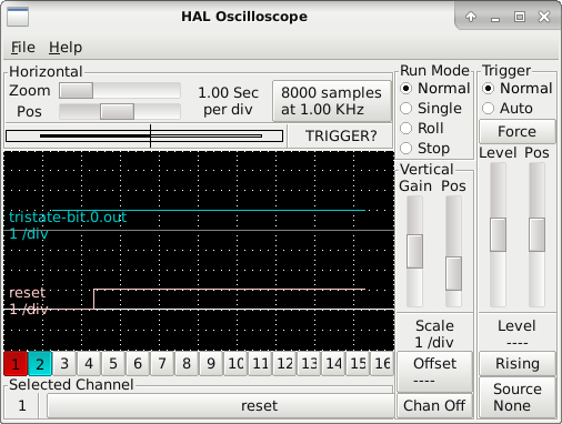

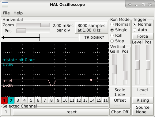

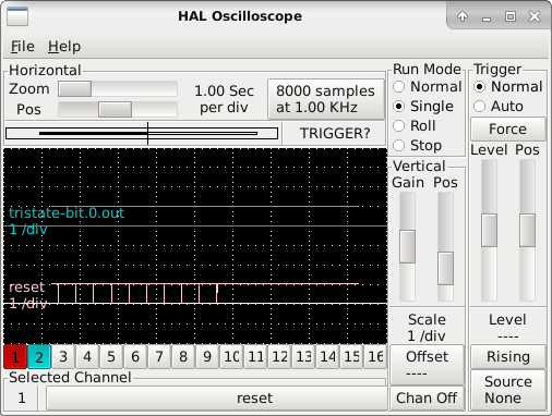

08 Oct 2019 15:07 - 08 Oct 2019 15:07 #147466
by JC10
Replied by JC10 on topic Test index of rotary encoder with hal only
I tried to toggle but was not successful with your code added as follows :
With halmeter, I observe that index-enabled is always set true so the code works.

Here is the HAL corrected I ran including your code :
The "reset" signal observations with halscope show unexpected behavior.
I used halscope in Run mode : single and Trigger : normal + force.
I made a first record #1 where we observe that "reset" is raised to 1 but is not set back 0 after one cycle as expected.
Then I made a second record #2 where "reset" remains at 1 except when set back to 0 periodically for one cycle, I guess when the index is detected by 7i92 as i am rotating the rotary shaft.
I checked the code as follow and for me it should work, except some unexpected behavior on index-enable that is input and output for 7i92 or something else I ignored
I removed the toggle to focus on the signal reset.
loadrt hostmot2
loadrt hm2_eth board_ip="10.10.10.10" config=" num_encoders=1 num_pwmgens=0 num_stepgens=0 sserial_port_0=0000xx"
loadrt threads name1=servo-thread period1=1000000
loadrt not
loadrt tristate_bit
addf hm2_7i92.0.read servo-thread
addf not.0 servo-thread
addf tristate-bit.0 servo-thread
setp tristate-bit.0.in 1
addf hm2_7i92.0.write servo-thread
net enable hm2_7i92.0.encoder.00.index-enable tristate-bit.0.out not.0.in
net reset not.0.out tristate-bit.0.enable

The middle plot looks as expected, what do you see thats wrong?
I think that there is possibility of missing indexes on reversals
(with less than a few servo periods between indexes)
but this is not an issue with normal index use

For me it looks inverted compared to what we expect according to what I determined by running your code on paper as in my previous post and especially according to your post here above :The middle plot looks as expected, what do you see thats wrong?
When I rotate the shaft, I only rotate in the same direction.The "reset" signal will be set for one servo thread period every detected index
