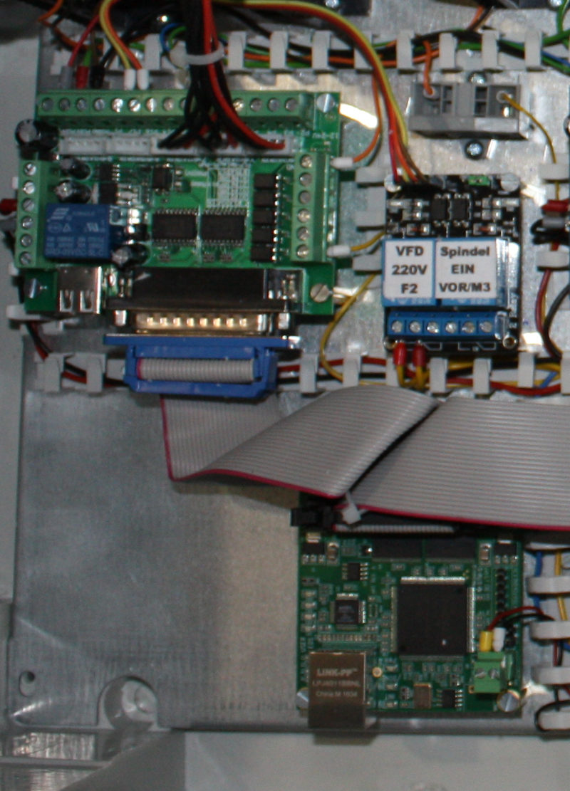

hi i faced the same problem on my 5Axis maschine
i decided to go for the Arduino extend boards they got inverted relay on
so there is no factor with the 7i92
see the video
here is the image and the HAl code
the Video on wirer and connect the relai
see the video
# external output signals
#steuerung ein Freigabe Blue BOB PIN 17 7i92m GPIO 024
setp hm2_7i92.0.gpio.024.is_output TRUE
setp hm2_7i92.0.gpio.024.invert_output TRUE
setp hm2_7i92.0.gpio.024.out TRUE
# 48v EINSCHALTEN e-STOP relay Blau pin 16 Relay GPIO 22
setp hm2_7i92.0.gpio.022.is_output TRUE
setp hm2_7i92.0.gpio.022.invert_output TRUE
net estop-out => hm2_7i92.0.gpio.022.out
# VFD220V freigabe EINSCHALTEN e-STOP relay Green pin 17 Relay GPIO 07
setp hm2_7i92.0.gpio.007.is_output TRUE
setp hm2_7i92.0.gpio.007.invert_output TRUE
net estop-out => hm2_7i92.0.gpio.007.out
# Spindel Forward M3 relay Green pin 16 Relay GPIO 05
setp hm2_7i92.0.gpio.005.is_output TRUE
setp hm2_7i92.0.gpio.005.invert_output TRUE
net spindle-cw => hm2_7i92.0.gpio.005.out
#spindel vfd ramp
setp hm2_7i92.0.pwmgen.pwm_frequency 400
setp hm2_7i92.0.pwmgen.00.scale 24000
setp hm2_7i92.0.pwmgen.00.out0.invert_output True
setp hm2_7i92.0.pwmgen.pdm_frequency 6000000
setp hm2_7i92.0.watchdog.timeout_ns 10000000
net spindle-speed-cmd spindle.0.speed-out => hm2_7i92.0.pwmgen.00.value
net spindle-on spindle.0.on => hm2_7i92.0.pwmgen.00.enable
#loadrt pwmgen output_type=0
#addf pwmgen.update servo-thread
#addf pwmgen.make-pulses servo-thread
#net spindle-speed-cmd spindle.0.speed-out => pwmgen.0.value
#net spindle-on spindle.0.on => pwmgen.0.enable
#net spindle-pwm pwmgen.0.pwm => hm2_7i92.0.pwmgen.00.value
# Set the spindle's top speed in RPM
#setp pwmgen.0.scale 24000the Video on wirer and connect the relai
