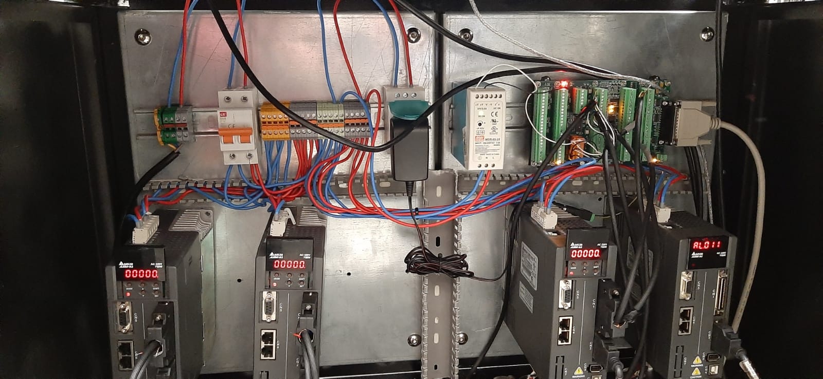

Your pid tutorial was perfect until we tried to achieve rotary delta kinematics with encoder scale. Could you suggest an article about scaling like yours "Servo Tuning detailed How To". I thought you may write about scaling but I could not find. Or you may give some tips. Even I could not find encoder pulse countings to check how many pulse equals to one turn.

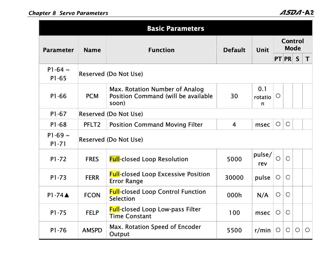

When I set encoder scale 100, G0 X 100 command turns 1 turn. Thank you. This was my first meaningful movement in LinuxCNC. But isnt it so small for a servo. I find a full closed loop resolution parameter in ASDA-A2 manual. It is P1-72 and 5000 as default. I expected 5000 as encoder scale.

If the encoders are 5000 ppr, the setting in the ini file should be 20000 due to quadrature nature of the signal.

I changed encoder scale to 20000. Servos jumped when I power on on the LinuxCNC
