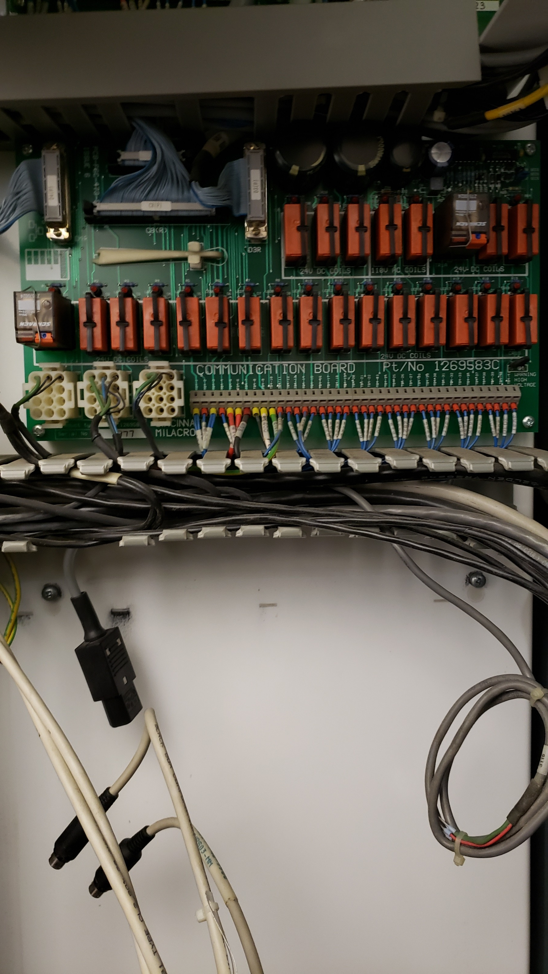

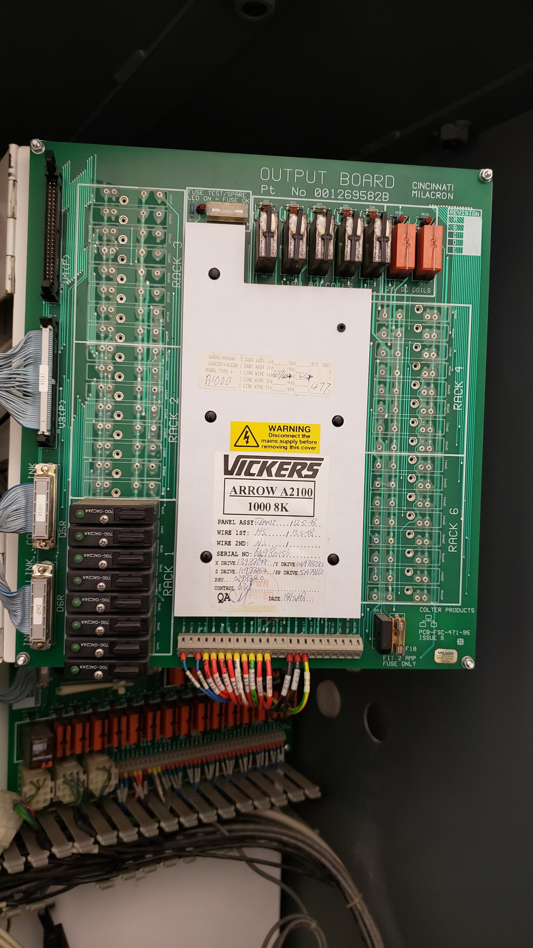

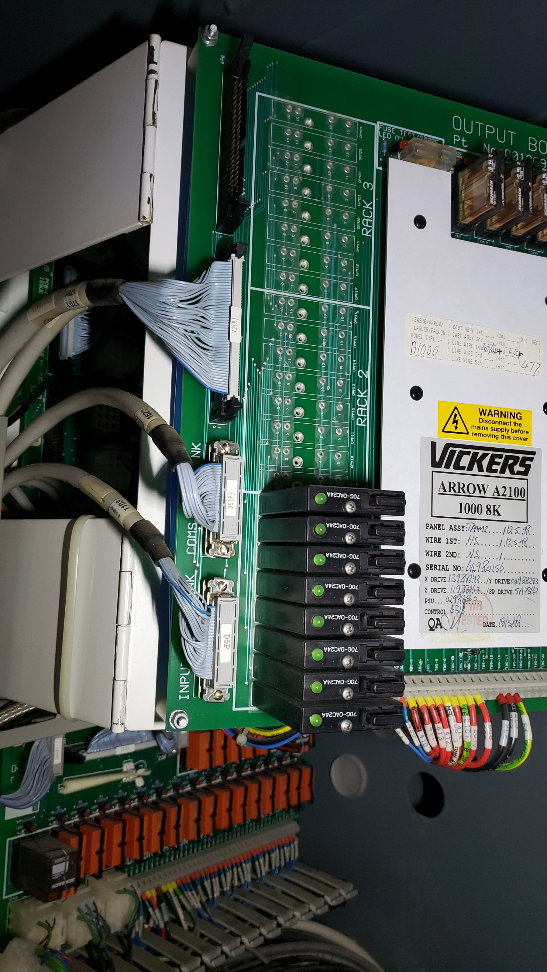

- Thods1222
- Posts: 40
01 Feb 2020 15:54 #156306
by Thods1222
Replied by Thods1222 on topic Mesa board advice
- Posts: 22025
- Thank you received: 7499
01 Feb 2020 19:24 #156314
Replied by tommylight on topic Mesa board advice
Those are relays, not optos.
One of the boards says 24V coils.
The following user(s) said Thank You: Thods1222
