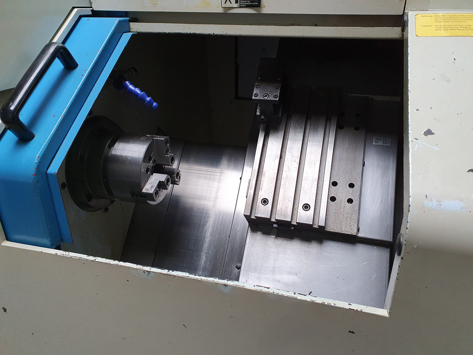

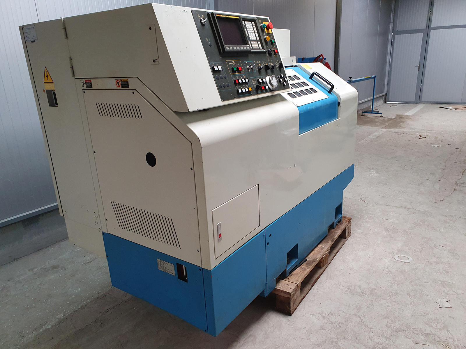

I would be grateful if someone could help me with the choice of Mesa cards for my CNC lathe. I have experience with LinuxCNC but have never used any Mesa cards.
I have an slant bed 2 axis lathe (X 220mm * Z 220mm) and wish to make retrofit , to add AC servo motors (1500W) step/dir and YASKAWA A1000 inverter for main spindle.
I wish to add linear optical scale resolution 0.001mm only to X axis to have good accuracy and use Index signal for referencing / homing, this scale will be closed to LinuxCNC feedback, not to servo drive (dual feedback).
I need some I/O cards with enough inputs for front panel to use for MPG, feedrate, spindle override, chuck control and others.
Also a suggestion which type of PC for LinuxCNC to choose.
Thanks in advance!
Thanks in advance!

18 Feb 2020 12:08 #157710
by nikanor
Thank you for your recommendation!
On that machine are the Fanuc AC servo motors A06B-0128-B077 with incremental encoder with serial output but I have no experience with Fanuc and want to install other AC servo motor & drive for ease of maintenance.
This lathe will be used only for ball-screw end machining and nothing others but need to be accurate for bearing mount with tight tolerance.
Replied by nikanor on topic Which Mesa cards for CNC lathe
Nice machine.
I would try to use the existing motors and drives if at all possible, and those would most probably be +-10V analogue ones, in such case a mesa 5i25 or 6i25 or 7i92 coupled with a 7i77 would work nicely. Used that on a lot of retros.
For step/dir and scales maybe someone else has a better solution.
