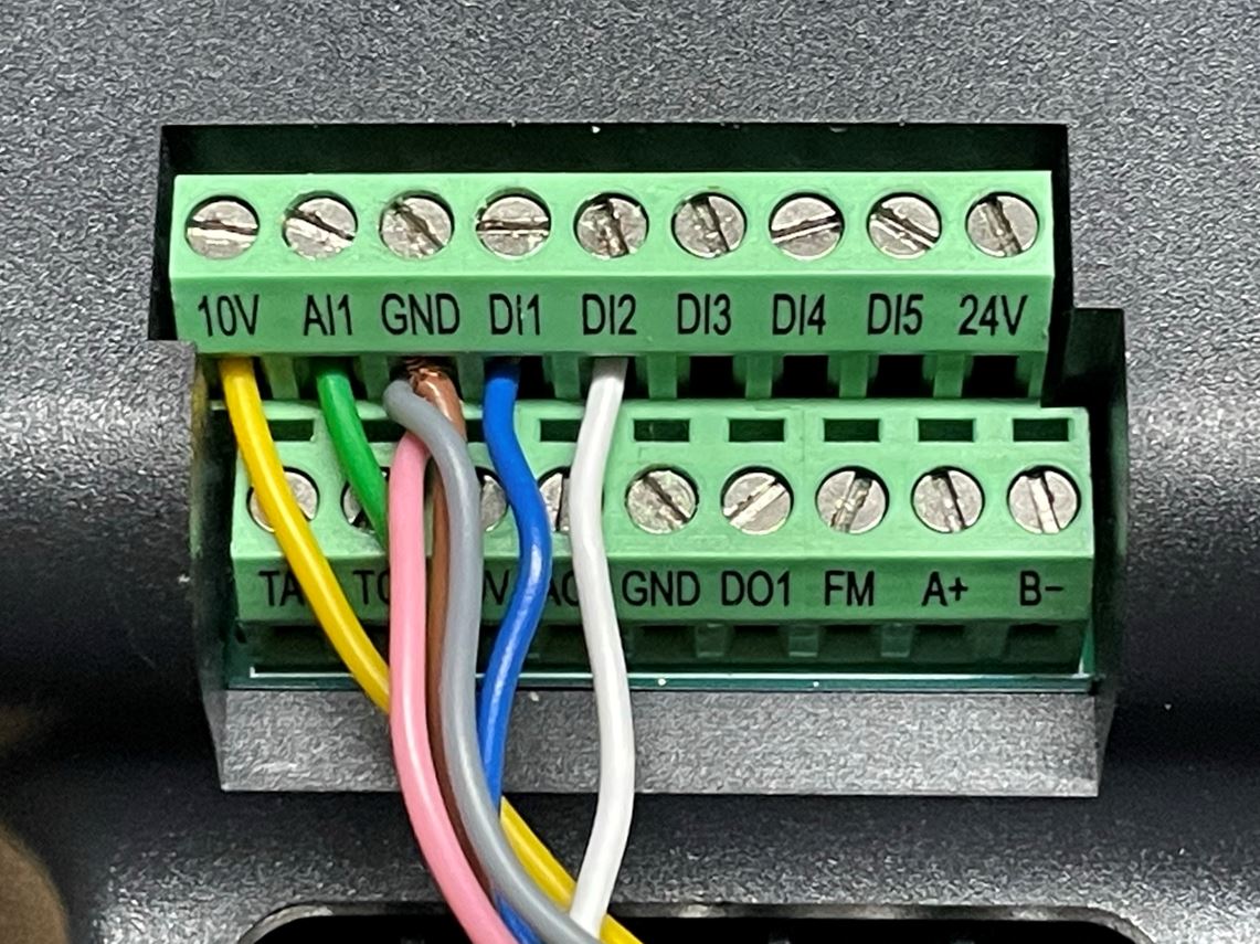

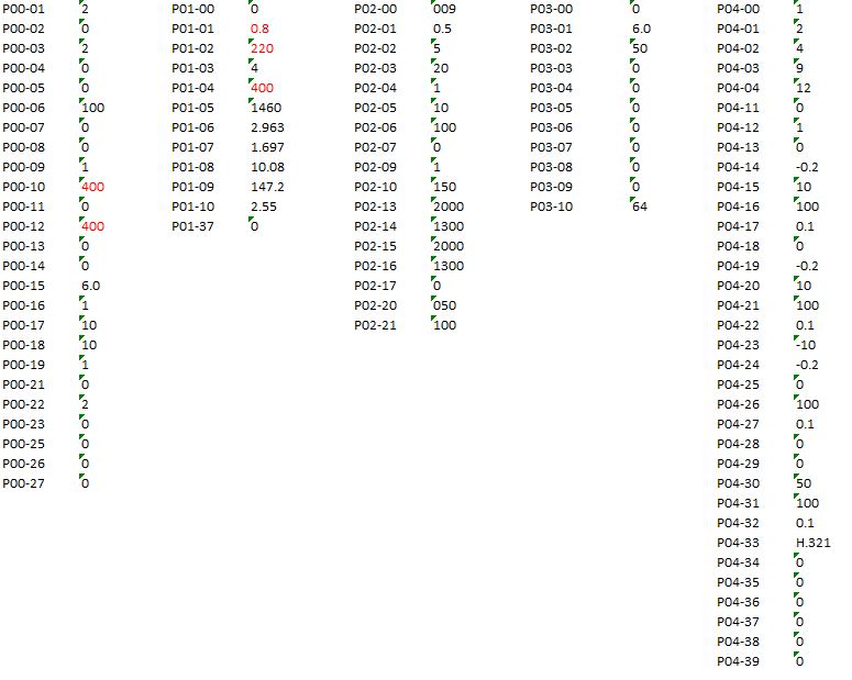

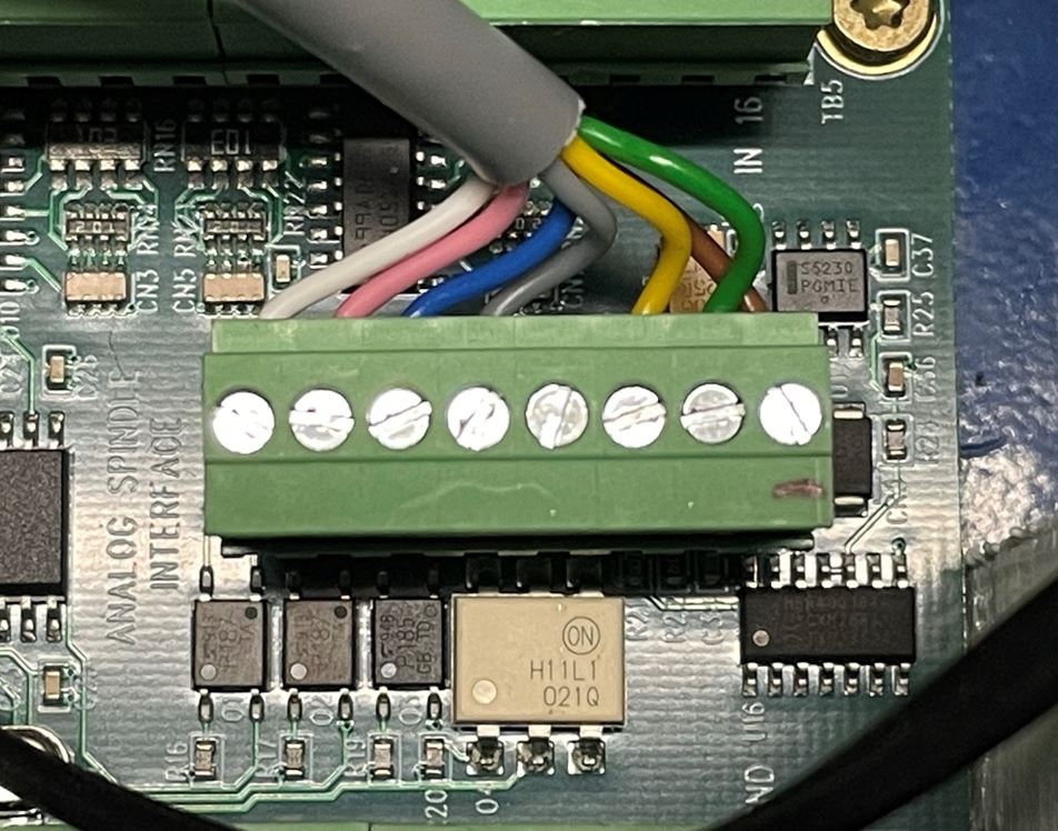

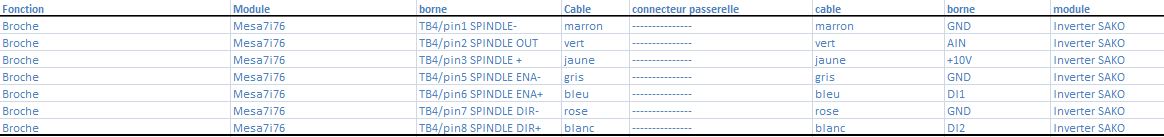

12 Dec 2021 10:39 - 12 Dec 2021 10:42 #228910
by Kadrick
Replied by Kadrick on topic 7i76e vfd connection issues
Thanks for this helpful topic.
I just want to complete a little for help other persons.
My setup:
Mesa 7i76
SAKO SKI780
Spindle 800W RATTM (220 V, 24000 tr/min, 400Hz)
SAKO SKI780 setting:
point in red are specific to my spindle.
wiring:
abstract of my .INI:
supplier of spindle said me that I cannot use spindle below than 9000rpm.
then OUTPUT_MIN_LIMIT is 9000
My setup:
Mesa 7i76
SAKO SKI780
wiring:
Last edit: 12 Dec 2021 10:42 by Kadrick.
