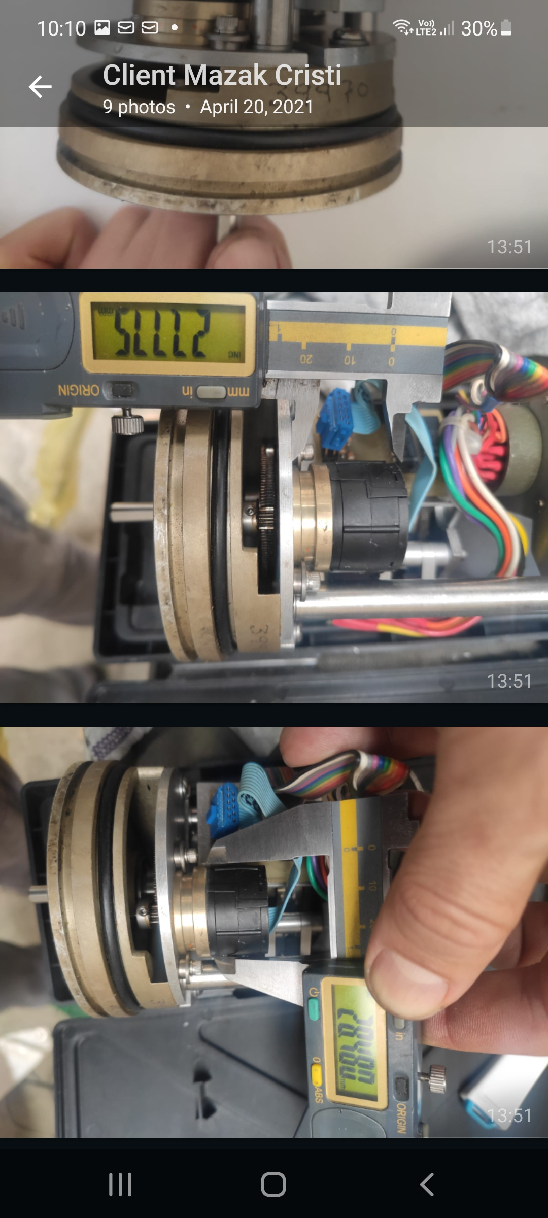

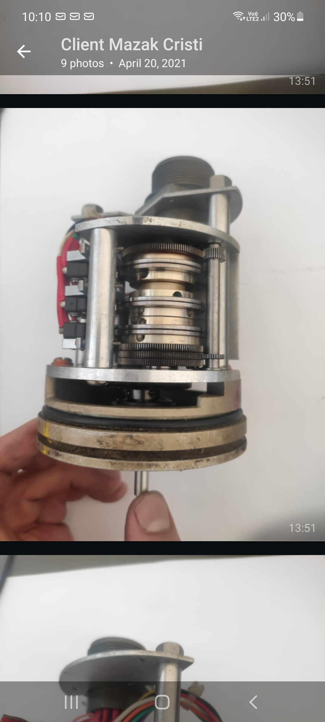

The encoder in the picture doesn't look like an RLS Rolin. In fact it looks an awful lot like a resolver.
- jmelson
- Posts: 520
- Thank you received: 126
02 May 2021 00:04 #207593
by jmelson
Replied by jmelson on topic Linuxcnc with RLS rolin encoder.
Yes, it is a Harosyn resolver, made by Harowe Controls. I can read enough of the label to be sure of the ID.The encoder in the picture doesn't look like an RLS Rolin. In fact it looks an awful lot like a resolver.

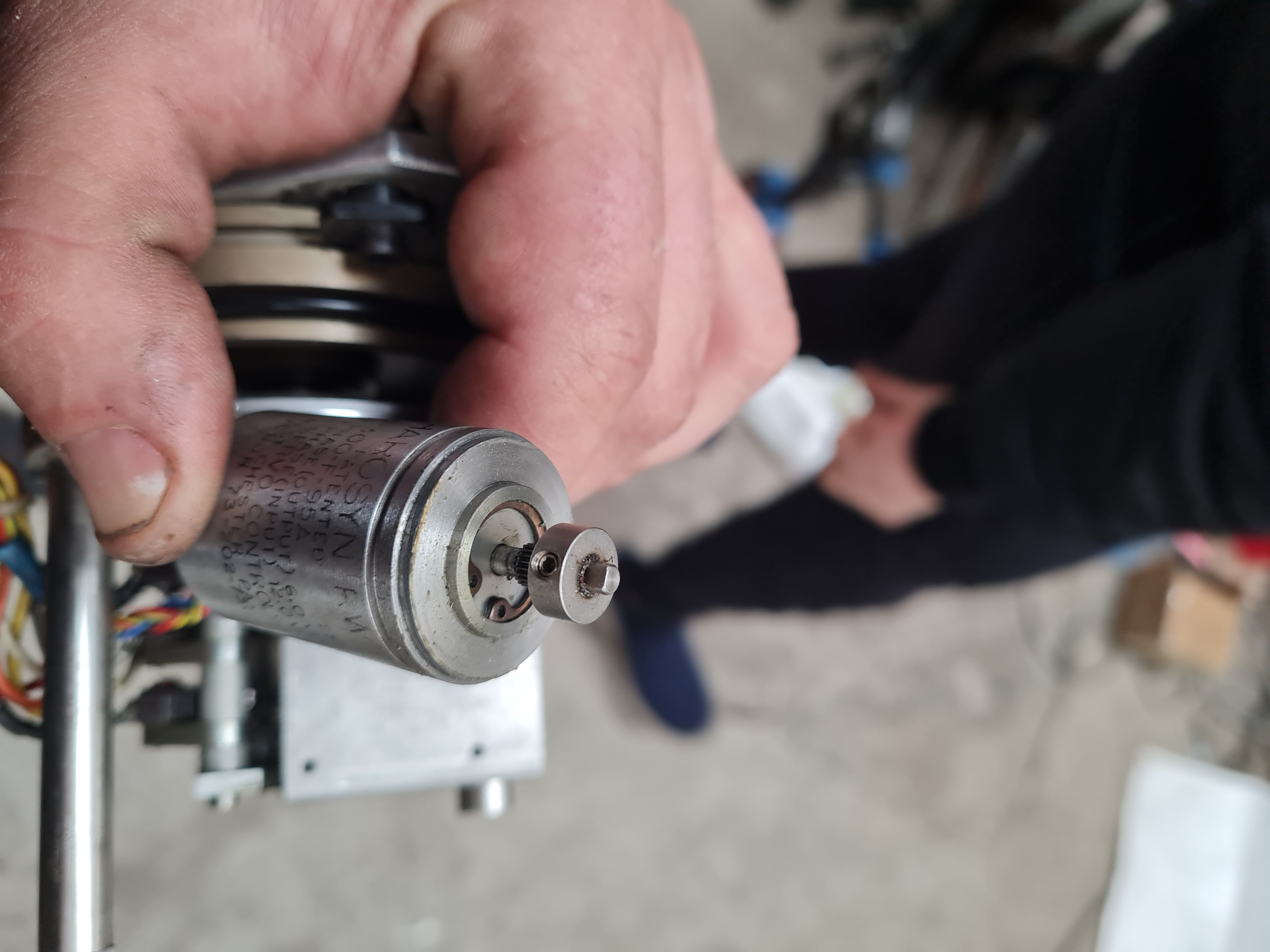

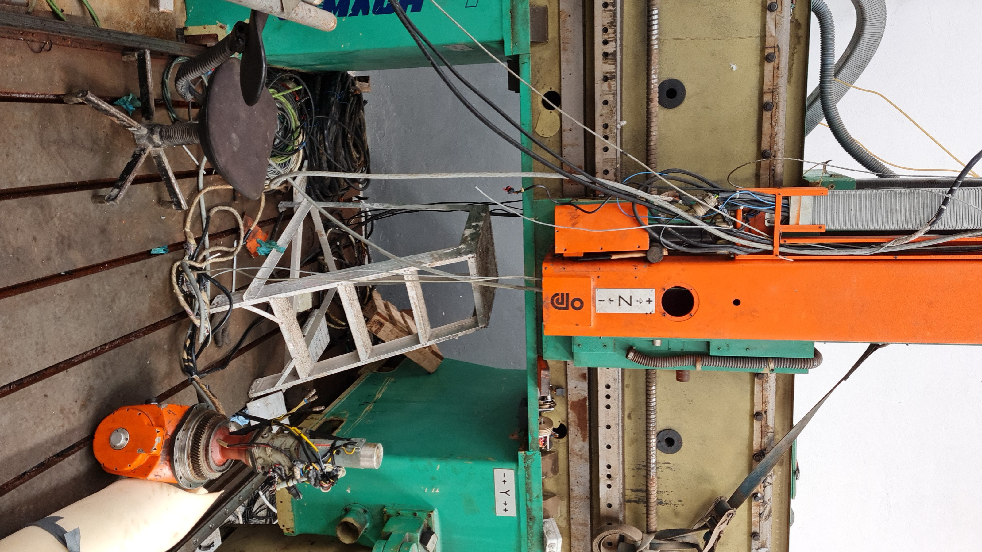

Sorry I did not explain correctly.
It has this strange , hard limits and refernace divice attach to 3 encoders on xyz and 2 resolvers on AB. I want to change the resolvers and the encoders with a RSL encoders on all axis. RL22 8000ppr encoder incremental and mount on this device and use refernace. Or giveup this divice and use absolute.

Those encoder units really do look rather special. In what way do they not meet your requirements?
Looking back at earlier [psts it seems that the Rolin encoders output SSI? That should be usable, but it's a bit of an investment to find out.

Very interesting device. It appears to have some anti-backlash gearing, cams and microswitches, and something black that looks a lot like an old HP HEDS encoder.
The 10-conductor blue ribbon cable looks REALLY familiar, I have some similar units.

It reminds me of the old GE resolver units. Course, medium, and fine to generate an absolute position through the gearing.
