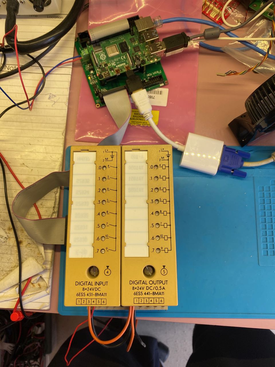

I decided to use 1 x 6ES5 431-8MA11 (8xDigIn 24VDC opto isolated) and 1 x 6ES5 441-8MA11 (8x24DC 0.5A Dig Out).

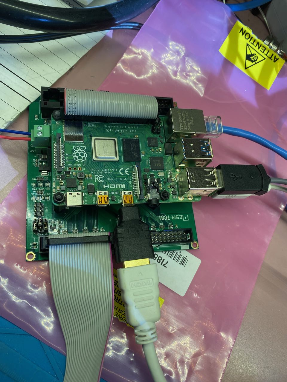

Here are a couple of pics to show the Siemens modules connected to the 7C81 (inc. Raspberry Pi):

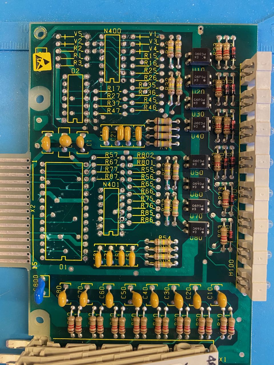

To modify the Siemens Input module I first removed the bus decoder circuit which then leaves only the 24V inputs with opto couplers:
The next step was to decide which pin of the edge connector pins to assign to the anything IO interface. I decided on this layout (from the top of the card):

The track I was using for IO 6 had to be cut on PCB as it was going to a ground connection.

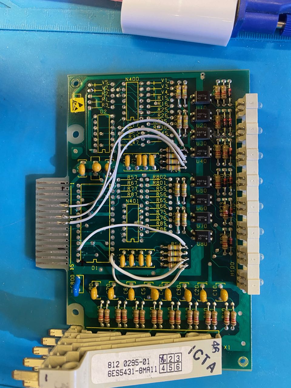

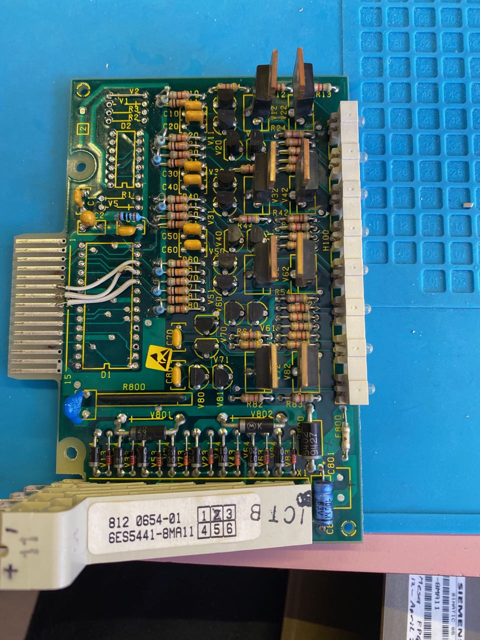

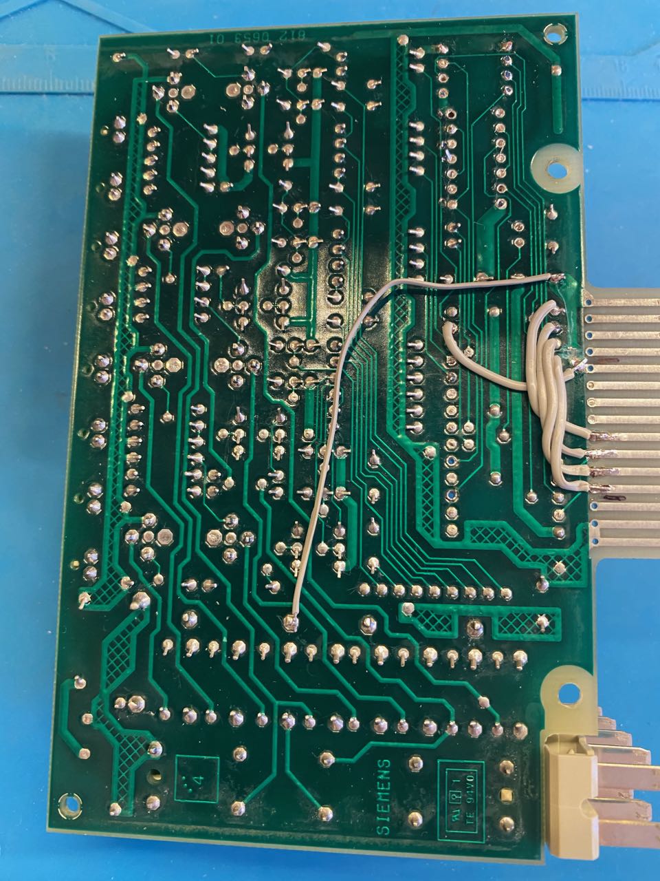

The last step was to install wire links from the edge connector to the opto coupler outputs, one per IO channel:

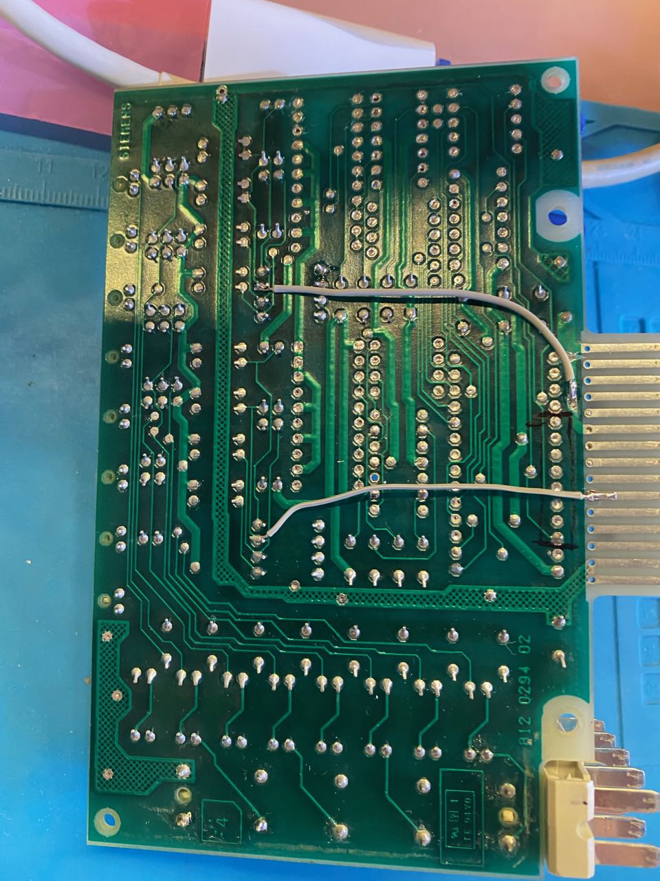

The output module was slightly more challenging.
Bus decoder circuit removed, same track cut as on the input module, Diode V2 replaced with a wire link and a bride from the Anything IO supplied 0V to the external (24VDC) supply negative connection (longest bridge on the bottom of the PCB).
8 x 1K pullup resistors installed (blue resistors shown in photo).
Wire links from the edge connector to the drive input for each output.
That's the conversion of the IO modules, they are now ready to use and can be wired to the anything IO interface.

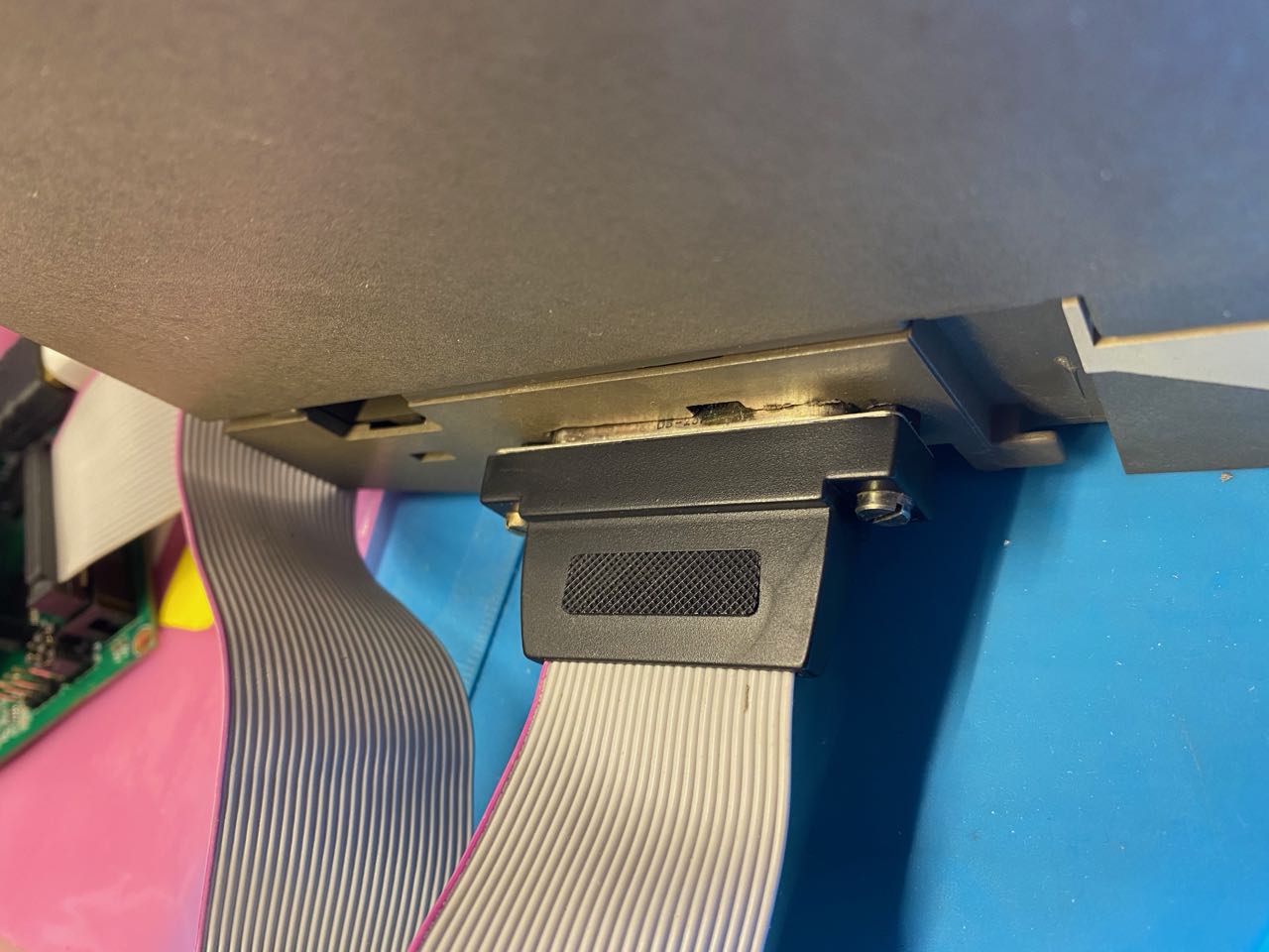

To facilitate installation I modified a bus module (6ES5 700-8MA11) by removing the bus decoder chip and installing a DB25 connector:
The modified bus module contains the following circuit
IO0-7 to the left edge connector pins
IO8-15 to the right edge connector pins
+5V and 0V to L+R edge connector pins
