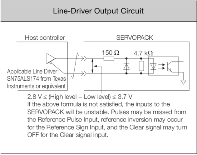

the servopack shout accept the 5V as it is standard the SN is only for controls that work on 24V signaling
please give the correct yaskawa drive number to confirm the input
- Posts: 18091
- Thank you received: 5323
14 Apr 2020 12:45 - 14 Apr 2020 12:58 #163942
Replied by PCW on topic Mesa StepGen ouputs with Yaskawa servos
With the input circuitry shown, the Opto LED current will be roughly 12 to 18 mA.
adding a ~120 ohm series resistor will get you in the middle of that range with 5V drive.
(and 75 to 180 ohms should work)

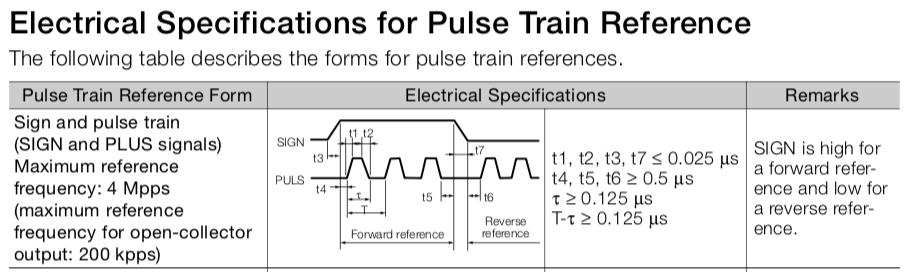

18 Nov 2021 15:02 #226876
by johnbl
Replied by johnbl on topic Mesa StepGen ouputs with Yaskawa servos
So I've been finally able to connect my Yaskawa servos to my 7i85s but I'm getting mixed results: it seems like the pulse train is not reliable and sometimes the servo drive does not recognize the pulses.
After taking a closer look at the 7i85s and assuming I can read correctly the datasheet of the ISL32174E used as differential driver, the diff. output voltage is not 5V but more like 4V. Not a huge issue, with a 120R series resistor there should still be about 10mA flowing through the opto-LED.
However I also noticed that the step/dir outputs from the fpga are terminated with a Thevenin termination (220R pullup to 3.3V and 470R pulldown to ground), which brings the voltage down to about 2.3V.
As per the ISL3217 datasheet, this is below the minimum 2.7V required for a logic HIGH.
Could this be the issue or am I wide of the mark?
- Posts: 18091
18 Nov 2021 15:28 #226879
The open circuit voltage of the terminator will be close to 2.3V but driven high ,
it will be closer to 2.7 or 2.8V (and about .4V when driven low) I don't think this is an
issue. What step length are you using? I would always start with at least 2X the drives
minimum step length value.

- Posts: 18091
18 Nov 2021 15:58 - 18 Nov 2021 16:03 #226884
2.8V is a legal high (the actual input thresholds are about 1.7V)
Its also about the best you can do into termination with 3.3V drive.
Note that the minimum VIH and VIL specifications are not the
input threshold values but the minimum high and low levels to
guarantee sufficient noise margin (typically 1.0V for TTL interface
levels like these)
As an experiment, you can get a bit higher drive by setting the
FPGA card I/O to 3.3V tolerant mode which reduces the output
resistance, but this is not the issue, its something else.
levels like these)
Last edit: 18 Nov 2021 16:03 by PCW.
