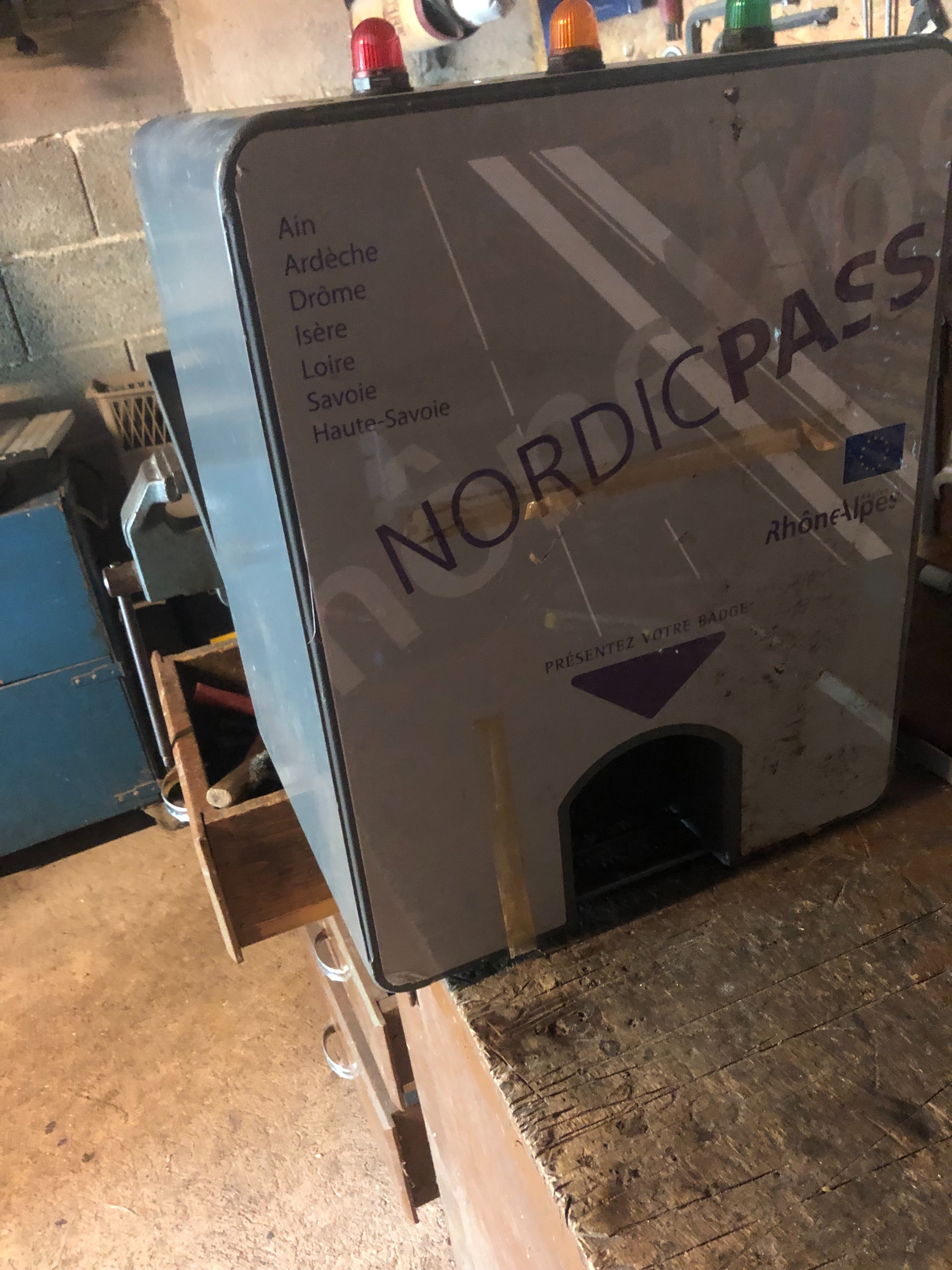

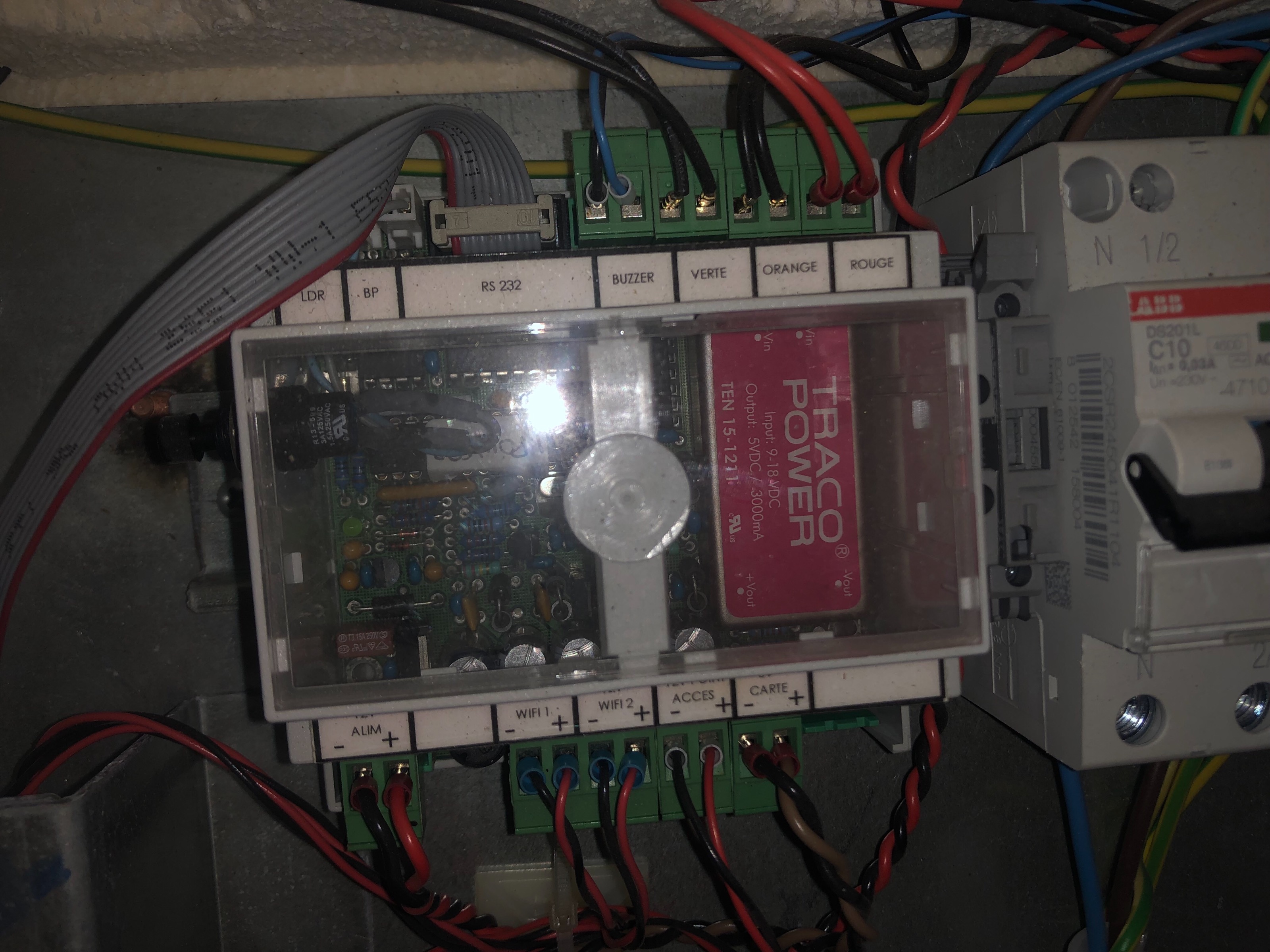

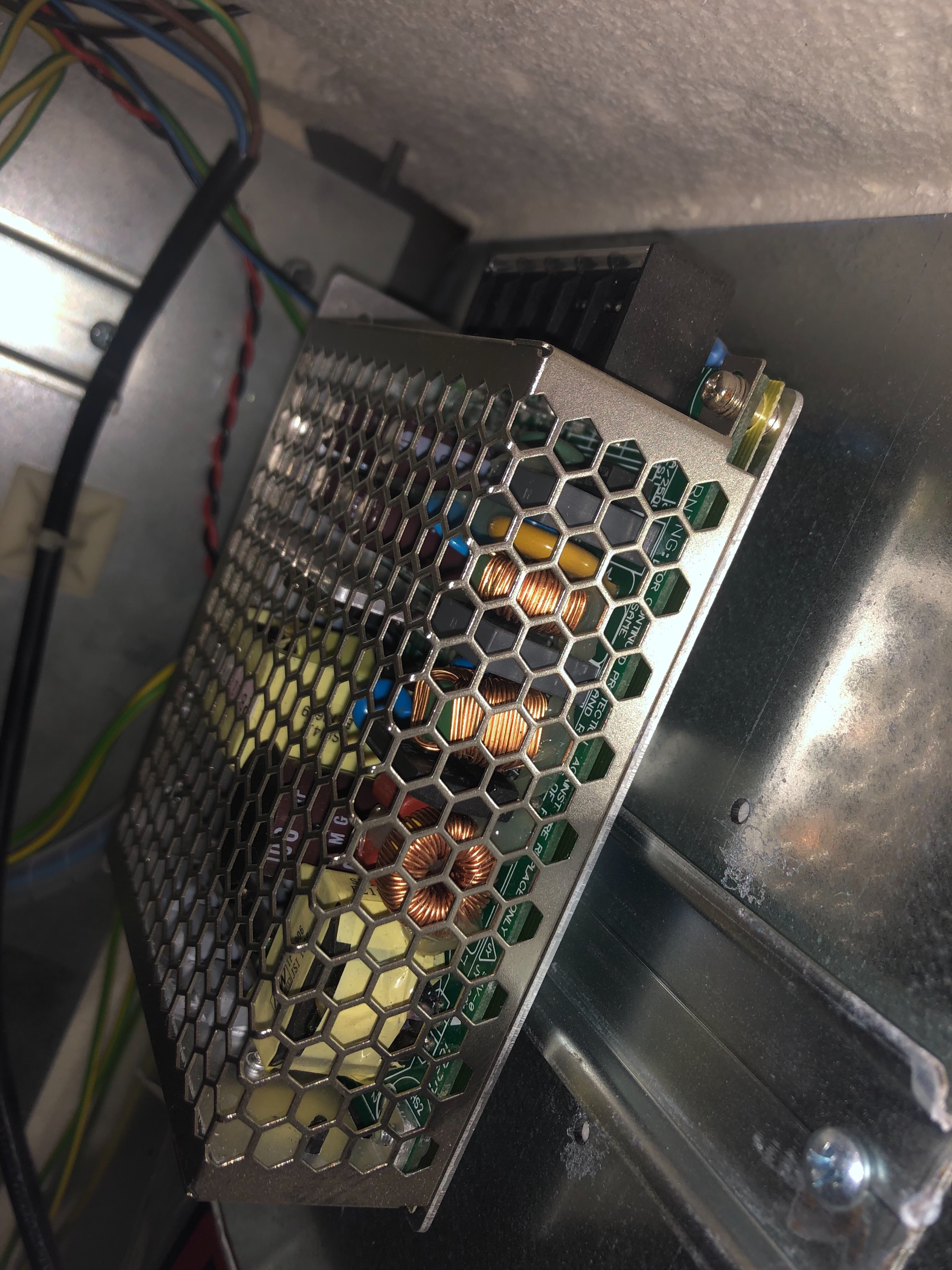

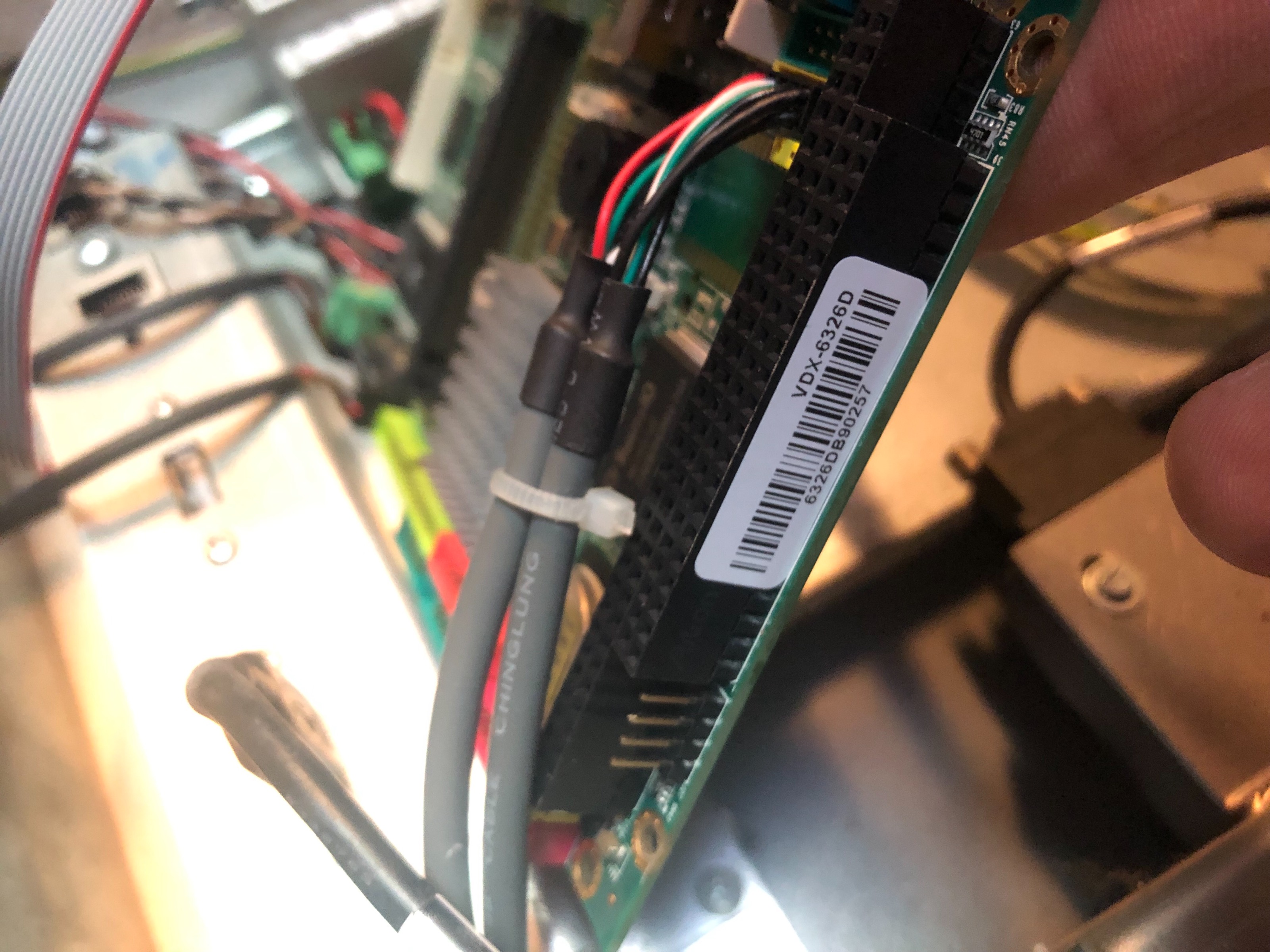

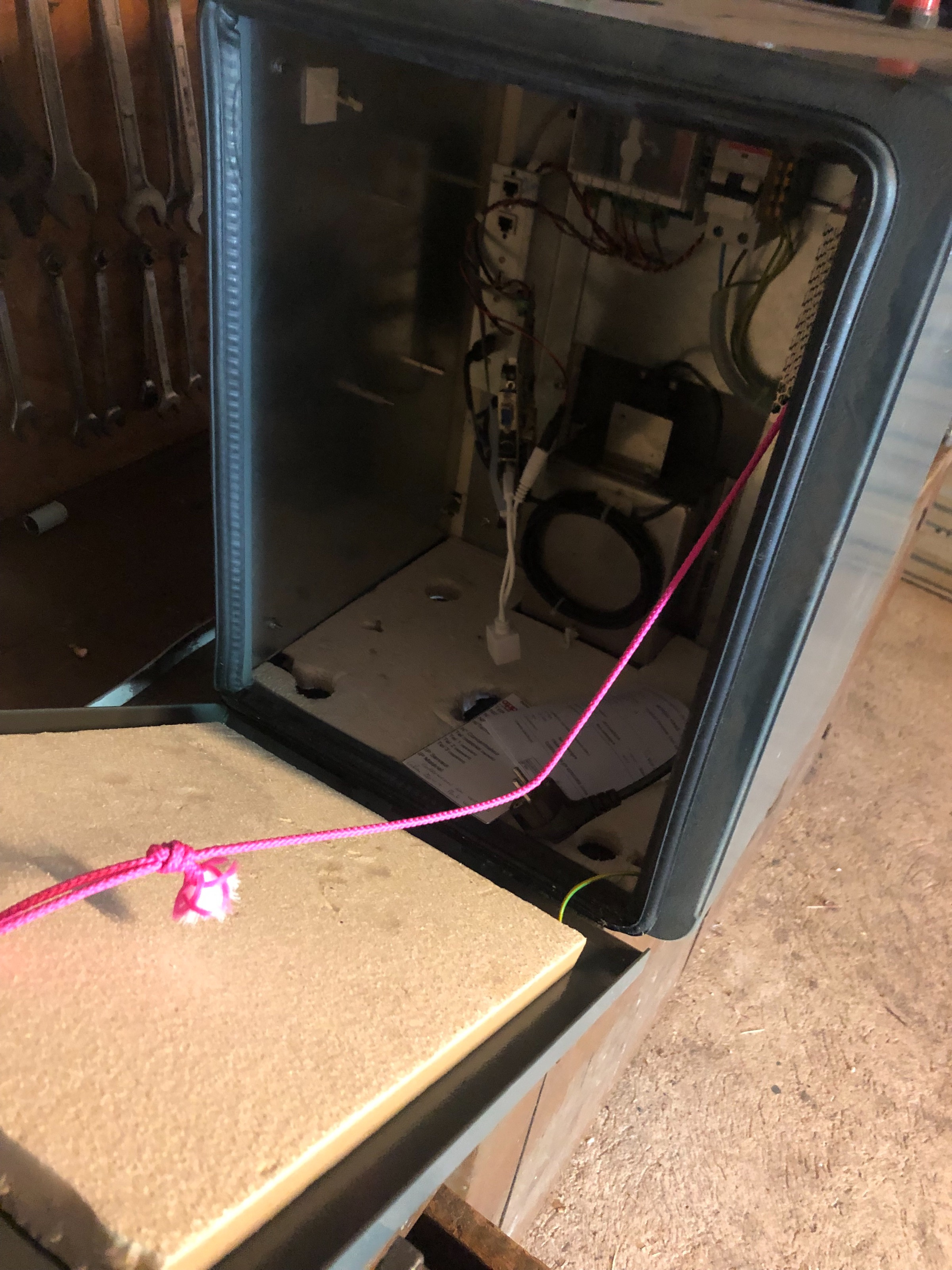

Today searching a box for all the electronic a friend gift me a ski pass box
With some material inside
a SMPS 12v MEANWELL
a mini computer VDX-6326D with 2Gb compact flash
a strange modul that seem to be a 12v to 3x12v + 5v converter + manage 3 LED and have RS232 connection
Funny
a SMPS 12v MEANWELL
Funny
