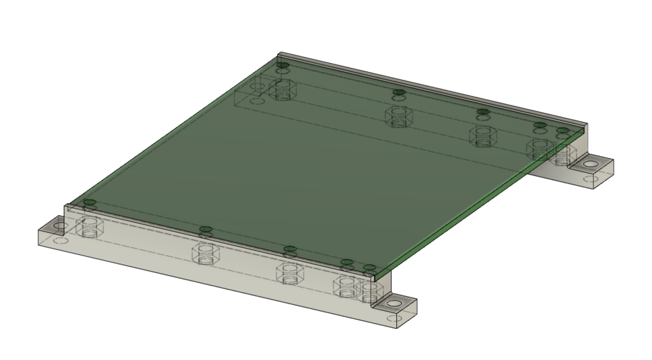

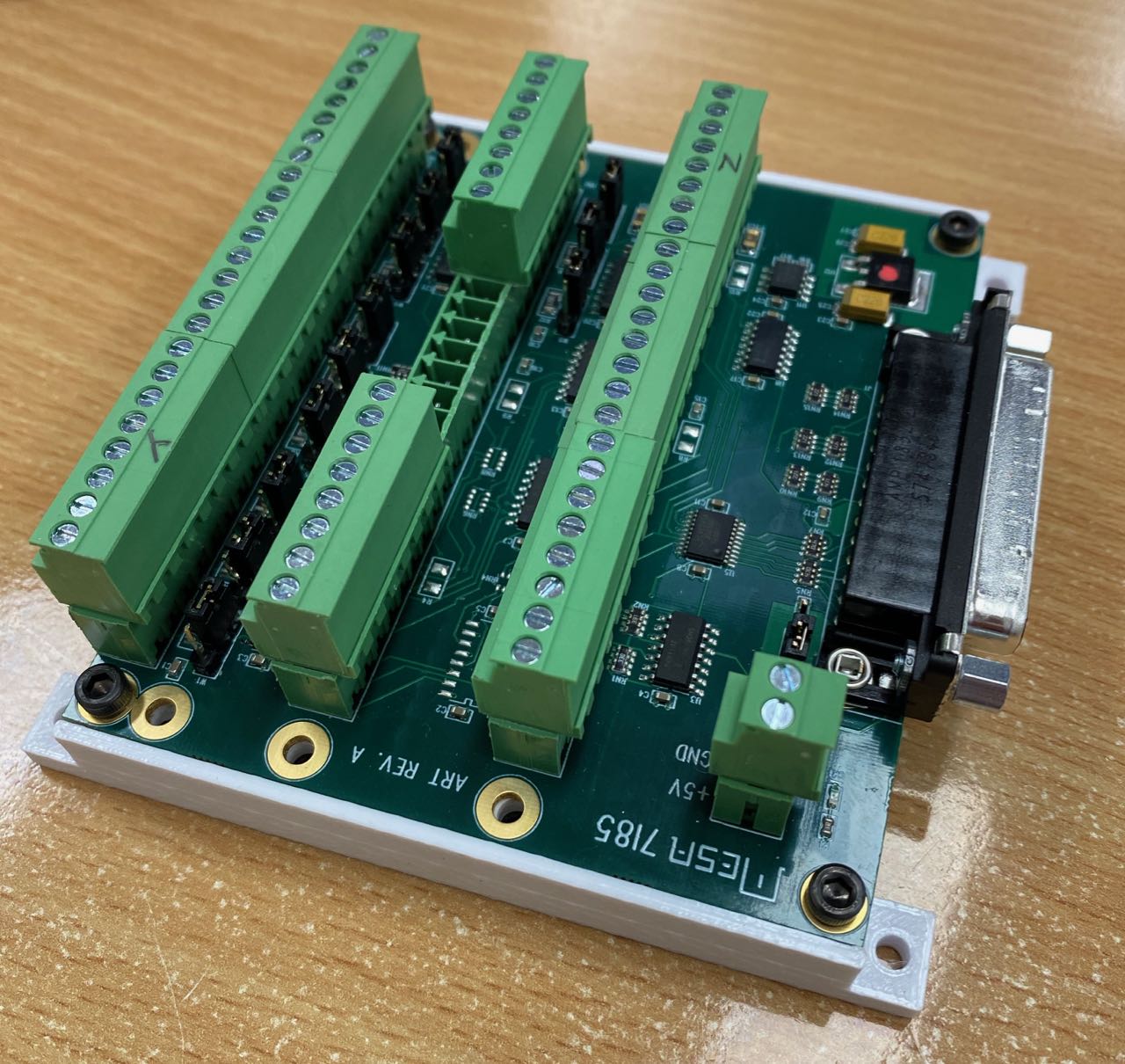

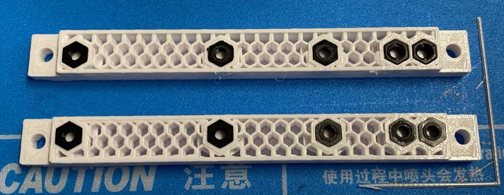

Safely mounting my 7i85S in an enclosure (on gear tray) made me think about the various options, so here I'm sharing my solution in the hope that it might be useful to someone else:
Two 3D-printed mounting blocks with M3 nuts inserted at 6.5mm print height:
Final product:
You can download the STL and Fusion 360 files here:
www.thingiverse.com/thing:4306765
Final product:
